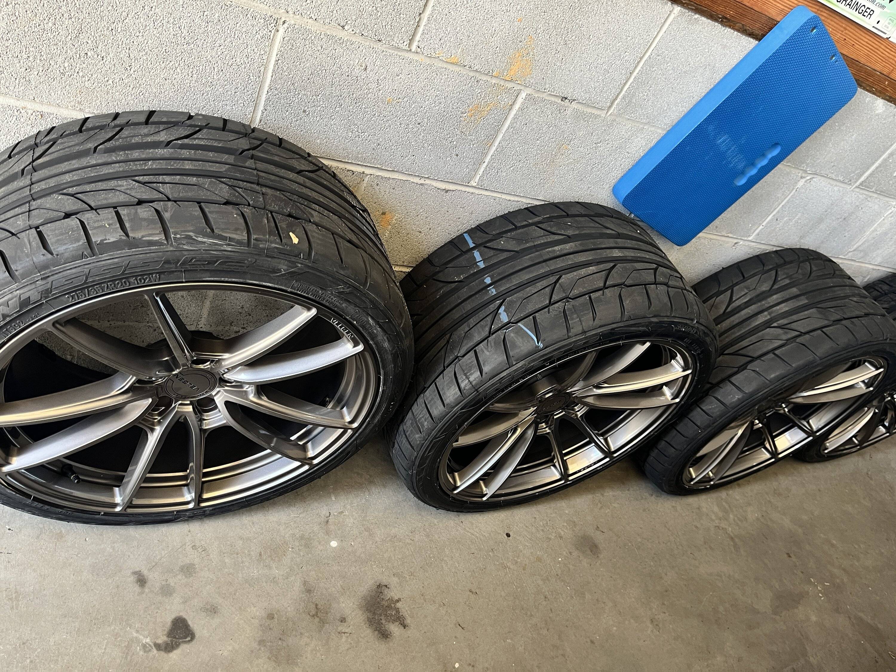

skinnyb
Jun 25, 2022
3,655
9,254
Knoxville TN
Alex
21 Mach 1. FJG, Tremec
I agree on fatter wheels and tires. I got these bad boys delivered today. Much wider than factory for me :).
