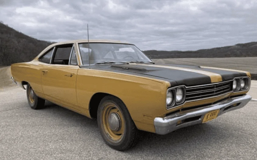

Always start with suspension and brakes. The go fast stuff is not worth it unless the car can handle the power. I would also use part of the money for a driver mod and take a class or two. I did that in the past and learned so much. Regardless, I always make sure the car can handle the power before I give it to her.
PSST, I know plenty of guys from the 70's that didn't concern themselves with stopping LOL for example...
