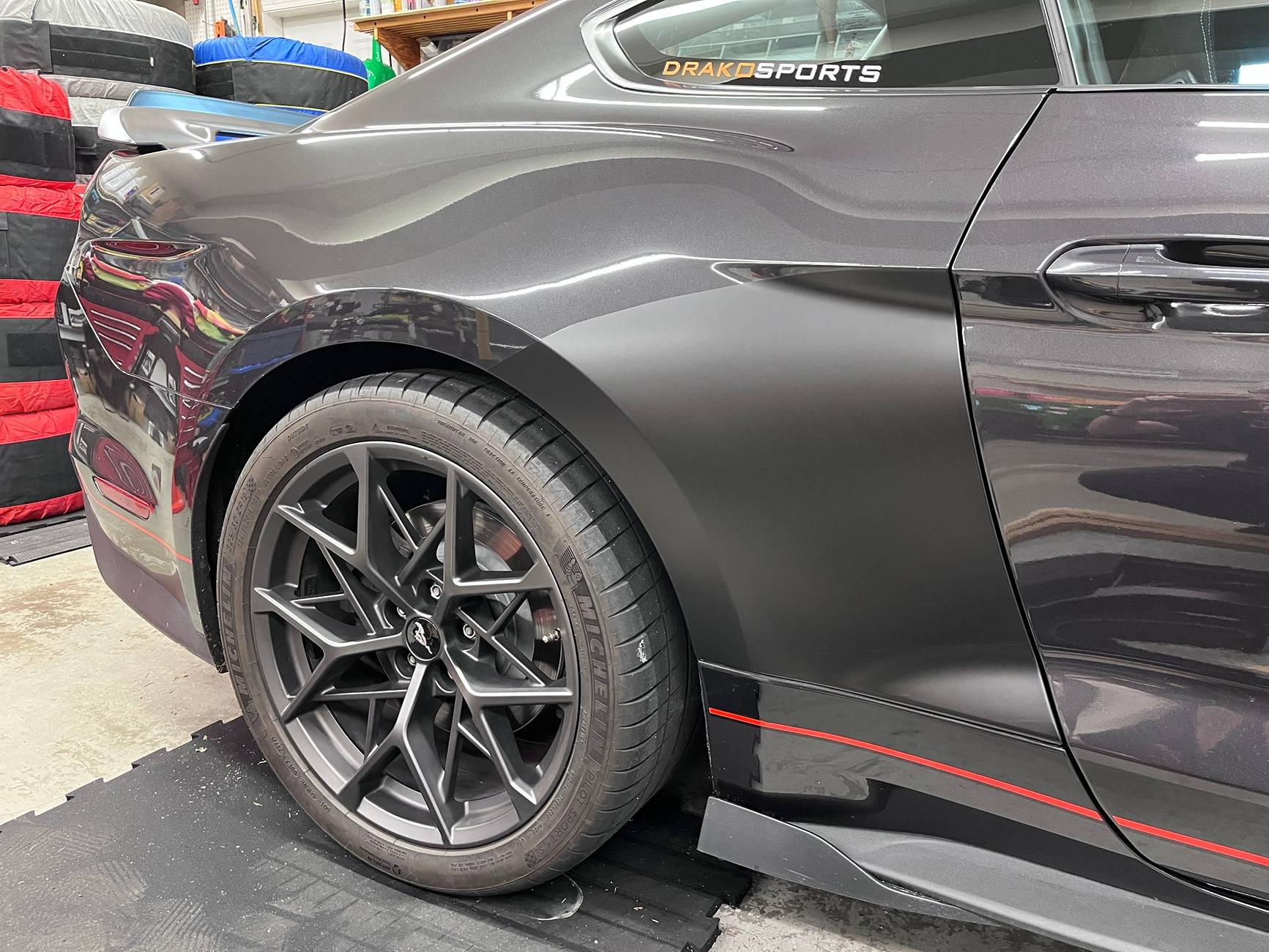

Concerning the paint damage, I put the track package PPF (Paint Protection Film) on. Later on, I wish I had done the rear panel section as in the photo, this panel got marked quite a bit. I installed the PPF with black car wrap. I do have the fender flares on.
