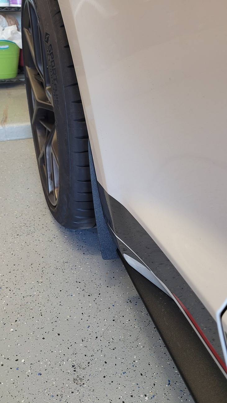

Update: I'm going to Chuckwalla in March. 👍🏻
One thing I'm worried about though. I have Steeda Sport springs and I removed the fender flares so I could run a 35 profile tire without rubbing. I actually prefer the look too. But I got to thinking that when I put the PS4s back on the tires will poke out farther without protection. I'm worried about kicking up road debris and damaging the paint.
I have some low profile rock flaps on now, but those will probably only provide minimal protection. I could put the flares back on but I'm fairly certain they will rub in hard cornering.
Can anyone speak to tracking the car without the flares on and if it will chew up the lip of the wheel wells?
