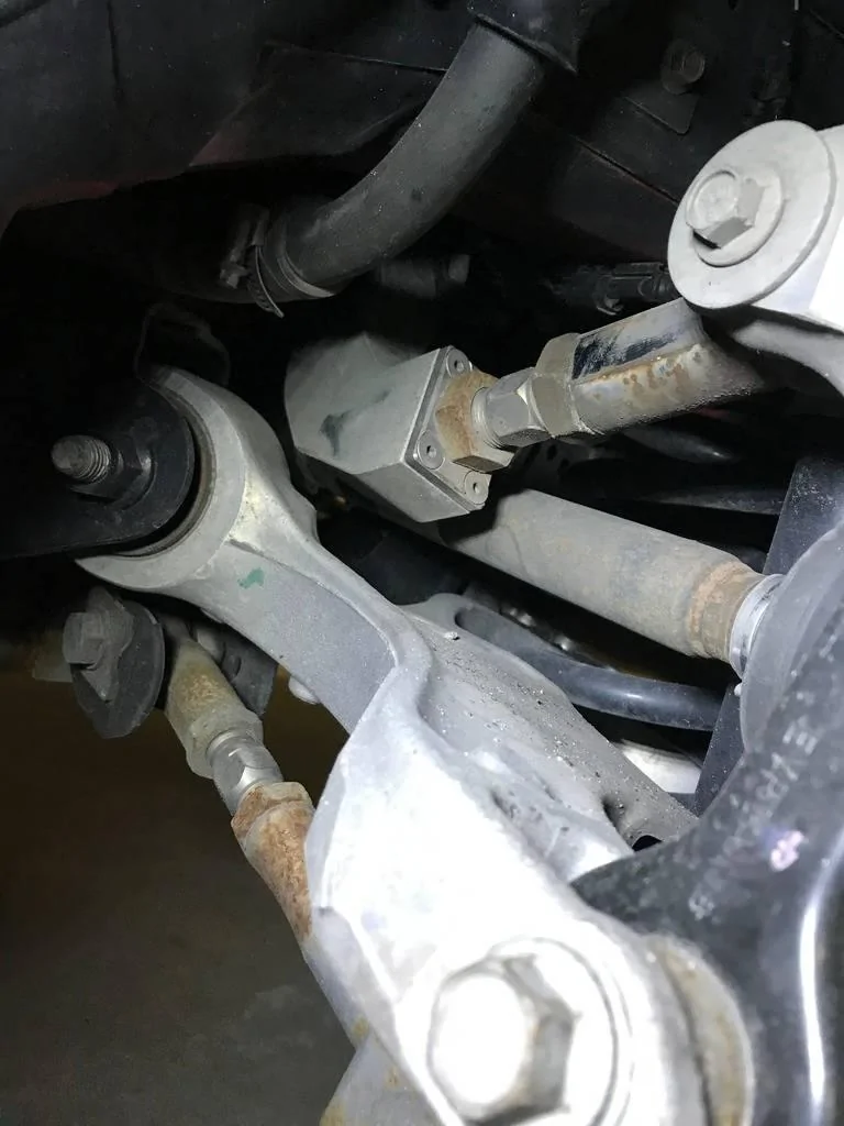

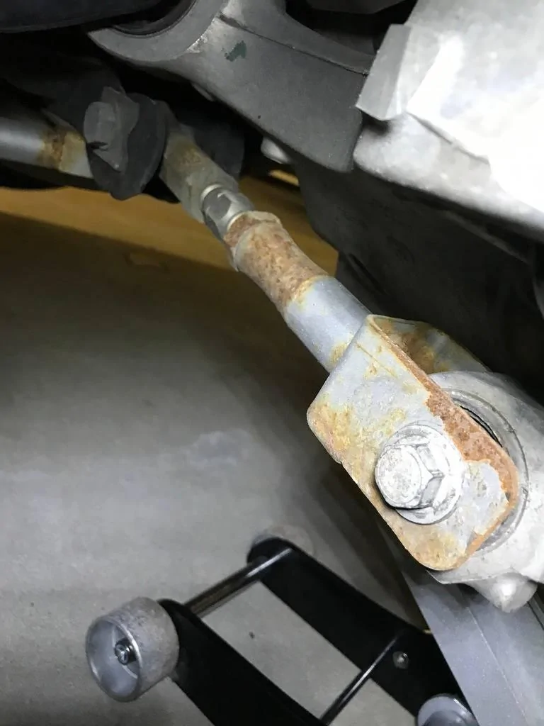

I had the same kind of very loud annoying sound coming from the driver side rear suspension. Turns out the Steeda Camber arm inner delrin bushing was covered in some black goo that I guess used to be grease... That made the arm very difficult to move... Cleaned it up and put it back with some fresh grease. Absolutely no sounds/noise now. But I have to say the steeda parts are definitely not made for winter. After one single winter it all looks like cr@p and the "powder-coat" is just flaking away...
Me too. I will post some pictures as well. Ive driven my car through both winters and daily so it looks quite similar to yours. I was quite surprised but hey that's the reality of it. If everything was forged and stainless or billet I can only imagine the prices. I got tired of owning an M3 because of that :lol:

In the photo above your post its the arm with the adjustment in the middle and the thick billet squared piece with the 4 screws in it visible.

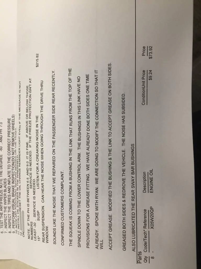

I think they got it nicked this time :knock on wood:
It was a bushing in the rear suspension that was causing the noise. They noted that it did not have a grease fitting so they did a slight modification to allow the grease to penetrate it and that apparently got rid of the noise. I asked if it was the toe-knuckle bearing and he said no. I asked if it was the camber arm and he said no. He does not know what name that Ford uses for it.
He said that this should be a permanent solution, given that we lubricate it every so often.
I've uploaded the explanation from my bill for anyone else to see.
