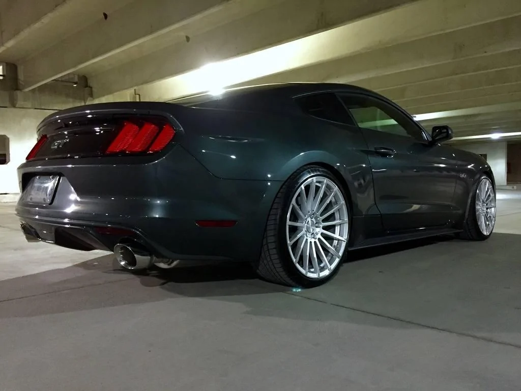

Love your wheels, what are the size of wheels and tyres, plus what colour finish is that, looks amazing. :)
Thanks ! more pics and info in my sig link to my build thread :thumbsup: They are Ace Alloys Devoton rims 9/10.5 tires are 245/35 and 285/30. This is my winter setup ;) My forged 3 pc wheels are currently being made :D
