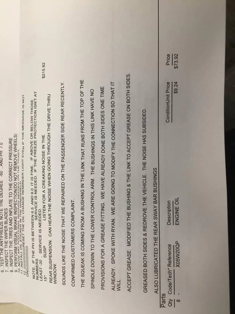

fwiw I resolved my squeaking issue, I bit the bullet and just greased the delrin bushings like a madman with some purple shit from advanced ( high temp rtv ?? ).
there was definitely some sort of friction/rubbing going on because once I removed the lower part of the link I saw the markings from the mounting points.
