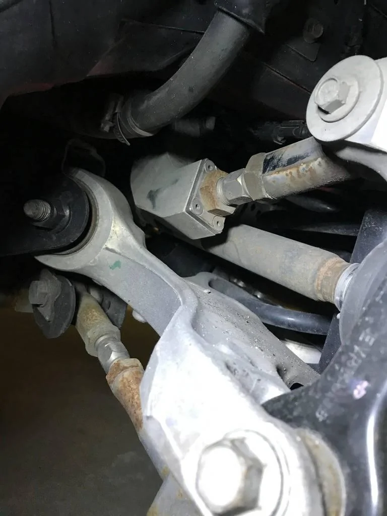

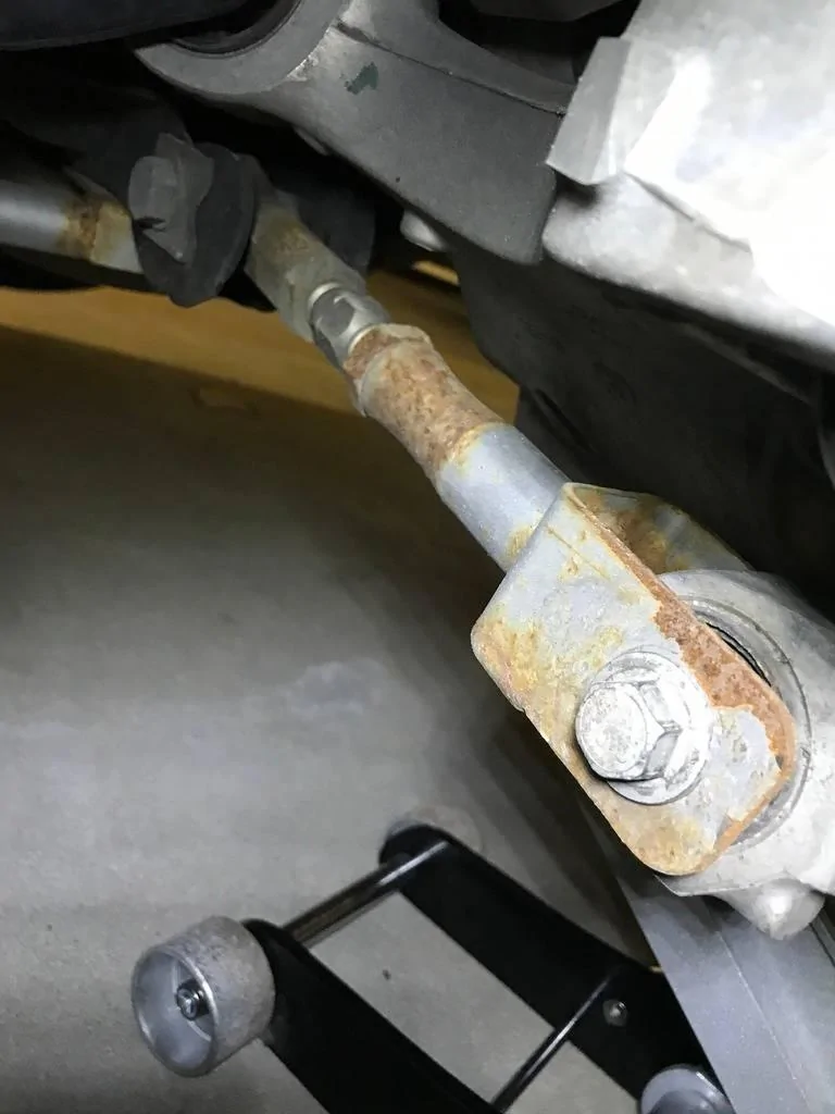

I am having that exact noise coming from the rear of the car. I have Steeda Liner Ultralite Springs, SR Vertical Links, and the Cradle Lockout Kit from BMR. I just ordered the Steeda Billet Shock Mounts, and that should at least help us eliminate one factor.
Daidalos
Jul 28, 2016
65
Toronto, Canada
FORD MUSTANG GT 2016
