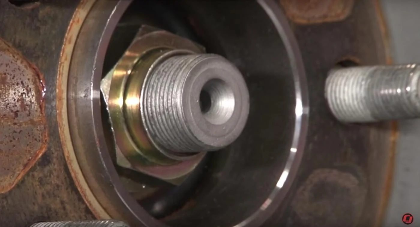

Popping, squeaking, wheels wobbling, vibrations and many other symptoms can occur when the rear axle to spindle/knuckle retaining nuts lose their clamping force.
I am seeing this almost on a weekly basis at this point, both with stock and aftermarket set-ups.
I have found that installing a new nut and torquing them to 150ftlbs + 1/8 turn with Red Loctite has been the best for myself and our project cars.
I recommend marking the nut to the shaft so you can inspect them occasionally to ensure the nut does not back-off of the threads.

Dealer just replaced my half shaft nuts and my creek/squeek under accel or decc is now gone. For how long, is anybody's guess, LOL.

Had a clicking sound at low speeds ~10-15mph and the rear axle nuts weren't torqued properly.

Just ordered some new fastners. Thanks for the tip. I put new halfshafts in last year and reused the stock hardware. Did not put many miles on the car before winter, so hopefully I have avoided some drama.

Why use red and not blue? Wont red make it near impossible to remove?

Wow!!! Mine makes a creek/slight pop noise.m.i know its coming from the axle....but never thought this would be tge cause. Mine really only does it after i back up, and then start letting the clutch out to pull fwd....wow, checking the tq when i get home!!
Red because it's got a higher temp rating and on a nut that big it wont be tough to get it off if needed.

So I replaced the LR hub on mine last night and the factory nut was fairly easy to remove. Had some weird popping when turning left and starting to roll out from a stop. The hub/bearing didnt feel crunchy but there was grease all over my spindle and the bearing smelled like a burnt diff.

Ill be checking this prior to installing wheels next week. Im getting the 5mph clicking while turning. Whats the size of that spindle nut ny chance?

I had one loosen on my '04 cobra. It was noticeable the moment it happened. As soon as I accelerated it felt like I had a rear tire going down.

Kelly, what is the Ford part number? Thanks.

[MENTION=18561]bandit67[/MENTION] CCPZ-3B477-F is the hub nut part number
