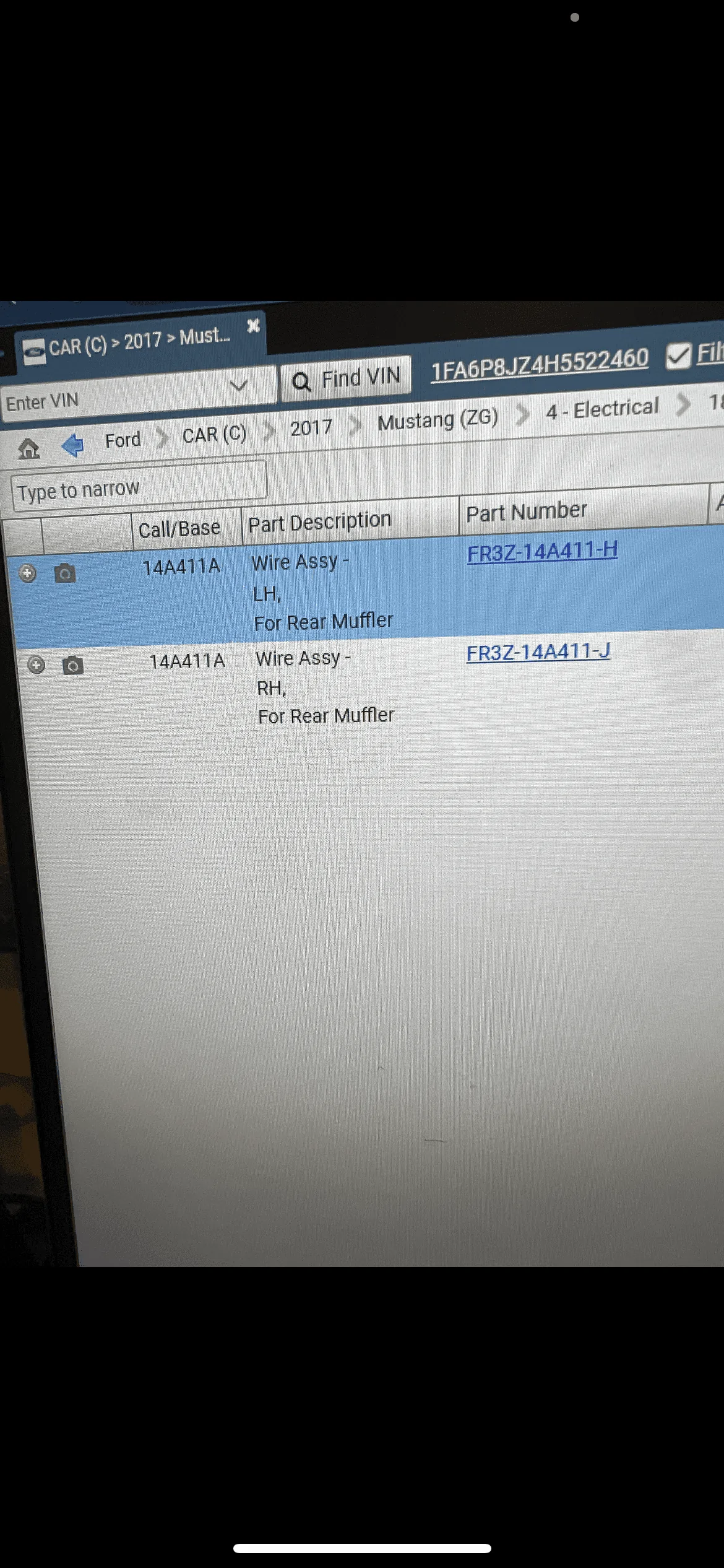

This. Check both sides, but it's usually the passenger side. Did you replace mids? Also, just take a look at your active exhaust fuse first since it's a PITA to climb under your car to find the harness.
is this the correct wire harness?
Rapid Red
Nov 4, 2019
5,049
4,096
Woodstock GA
Greg
My muffler valves have been acting up for awhile and now and would occasionally throw the “exhaust mode not available” and “drive mode not available” error messages. Usually this would go away after turning the car off and letting it sit for 5-10 minutes. This solution has stopped working for me and my mufflers has been stuck shut for 2 days with no access to drive mode either. Has anyone found a solution to this? I wanted to try these but not sure if the codes will go away as i will have to forcefully open both valves then install.
Wiring can and will cause the “exhaust mode not available” ,
But this is unusual "drive mode not available"
However I also speak as a 2020 owner, and your car is listed as 2017, so could be related.
