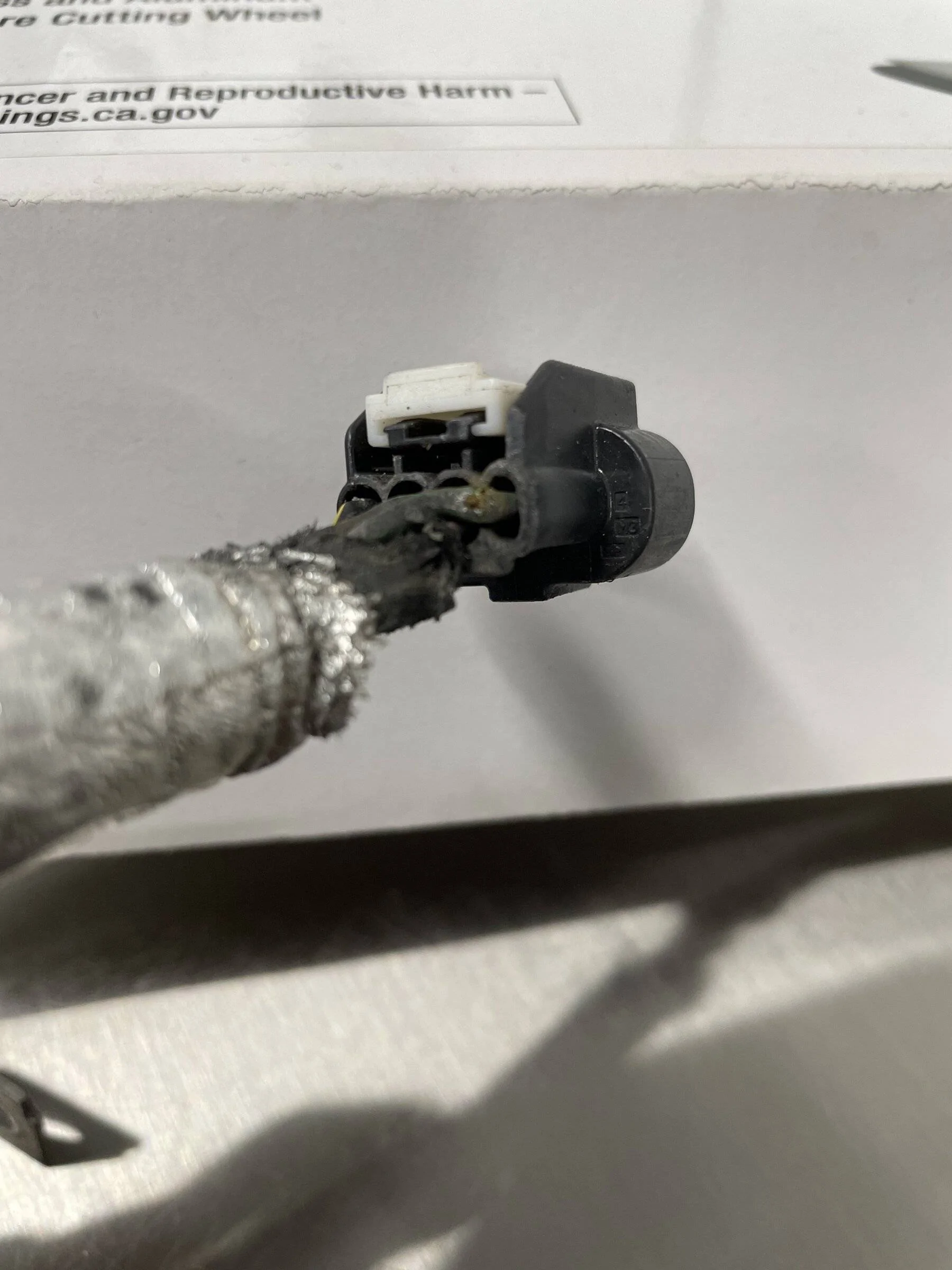

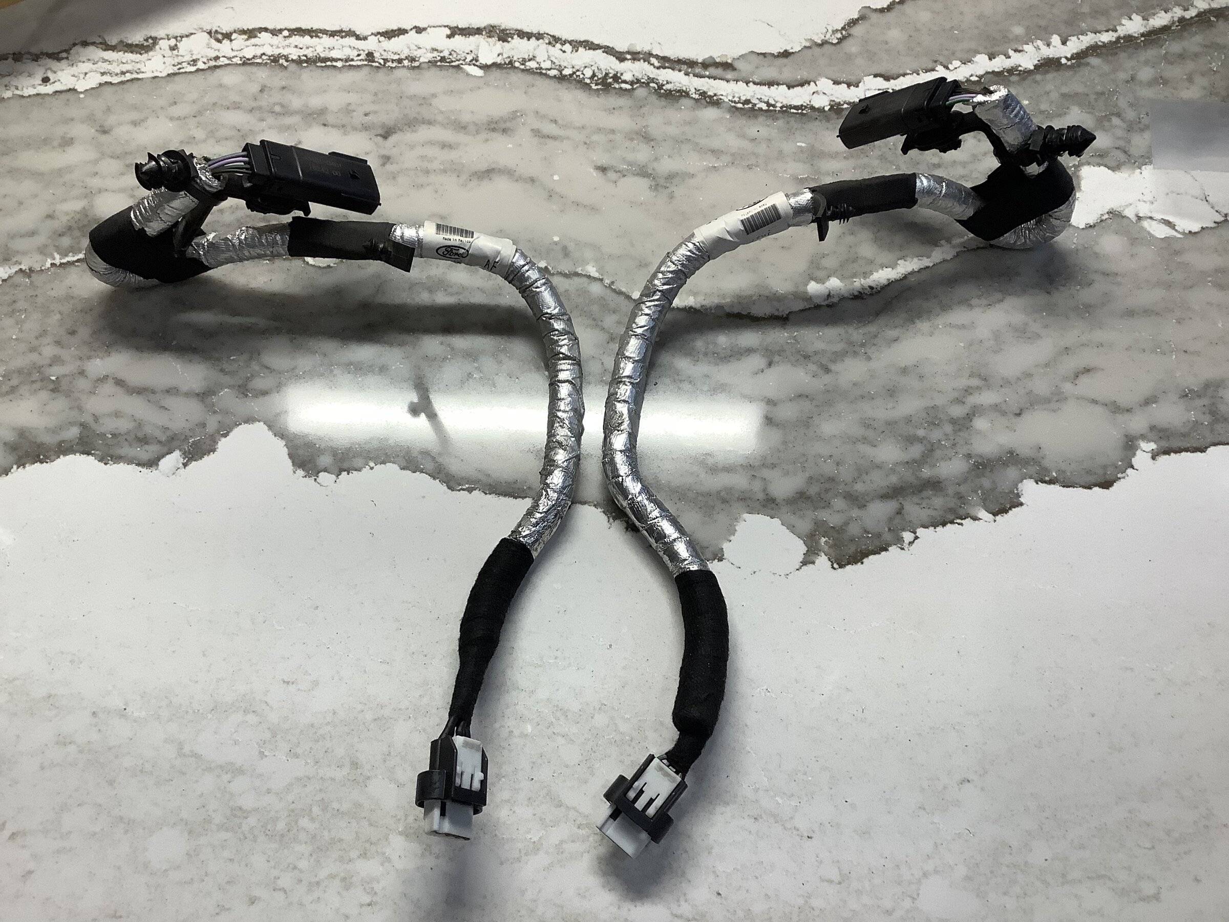

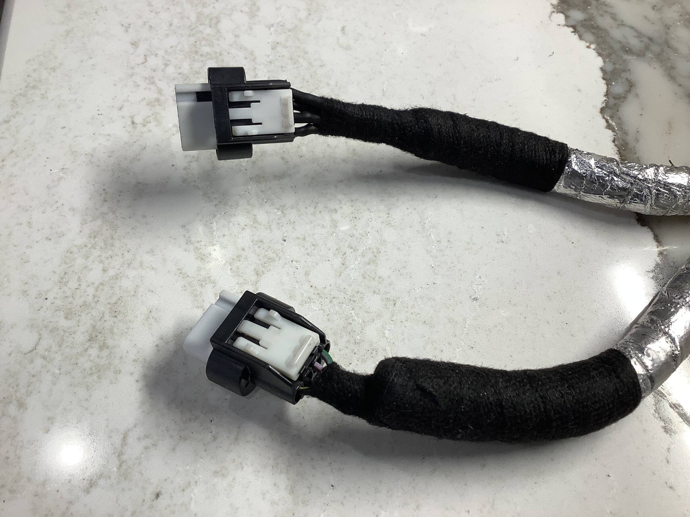

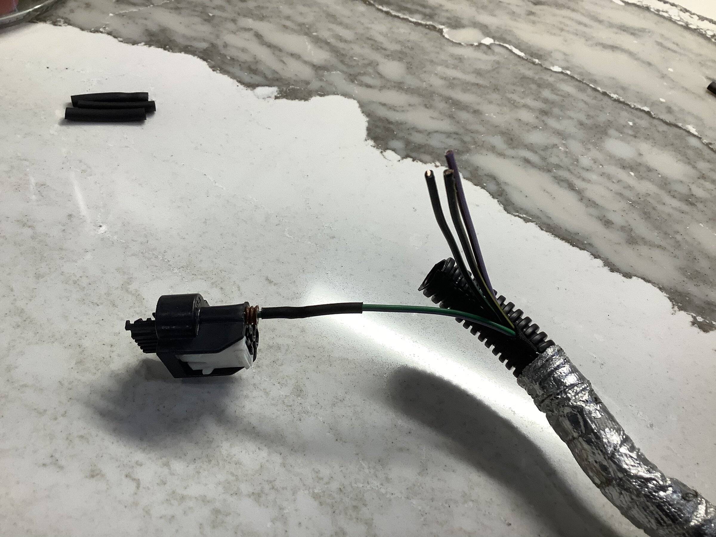

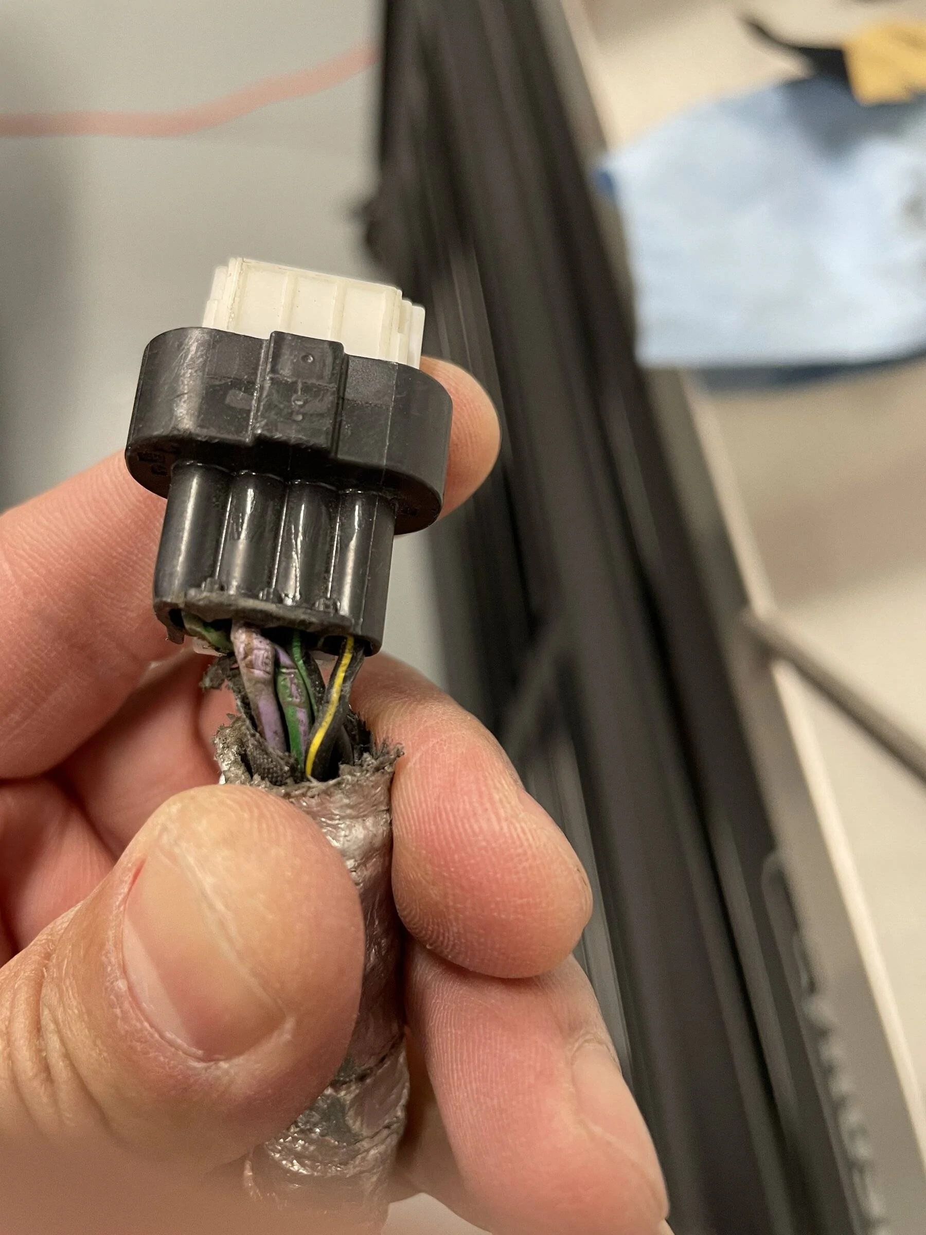

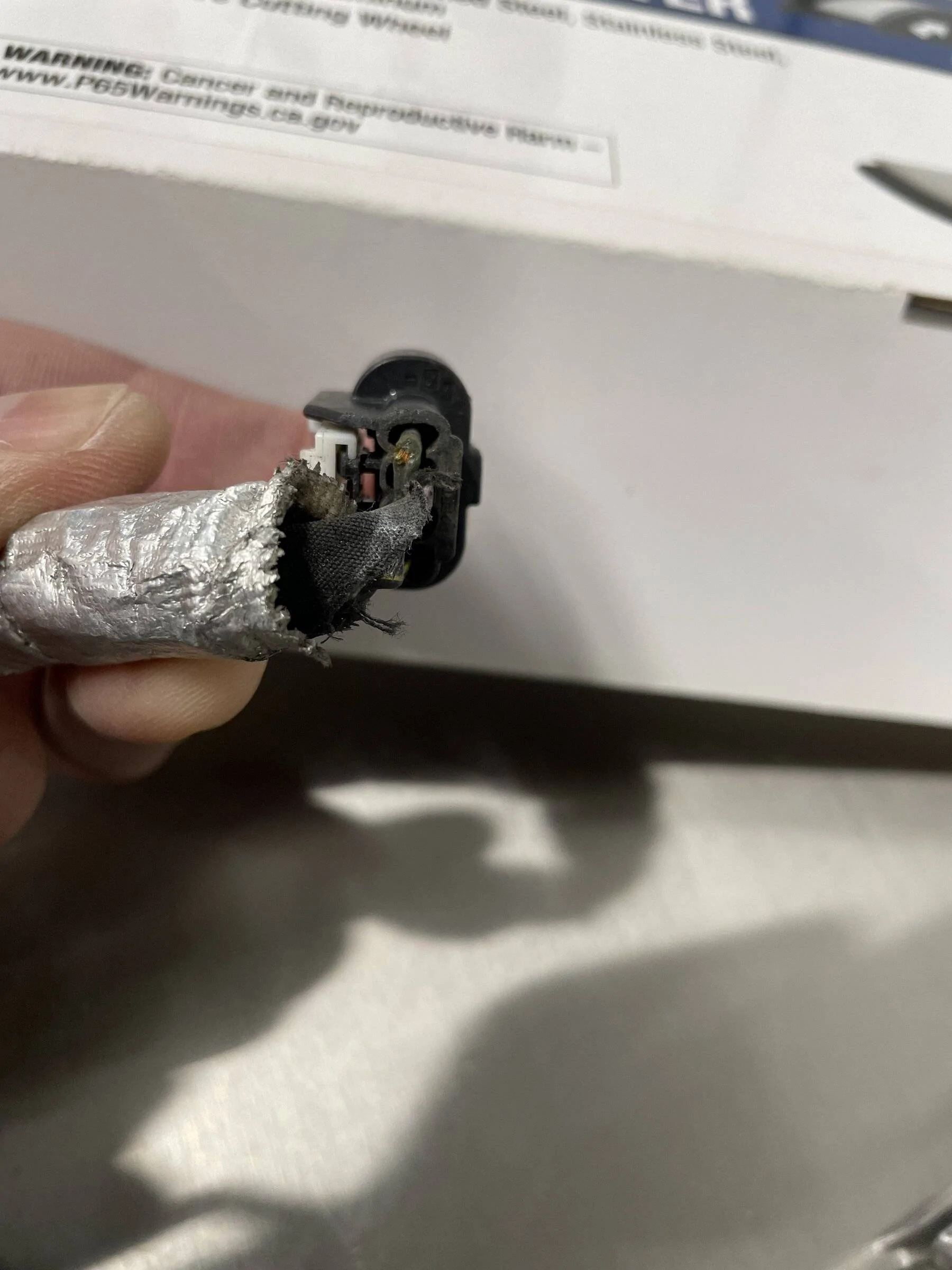

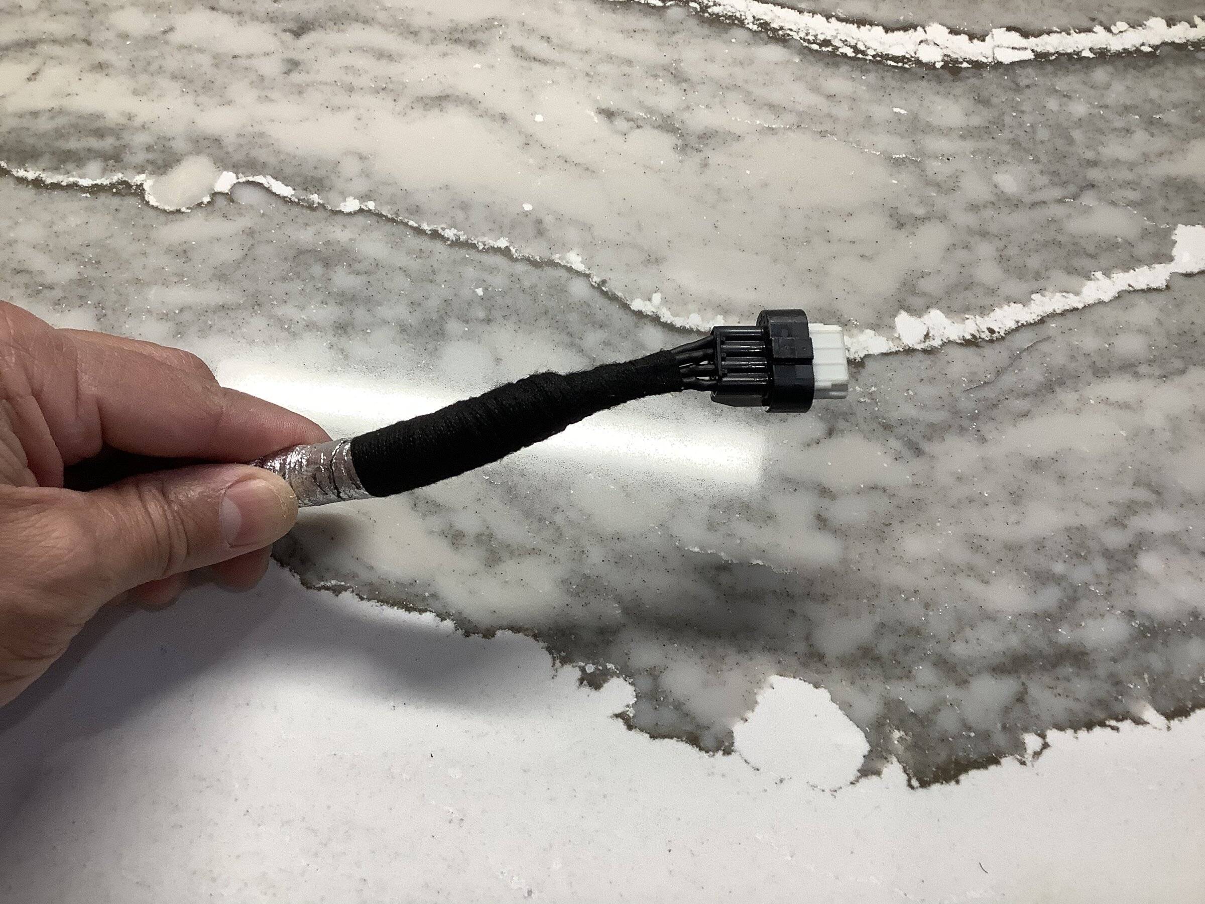

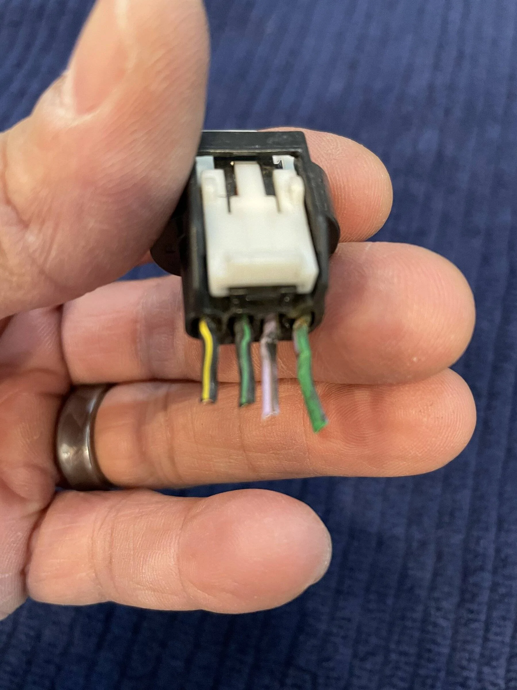

I realize that this is an old thread, but I believe the problem is still very prevalent on cars that have factory “Active Exhaust” systems. I‘ve personally experienced this issue on my 2019 Bullitt. After growing tired of seeing the Exhaust Mode Malfunction light on the dash, I decided to address it.
First, I attempted to order a right side replacement harness online, only to have the company that I had placed the order with, cancel the order due to unknown availability. It was at this point that I decided to see if I could repair mine. Here’s how I went about it:
1. Cut back 2 1/2” of the aluminum heat shield insulation, as well as the split wire loom that was underneath.
2. De-pinned the connector, cut the four wires, stripped, soldered and applied heat shrink to each wire. Note: In order to de-pin the connector, you must remove the white male portion of the connector by prying up on it with a small screwdriver, followed by gently prying up the locking tongues that hold each pinned wire in place, while pulling the wire out the back of the connector.
3. Wrapped a portion of the harness with Tesa Tape to give a super clean look. Note: I also wrapped the left harness with Tessa Tape, so that it would closely match the right side harness.

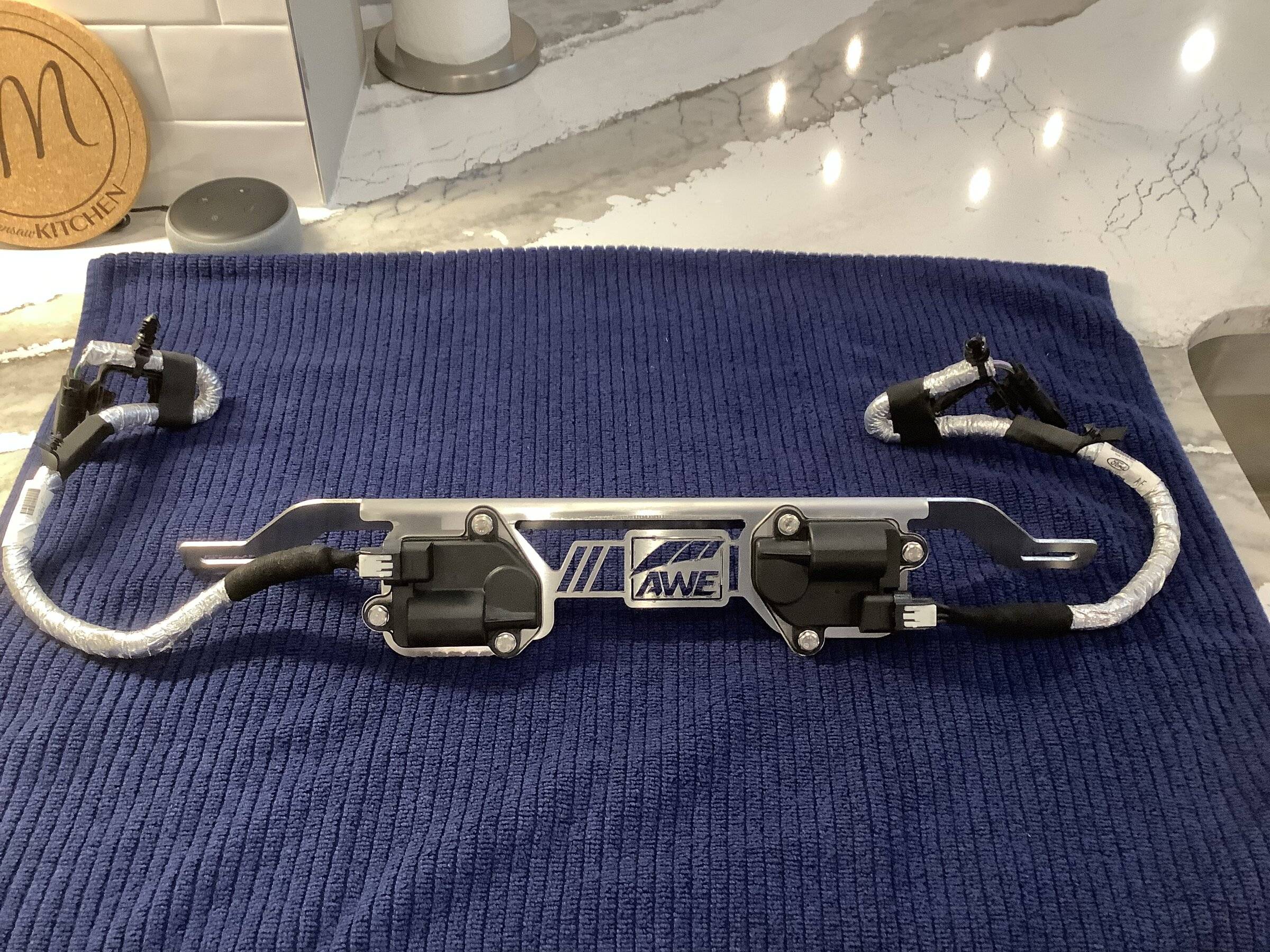

The photos depict the damage caused to the right AE wiring harness, as a result of chafing on the frame of the car. I don’t think I’ll ever have this problem again moving forward, because I am relocating the AE actuators to an AWE bracket. I will still connect the actuators to their respective harnesses to avoid the Exhaust Mode Malfunction light on the dash. Hopefully this repair method will be an option to others, who are dealing with this issue
The photos depict the damage caused to the right AE wiring harness, as a result of chaffing on the frame of the car. I don’t think I’ll ever have this problem again moving forward, because I am relocating the AE actuators to an AWE bracket. I will still connect the actuators to their respective harnesses to avoid the Exhaust Mode Malfunction light on the dash. Hopefully this repair method will be an option to others, who are dealing with this issue
Nice breakdown and photos. Question, are those the factory AW actuators on an aftermarket bracket? Did you happen to photograph the final install? This looks like a nice preventative maintenance mod.
Thank you. Yes, those are the factory actuators on the aftermarket bracket. I haven’t installed it yet, but I will do so tomorrow and post pics back here.
