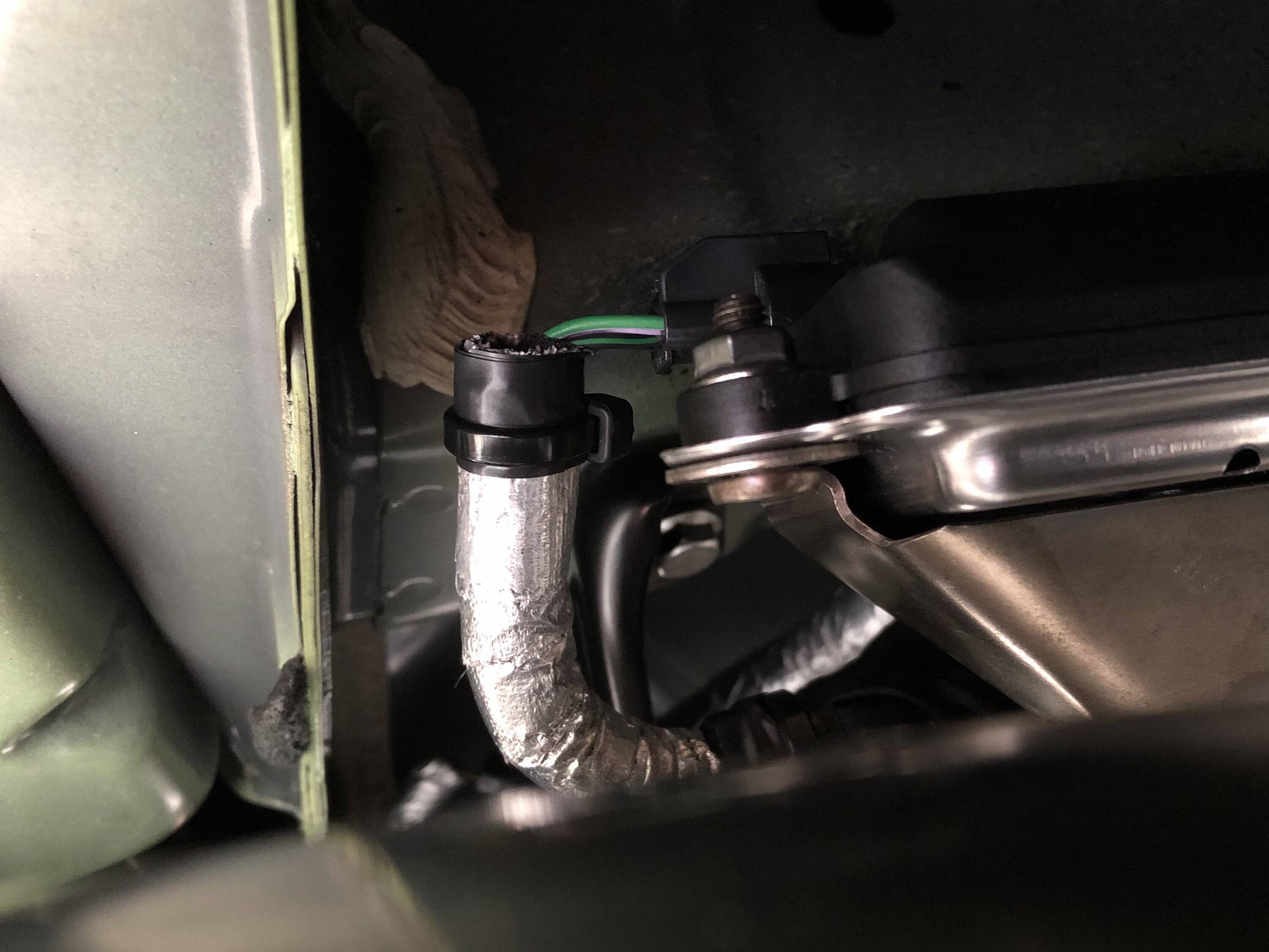

Have you checked the passenger side Active Exhaust harness to see if it has chafing on it? If so, a new harness or repair may be needed.
Hey, I have replaced both AE wire harness and both sides did indeed have burn damage from moving to close. But after both have been replaced with brand new OEM ones it still isn’t working. Do you have another solution i should try. Maybe cleaning out the muffler tips?
