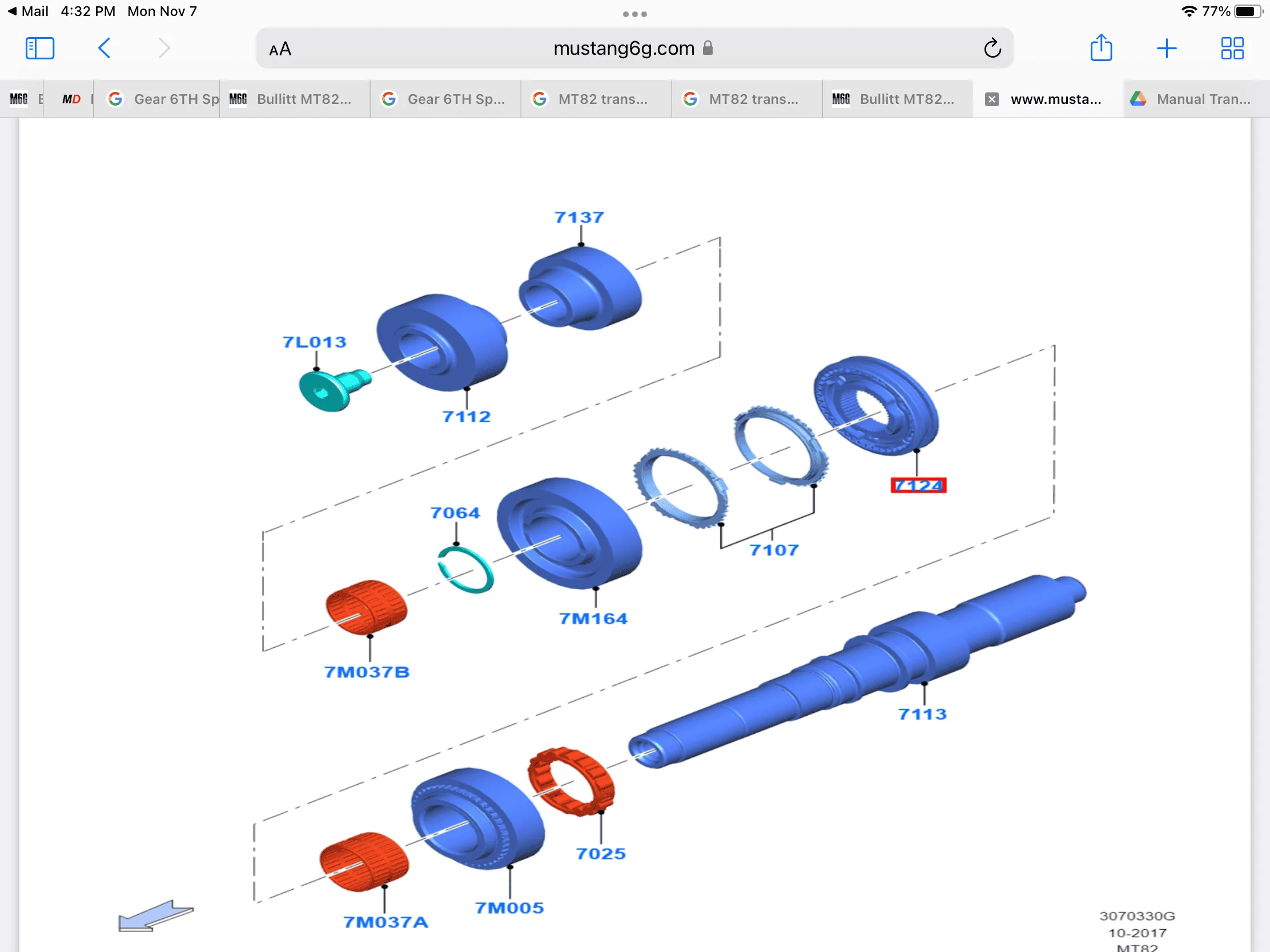

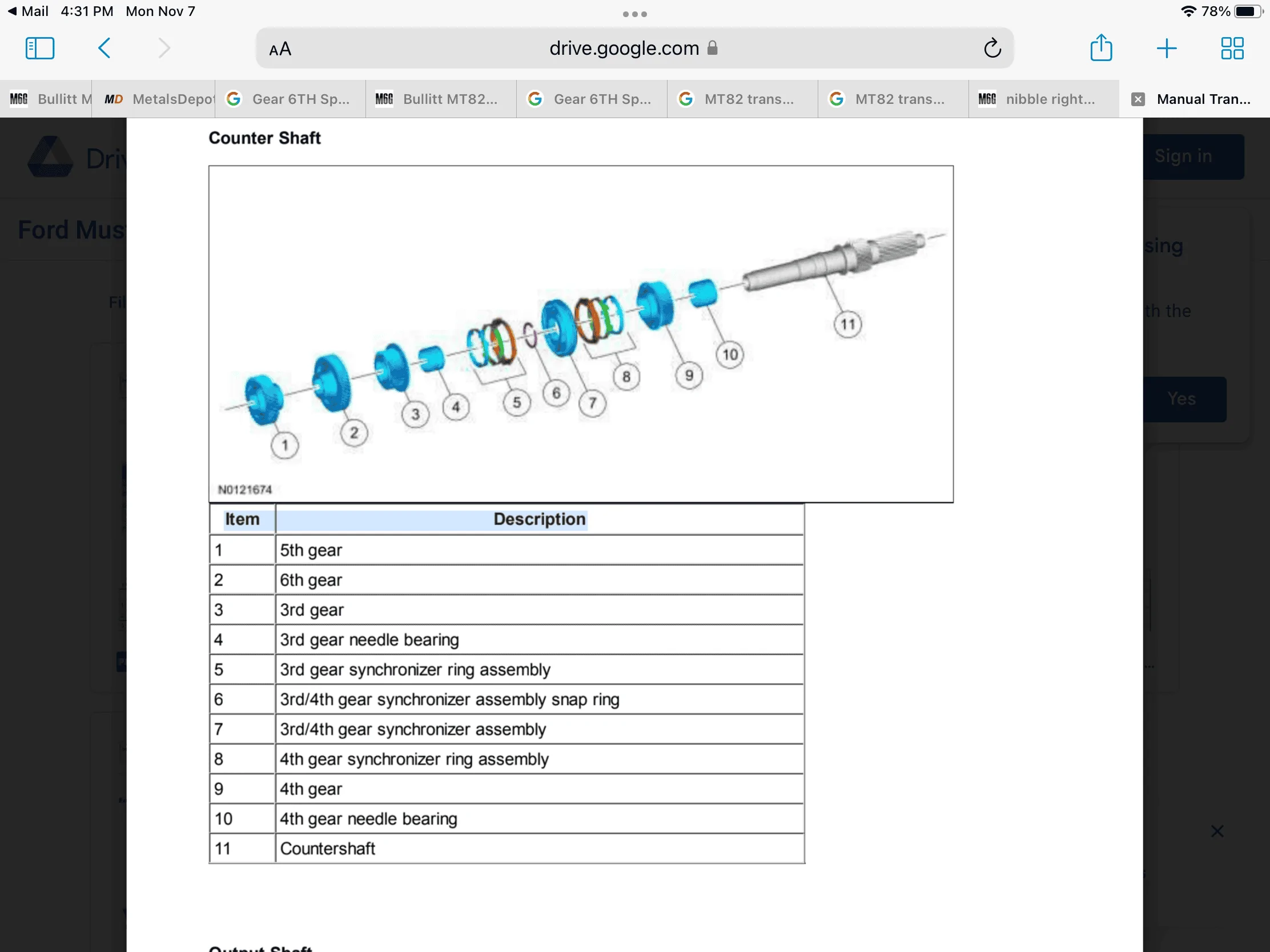

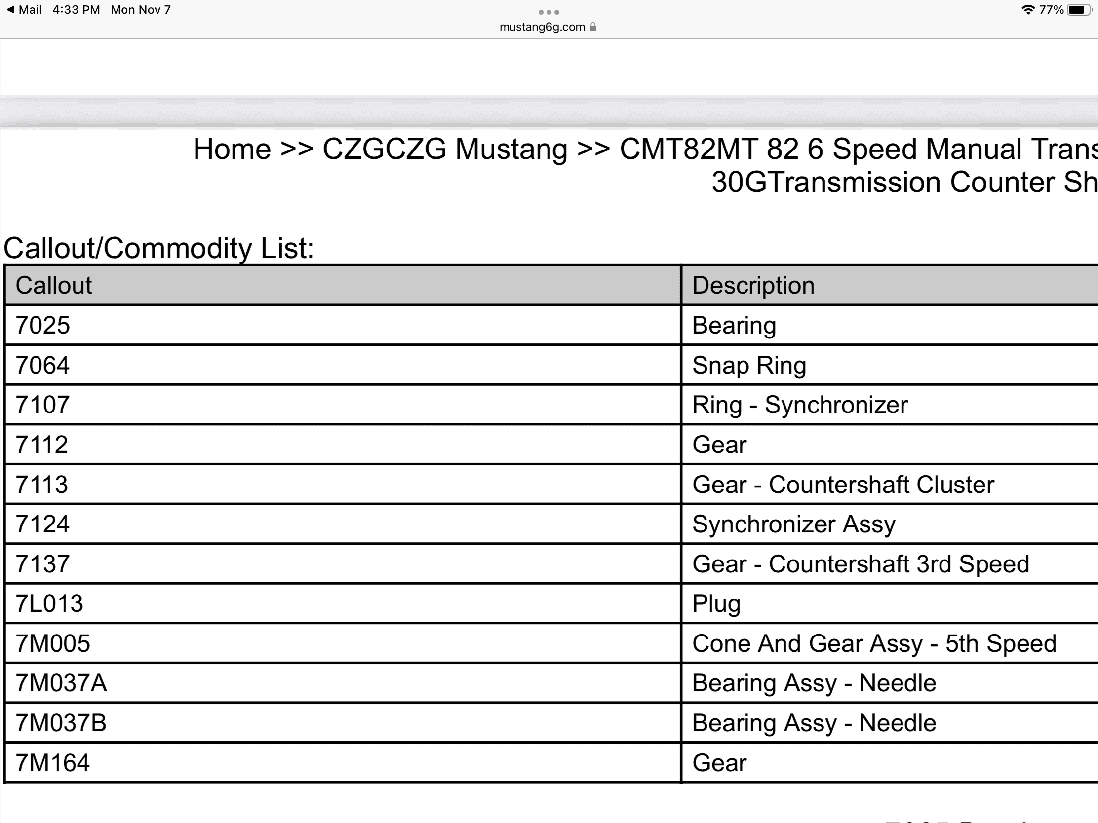

I want to share some information here on where I believe the confusion stemmed from. It appears that I misidentified the damaged gears and here’s how:
I ordered a PDF service manual for the 2015-2019 Mustang GT to aid me in the rebuild process and used the exploded view diagram of the countershaft and gear cluster to identify the gear orientation on my countershaft. The problem is, the gear orientation in the SM diagram references a 2016 GT, which is obviously different from the 2019 GT. After receiving a new diagram from Benny at Levittown Ford yesterday, I was able to confirm this. With that being said, the damaged gears are actually 4th and 6th, not 5th and 3rd as I had initially thought (based on the diagram in the SM). I wanted to point this out to save others the frustration that I’ve had to endure in ordering the wrong gears and having to reorder the correct ones. Please see diagrams and info. below for visual representations.
2015-2019 SM - Exploded view diagram of countershaft and gear cluster:
Exploded view diagram of countershaft and gear cluster, along with information that I received from Benny at Levittown Ford yesterday:
Hi Adrian,
7112 = 4th Gear
7M164 = 6th Gear
With that being said here are the links
https://parts.levittownfordparts.com/oem-parts/ford-gear-counter-shaft-4th-speed-jr3z7112a
https://parts.levittownfordparts.com/oem-parts/ford-gear-6th-speed-jr3z7j101a

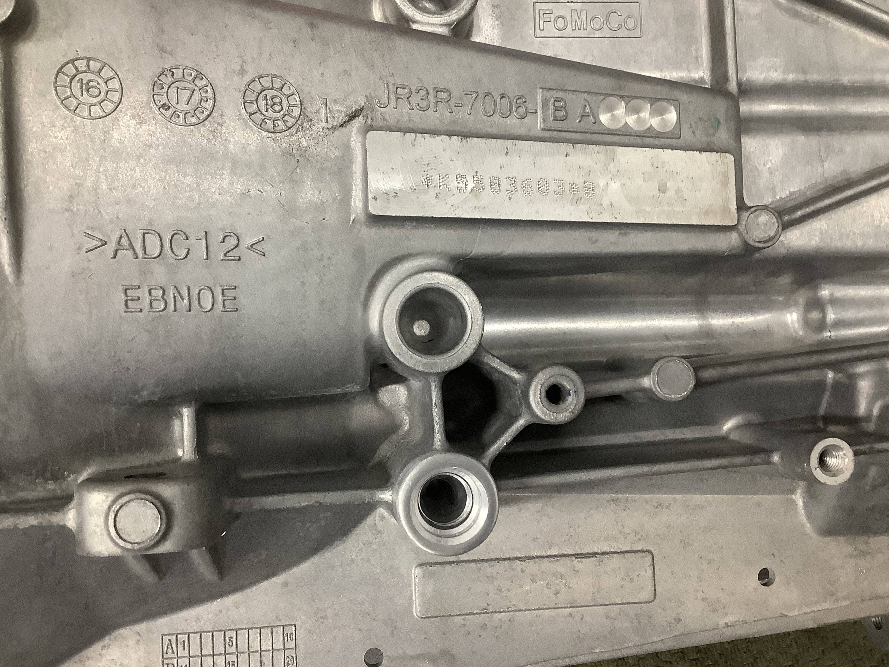

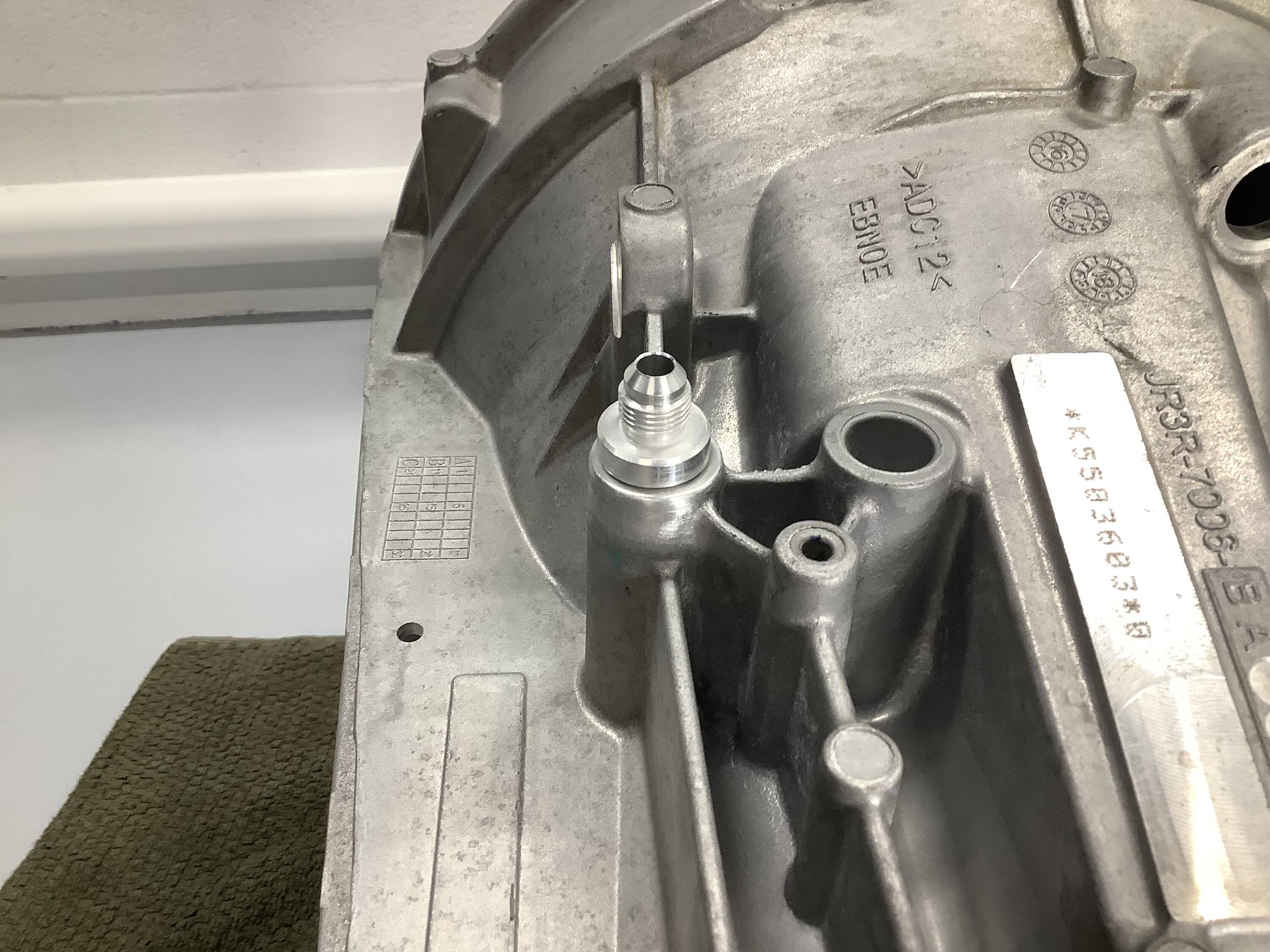

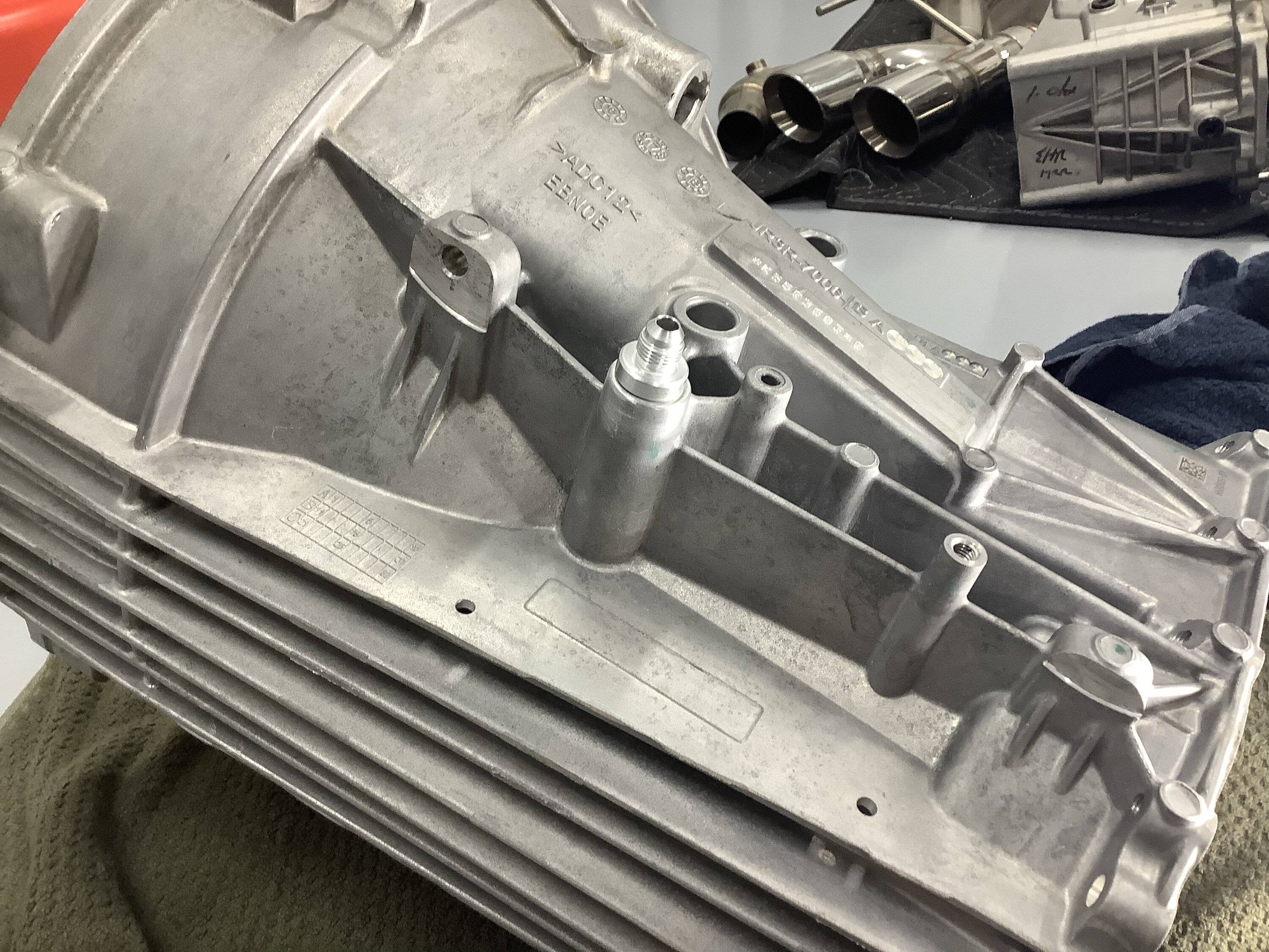

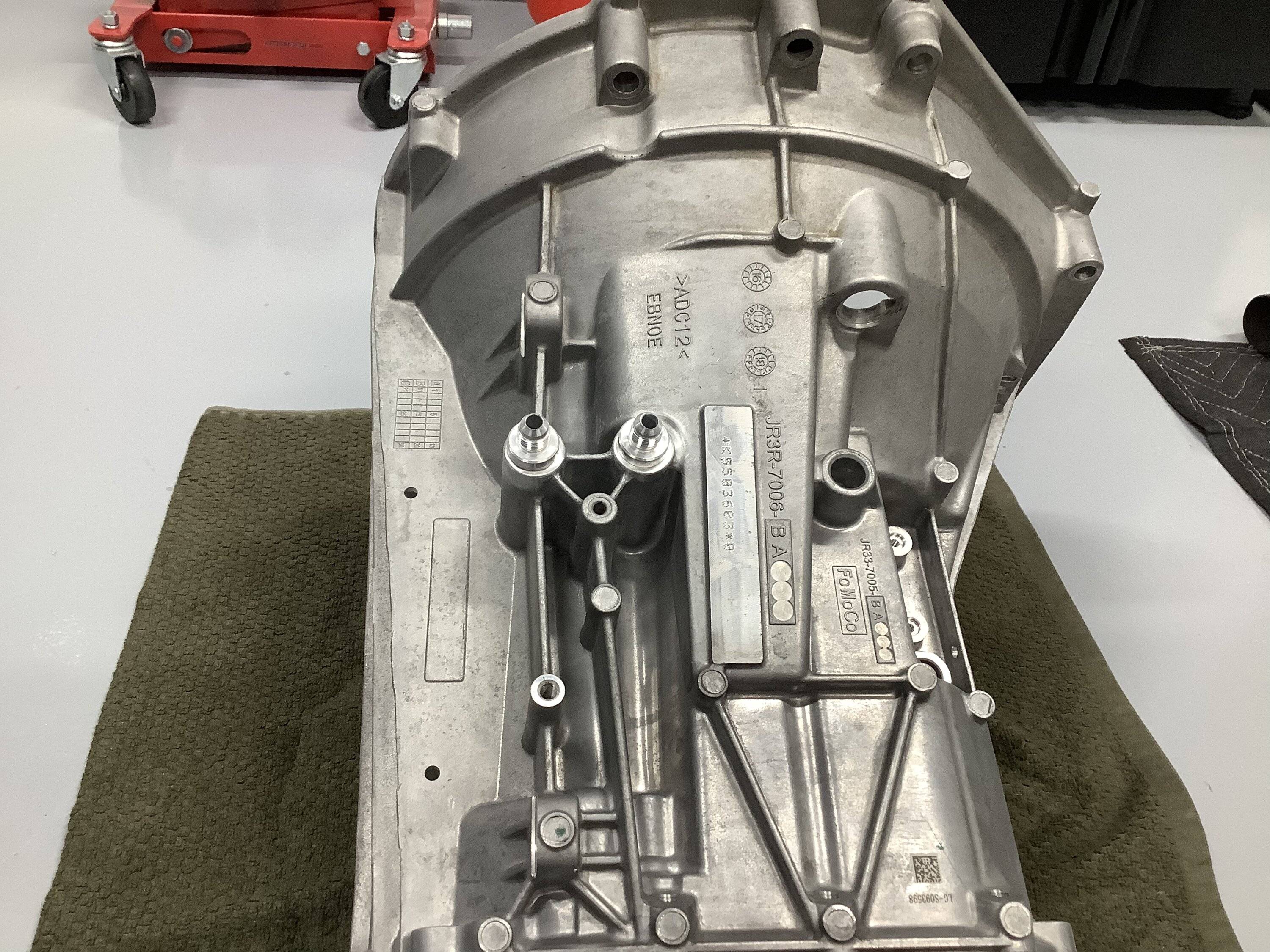

Now, I am in the process of modifying the tranny housing to accept an external transmission fluid pump. I wanted to do this to make sure that the gears at the front of the transmission have a constant supply of oil during launches and heavy acceleration, when the oil is held at the back half of the tranny by g-forces.
This mod required drilling a 1/4” hole through the side of the forward casing half to accept a weld on -6AN male flare fitting. I’ll need to locate a very capable welder to weld on the fitting, as well as, weld a bracket for the pump, which I plan to mount in the left corner of the front bumper, to gain easy access to it if needed. Stay tuned for more info. on this mod.

Instead of welding the AN fitting (and I suppose there is not enough metal to tap the hole) could the welder add enough metal to drill/tap the hole or add a tapped collar around the boss?
It may be hard to tell in the pic, but the boss is actually cone shaped. Yes, it could be filled with weld, drilled and then tapped. Not sure about the tapped collar around the boss though.

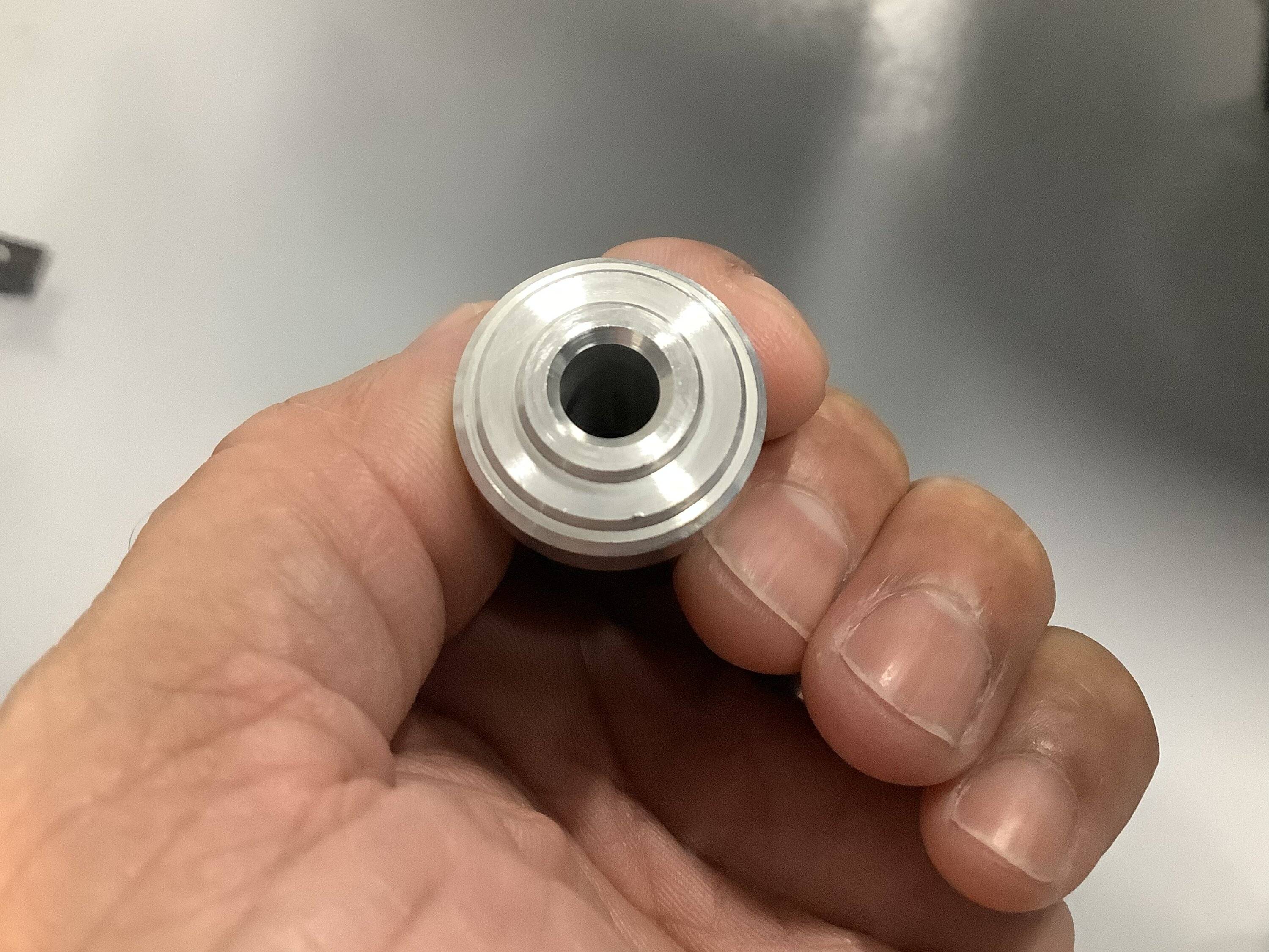

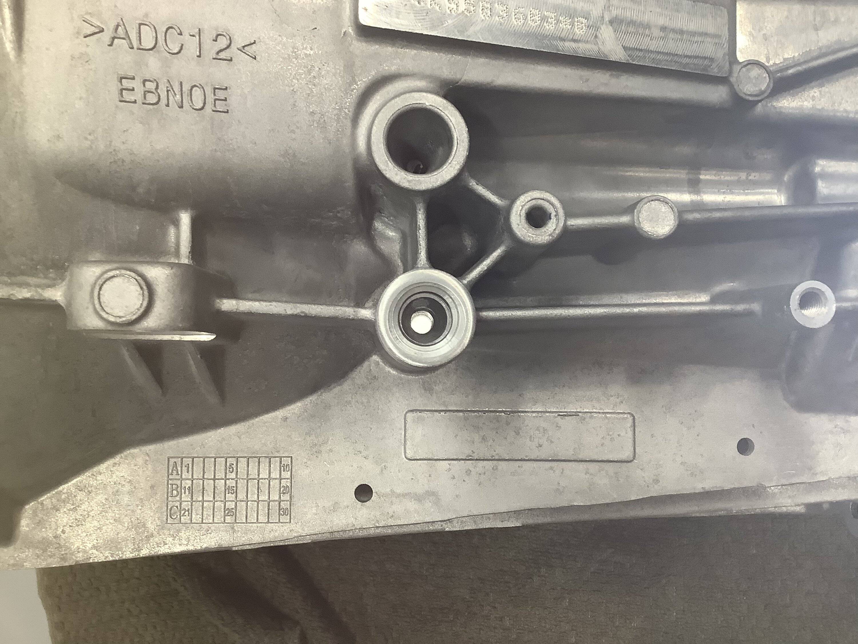

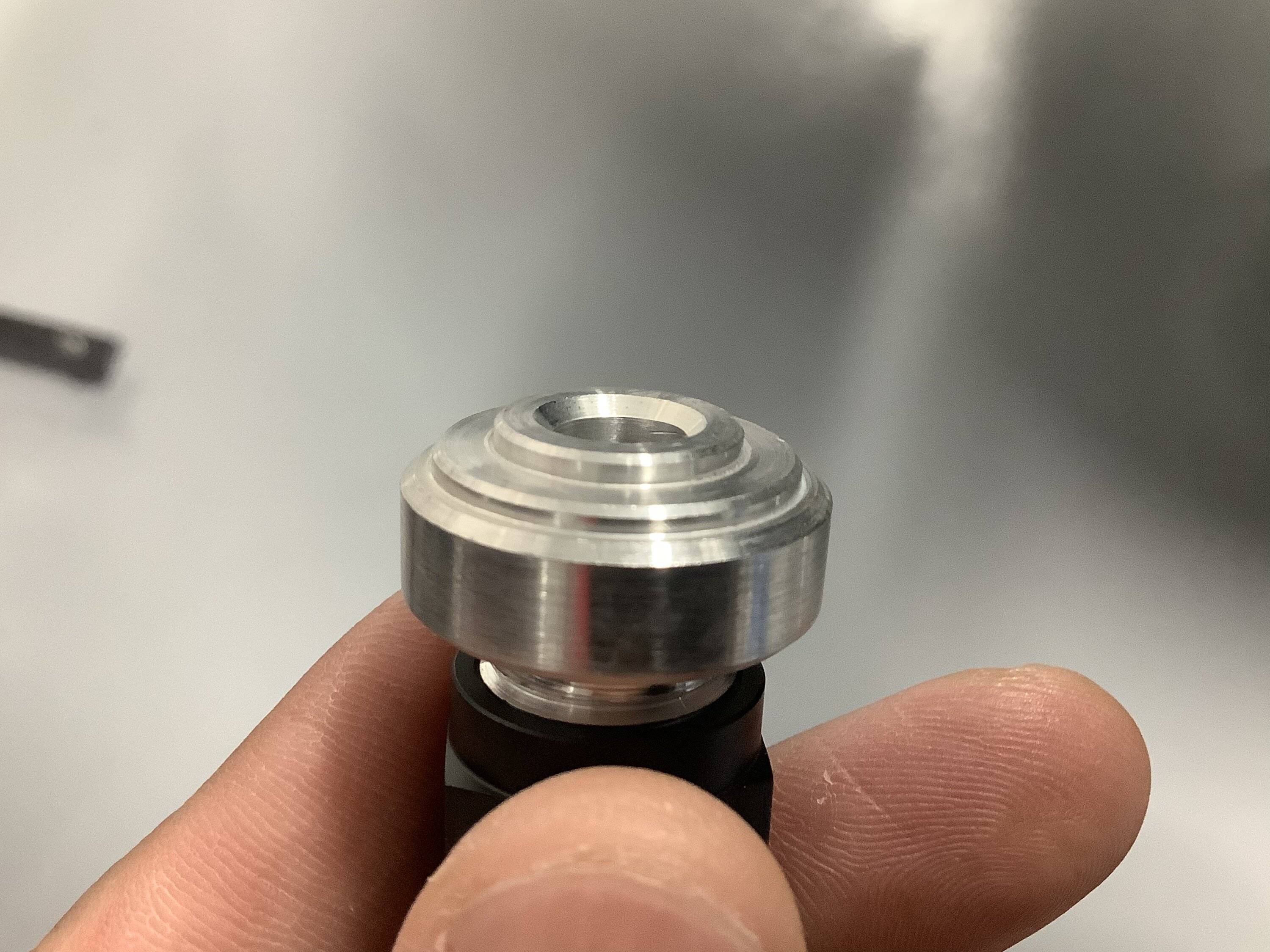

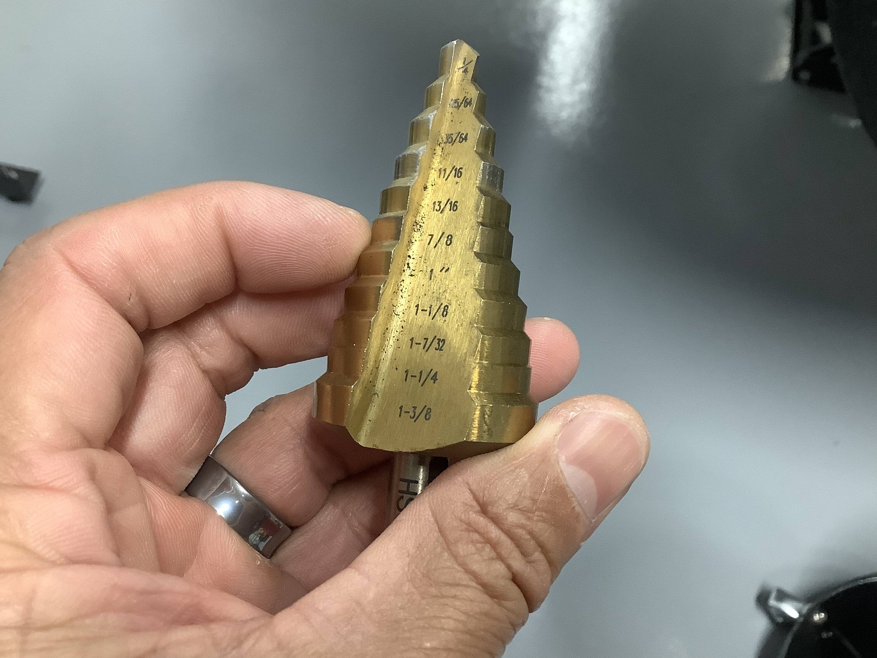

Here’s a pic of the other identical blind hole that is just above the one I drilled. I only enlarged it slightly, so that the step in the -AN fitting would sit flush inside of it. I would guess that the opening (untouched) is about 17MM and the very bottom (small end of cone) is about 4-5MM. Using a step drill bit worked out perfectly and allowed me to enlarge the opening another 2MM, to fit the step on the -AN fitting which is 19MM.

I am (was) an electrical engineer so my knowledge of welding is only what I picked up from my mechanical engineer colleagues. Anyway, the alloy of the transmission housing and the AN fitting is sure to be different. Is that a concern for welding or do I need to ask my old co-coworkers (who all retired when I did and claim they don't remember anything). ;)
I don’t think it’ll be a concern at all. Tick Performance does this mod on their T56 transmissions. Take a look here.

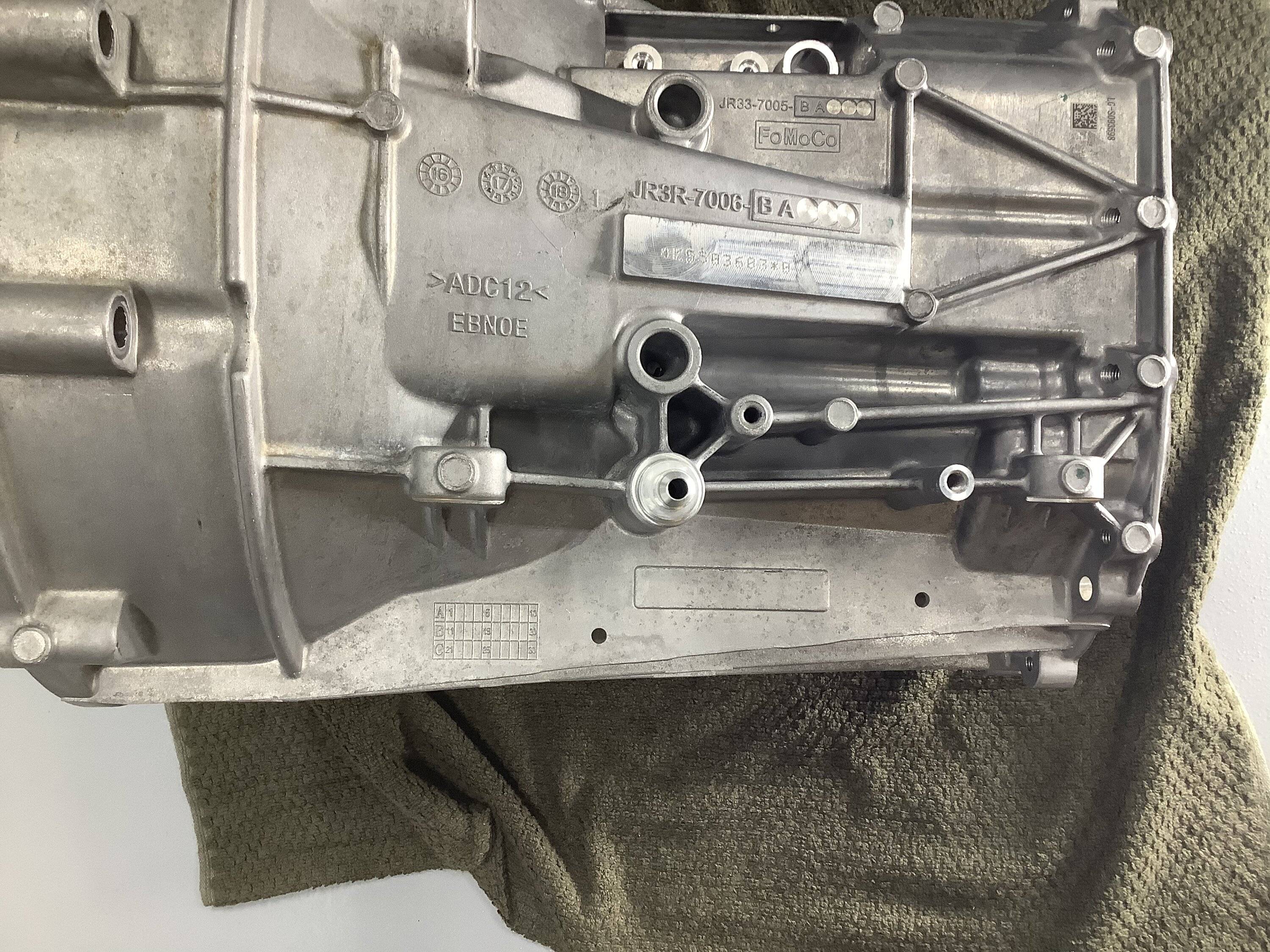

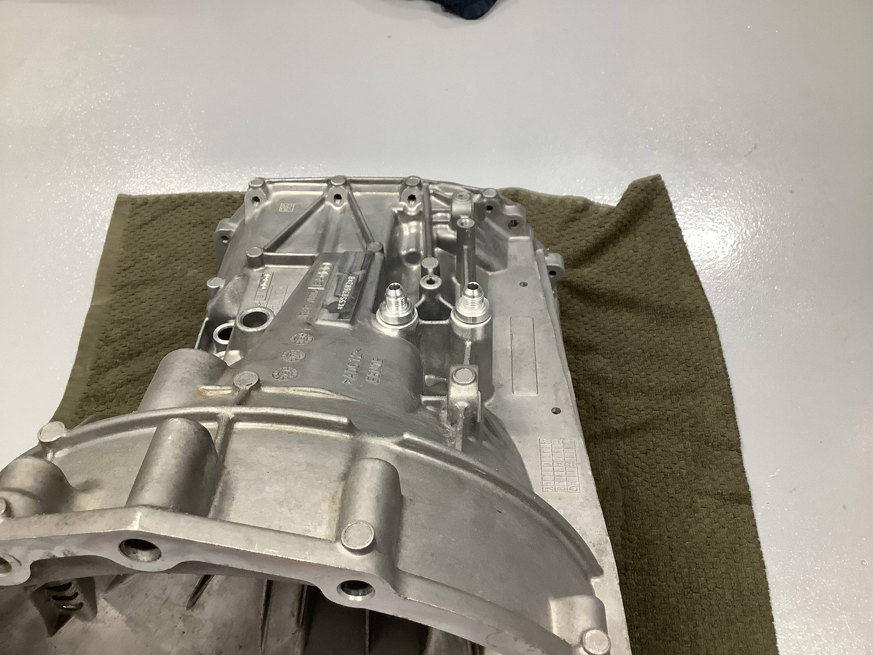

I test fit the front half of the transmission case to the engine and confirmed that there is ample clearance for a second fluid pump feed fitting, so I repeated the process from yesterday. If one was going to be good, two should be better, right? It sure would be nice if the entire transmission was just as light.
