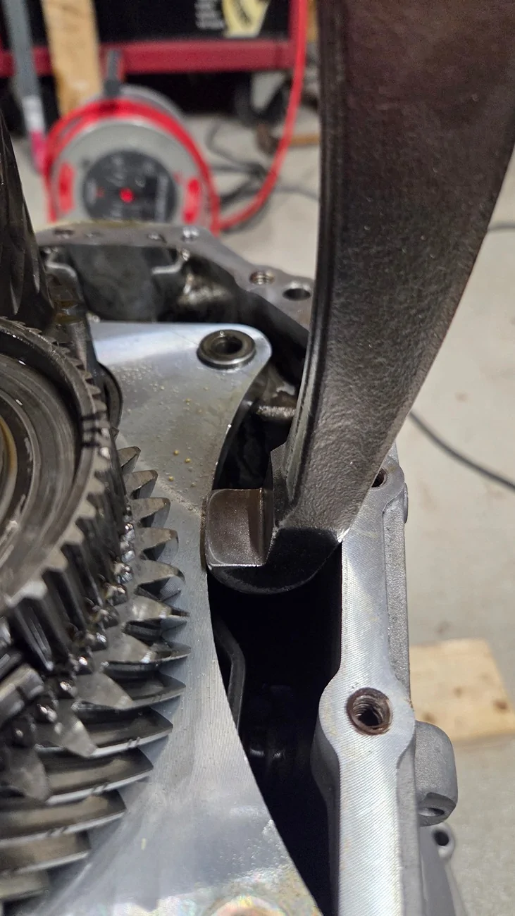

@NGOT8R I hope you don't mind the thread bump, but would you be able to tell us what the medium and large puller you use during the thread are? Are they equivalent to the OTC 1039 that the Ford manual mentions, or something else? I'm looking at stripping a non-D4 MT-82 and the ones you've used look like just the job.

Yes, the OTC brand pullers are the ones that I have.

Coming back to this one, a thing to note is that for a non-D4 'box, the hook end of the legs on the 1040 puller are slightly too wide to fit either side of the centre support plate with the puller assembled. The way around this is to disconnect one leg of the puller and maneuver the legs in individually.
Also, not sure if the 1039 would be long enough to remove the centre support, as the manual for the non-D4 calls out the use of the synro gear pack remover instead. The 1040 was set to the middle holes on the legs, and was quite far extended.
The 2nd gear and centre support was very easy to remove, however.

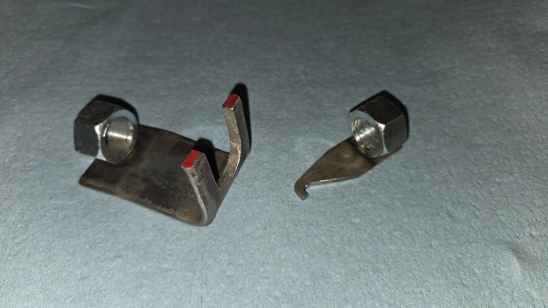

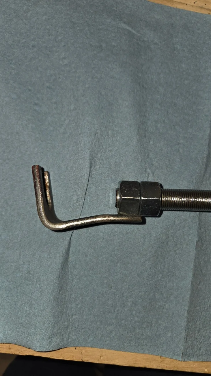

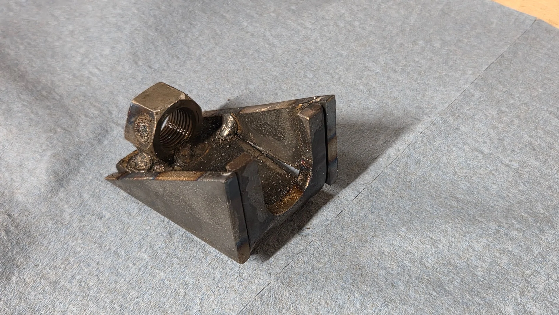

Thankyou for allowing me to gatecrash your thread! Actually this gearbox is a spare that I bought to take apart, with the view to stripping and repairing the one in my car. This 'box is an S197 one, I'm told it had around 100k miles on it but was crunchy into 4th gear. I've found the plastic shift pads are loose in the shift fork, but I'm not sure if that's enough to cause an issue.
The one in my S550 only has 65k miles on it, and is daily driven carefully, but has what I think is a rough countershaft bearing, as it's grumbly in every gear except 5th.
My plan is to practice on this 'box, and then at some point attack the one that's fitted to the car.
As I didn't want to spend $$$ on the all the special tools I made a front seal puller, got the detents out with pry bars after heating the case gently with a hot air gun, and then got stuck with the gear stop pad.
So I made a tool for my slide hammer, using Home Depot's finest steel stock (lol) and a 5/8-18 nut.
The front seal puller worked a treat, whereas the stop pad puller didn't, it just started to give up.
So adding some sides for triangulation got it a bit stronger. It's messy due to Flux Core weld spatter, but it worked.
I can share drawings for the seal puller and stop pad puller if anyone's interested. For next time, I'll definitely make a smaller version of the stop pad puller for the detents.

You’re welcome! I don’t consider it gatecrashing the thread at all. I view it as helping to grow the thread, in the spirit of helping others.

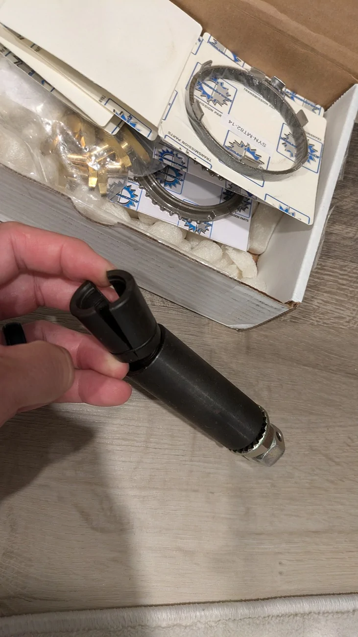

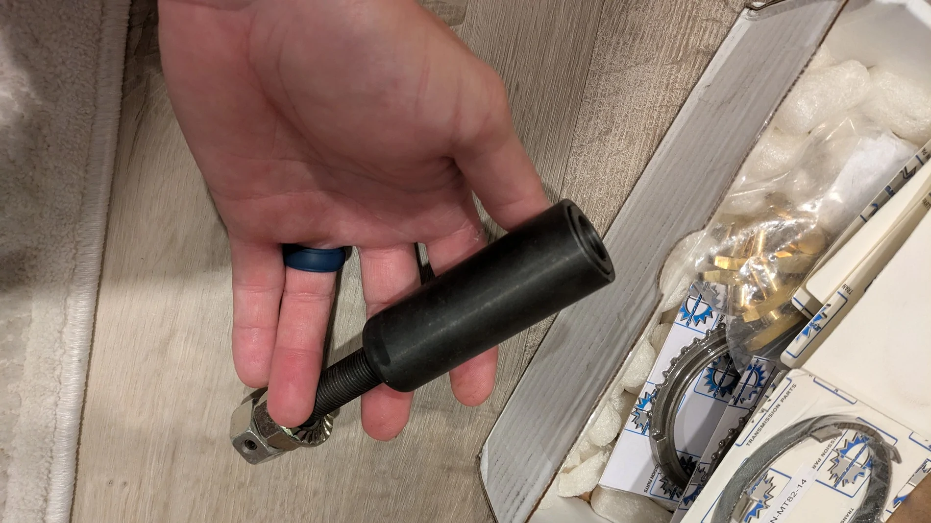

Great workaround on the detent puller tool! I paid $260 for that one tool. I tried a cheaper version first and it didn’t work very well at all.

Good experience indeed thank you for sharing. At 16:40 these guys are using a bearing seperator/puller to remove detents.
I like the diy tool, I have the one amp sells but yours is one I can replicate if it doesn't work out.

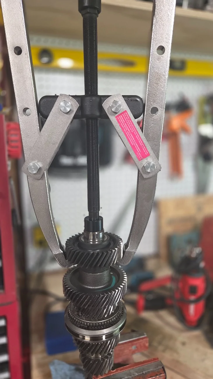

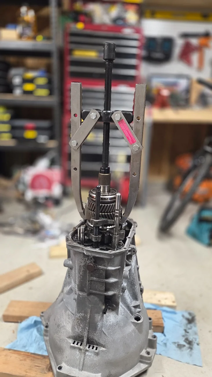

This is where I am now stuck. Having read pages 6-8 of this thread - the ballad of Bucky and Snag - I was wondering how to get the fixed gears off the shaft in order to free the free-spinning 3rd and 4th gears.
I tried the puller (figured it was rated to 13tons so why not give it a whirl), but I applied as much torque as I could to the forcing screw but nothing budged.

This is where I am now stuck. Having read page 6 of this thread - the ballad of Buck and Snag - I was wondering how to get the fixed gears off the shaft in order to free the free-spinning 4th gear.
Yeah, that one is tough to get off. You may need a 12 or 20 ton press to get that one. Be careful of the teeth on that one and watch your eyes in case teeth start popping off.
Try putting the entire assembly in a preheated oven at 350* for about 30 min. and see if the 2 jaw puller will get it done. It’s worth a shot before buying a press (if you don’t have one). I’d spray the entire shaft assembly and gears down really well with brake and parts cleaner first, so that you don’t smoke up the house. If that doesn’t work, a press will be needed.

Do you think a 12t press would be enough? I don't have one, but may be able to get access to one.
