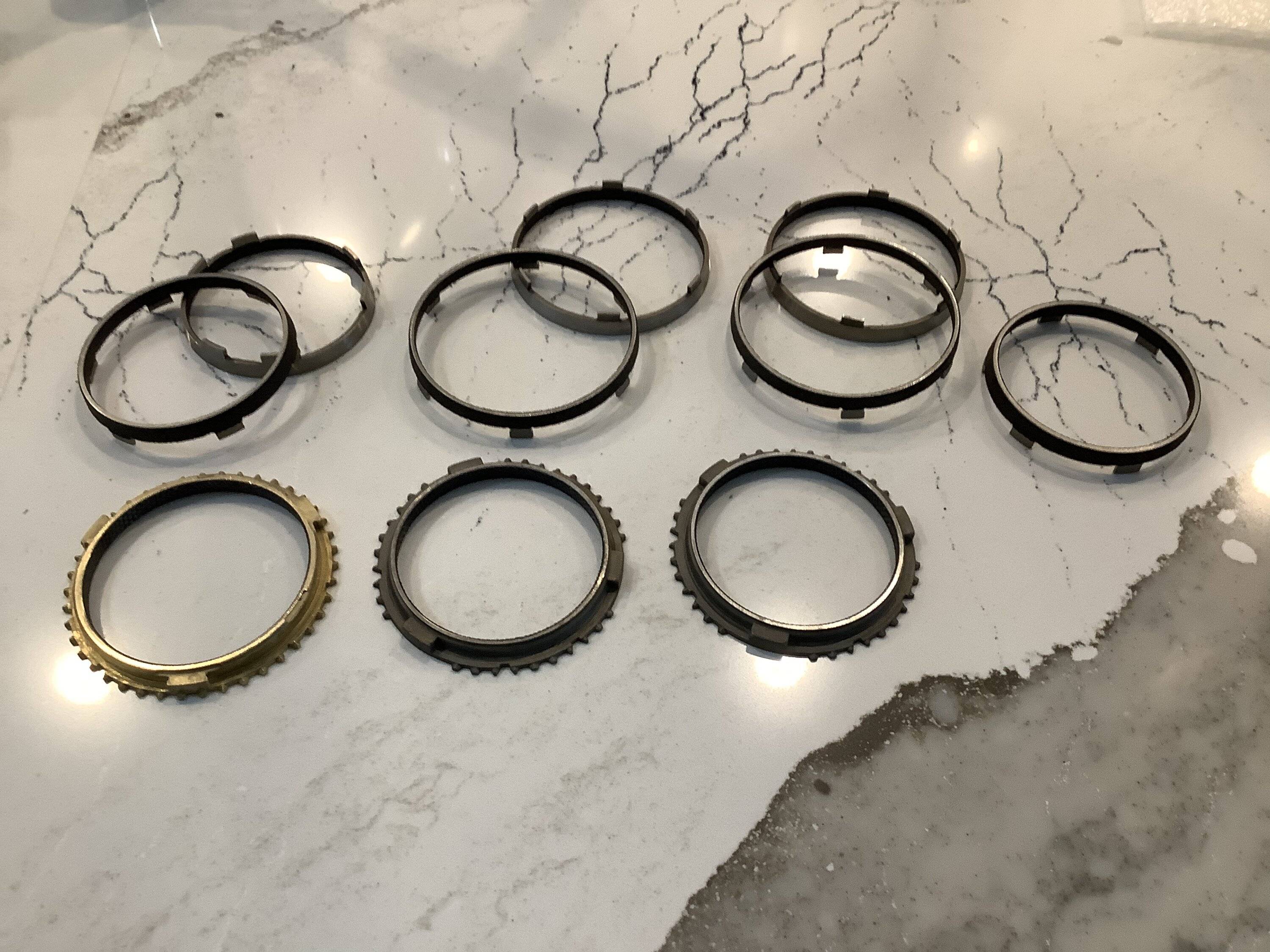

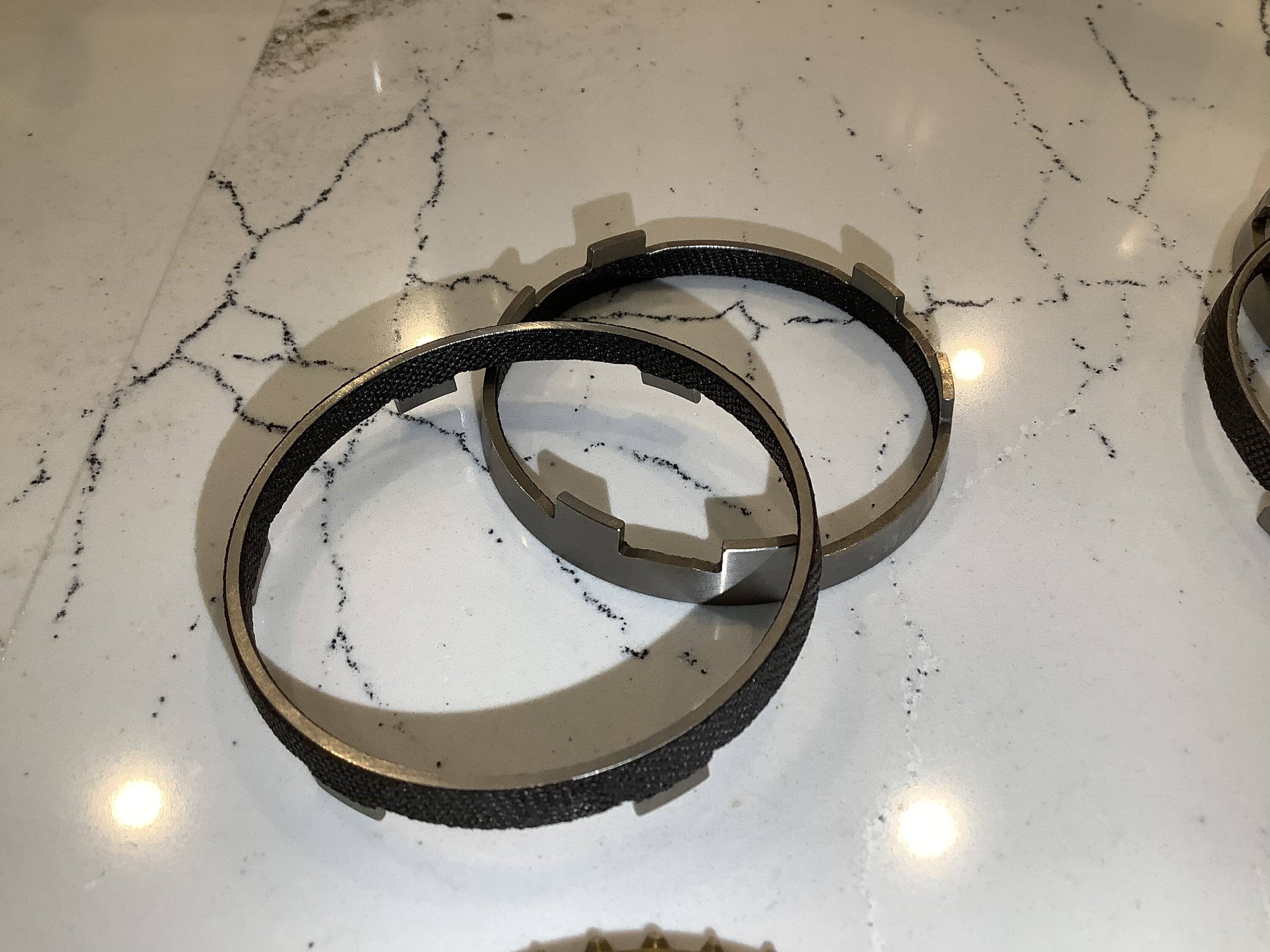

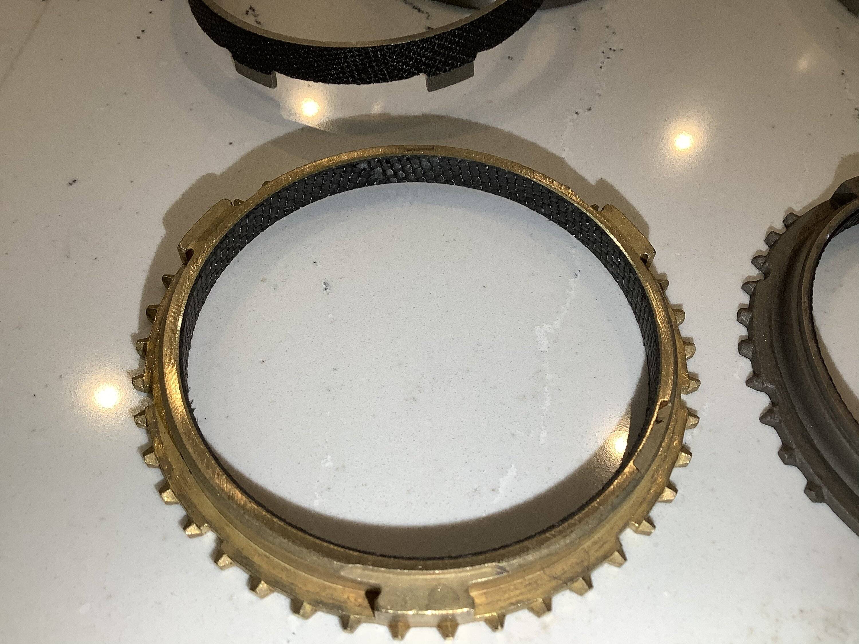

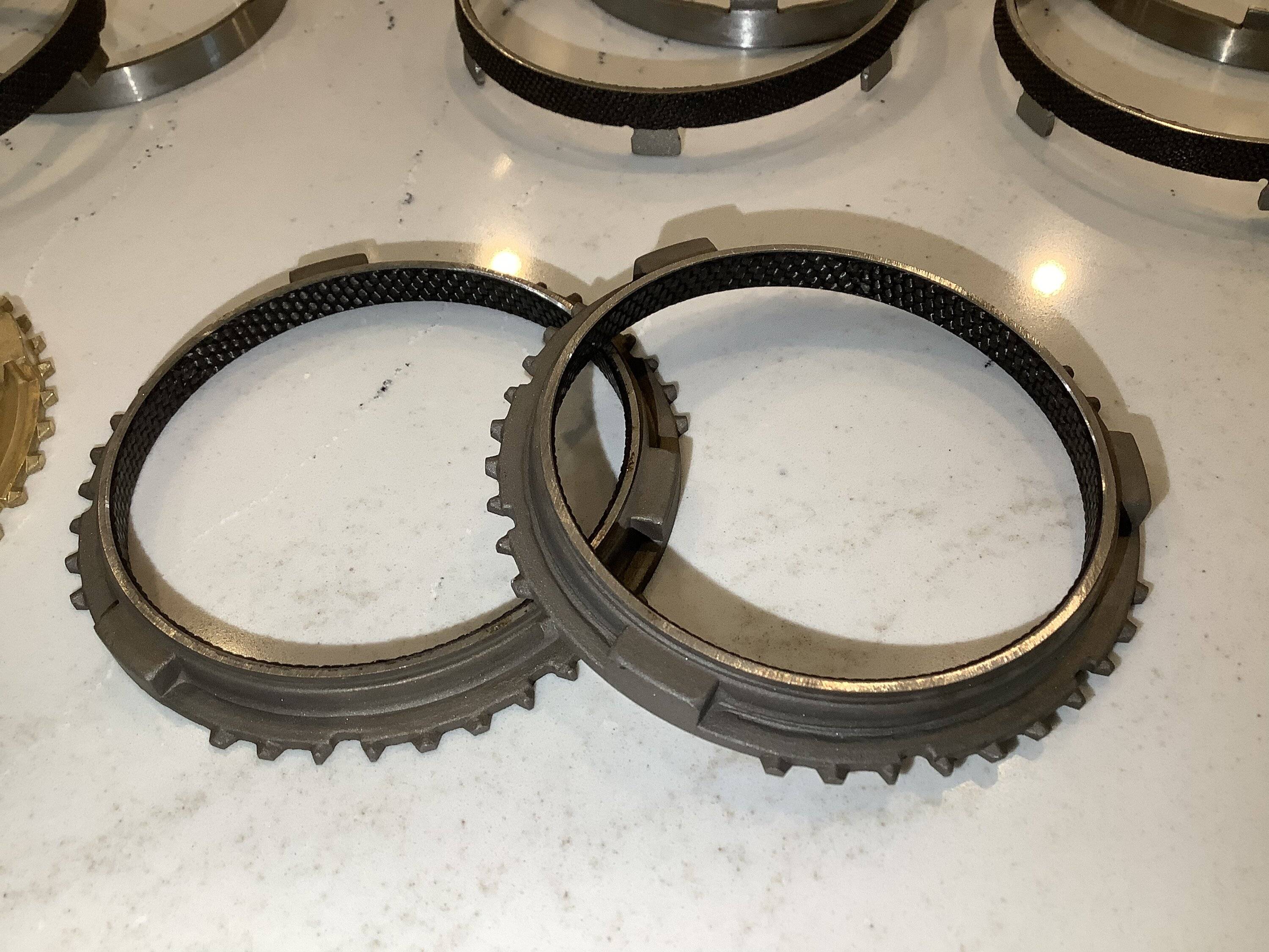

I received my Synchrotech Pro Series - Carbon Synchro Kit for gears 1-6 today. They look like they should be an improvement over the factory synchros.
I've had great experiences running Synchrotechs in a different Getrag. Good stuff!
Glad to hear that! I was hoping someone would chime in and post their personal experiences with them. Would you say shifts were noticeably smoother with them?
Smoother than the broken OEM synchros...
Lol, its not so much shifter feel, but ability to handle more abuse. Fast hard shifts.
