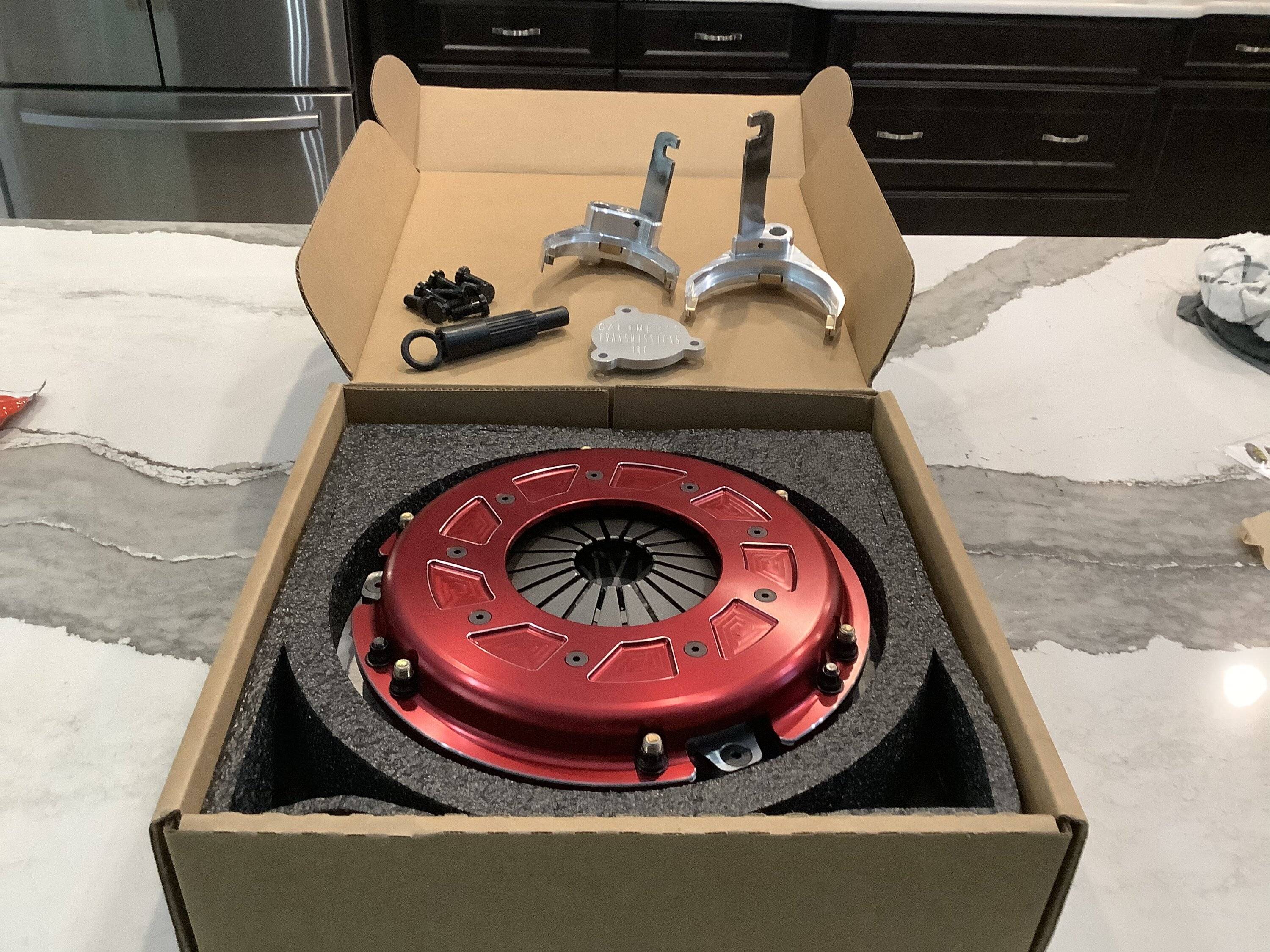

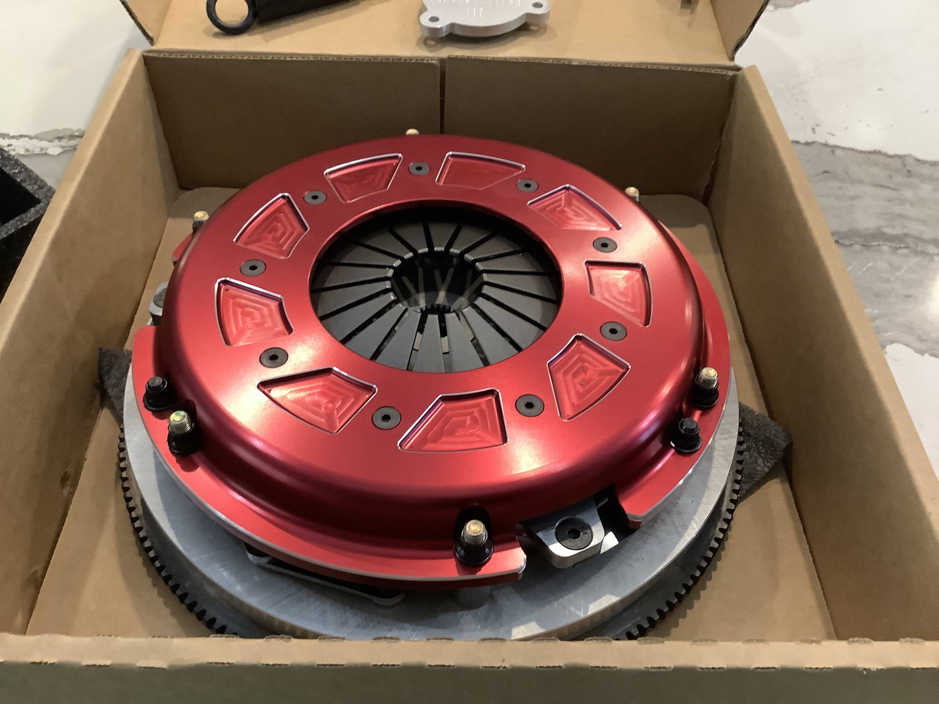

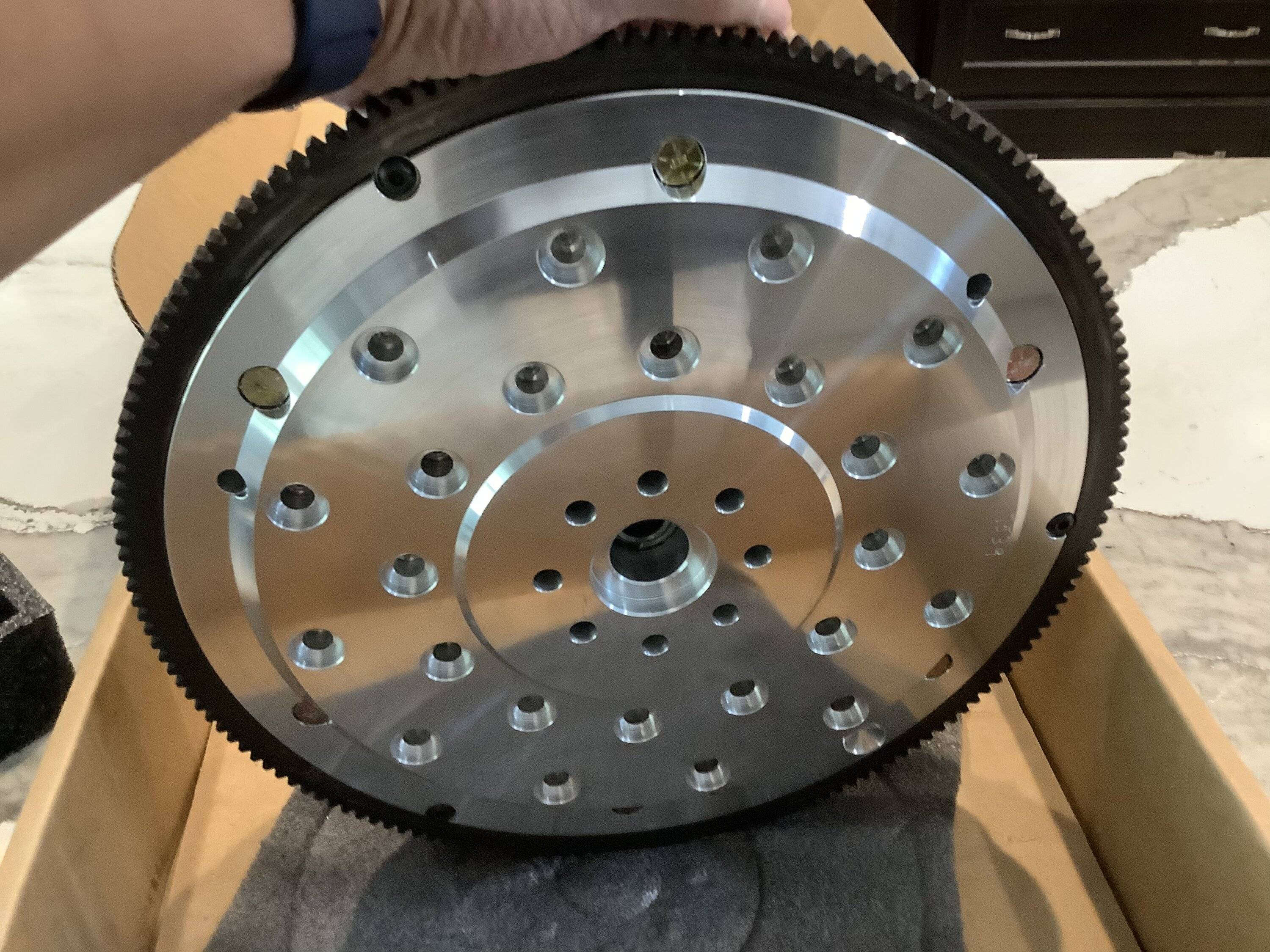

Here are a few pics of some MT82-D4 eye candy! I’m now one step closer to having everything that I need. Now if I could just get our home builder and his contractors to come and finish up some work to my garage floor and re-epoxy it, I can finally get on with pulling the tranny for an inspection and teardown. At the rate he and his contractors are going, it could be another month or two before they get out of my hair. It sucks being at someone else’s mercy. It throws a big wrench into my plan of attack.

I had to endure a little unnecessary anxiety behind this shipment, as yesterday, FedEx sent me an email saying they had delivered it to my front door. We’ll, my security system said otherwise (didn’t happen), so I started a claim with FedEx. The rest of my night was jacked up, wondering where my expensive clutch was. To my surprise and total appreciation, my doorbell rang this morning and it was a neighbor, who lives two blocks away from me in the same subdivision. He said he woke up and found my clutch at his front door and figured I might need it. Thank God for decent people. I sent FedEx’s customer service an email saying that I laid my package and a short while later, I received a call from a guy identifying himself as a FedEx employee. He went on to say that he was following up with me and wanted to know if I received my package. I told him yes and explained what I knew to have happened. Believe it or not, the guy said to me, “Well at least you got it!“ That was very reassuring (being sarcastic) to know how much he cared. I’ve been debating whether to contact customer service again and give them the name of the person, who actually called me (in case it was the driver that screwed up). While I wouldn’t be seeking to get anyone in trouble, I would like to make sure I mitigate the chance of something like that happening to me again anytime soon. Crisis averted and now I’m breathing normally once again? SMH

Thanks. The clutch is a twin disc. I think it weighs something like 62 lbs. I liked some things about it over the Mantic such as, the clutch plate and springs looks much more beefier. The Mantic also seemed like it had a couple more steps to the install with the aluminum drive blocks (not really a big deal, but could be if someone didn’t pay attention to this step). Lastly, the Ram seems like it would offer more protection or containment of parts, should something fail or let go, whereas the Mantic is more open on the outer perimeter and could provide an avenue of escape for broken parts if a failure were to occur.
