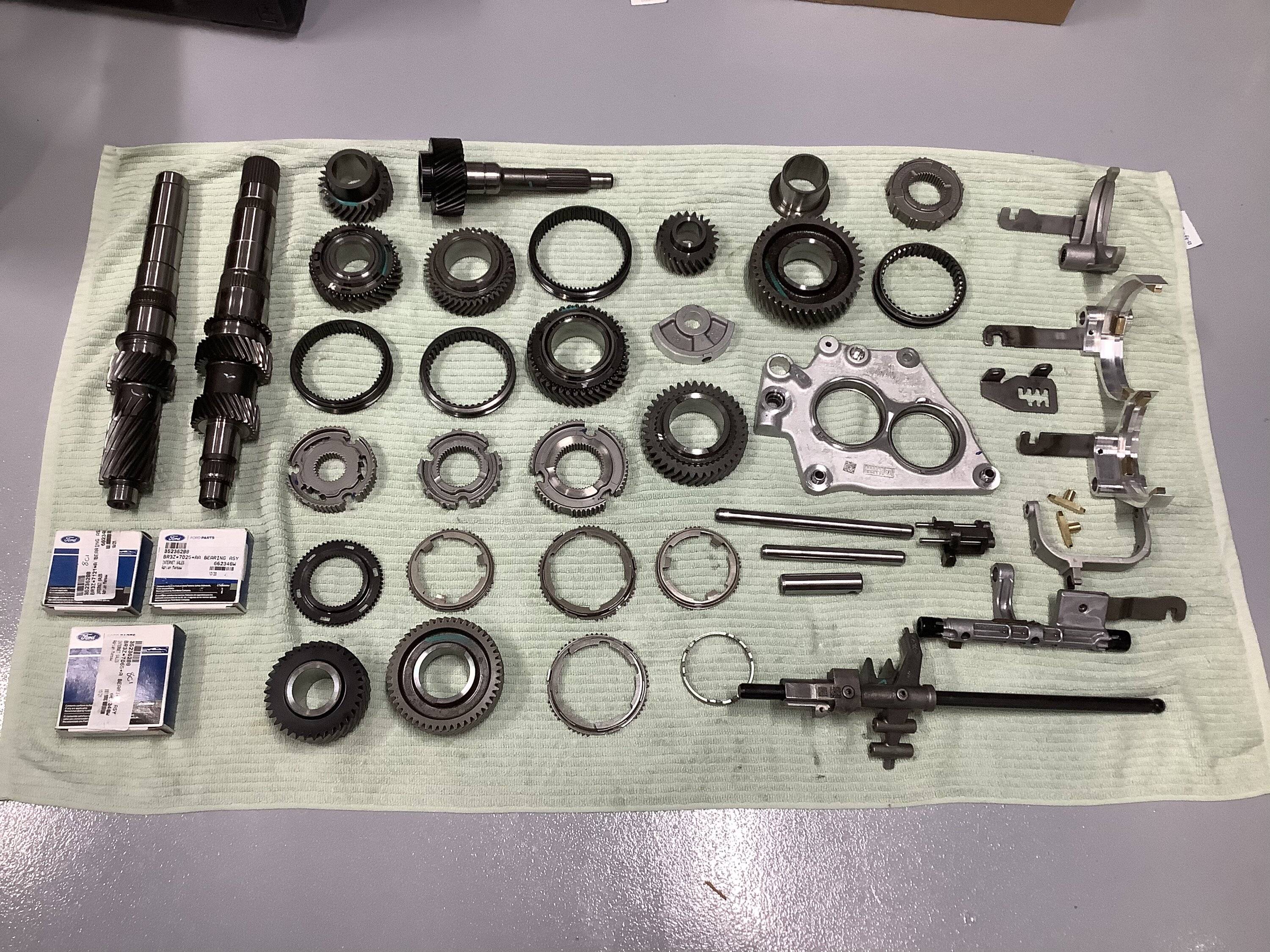

I talked to Ben at CTP (Controlled Thermal Processing Inc.) today and received the quote for cryo treatment of all transmission parts (including the input, output and countershaft bearings). Once cryo has been completed, all parts will be measured and I’ll be given a quote for the WPC process, which is also in house. Here’s a pic of everything that will receive both treatments.
Cryo treatment = $600 plus shipping
WPC treatment = TBD

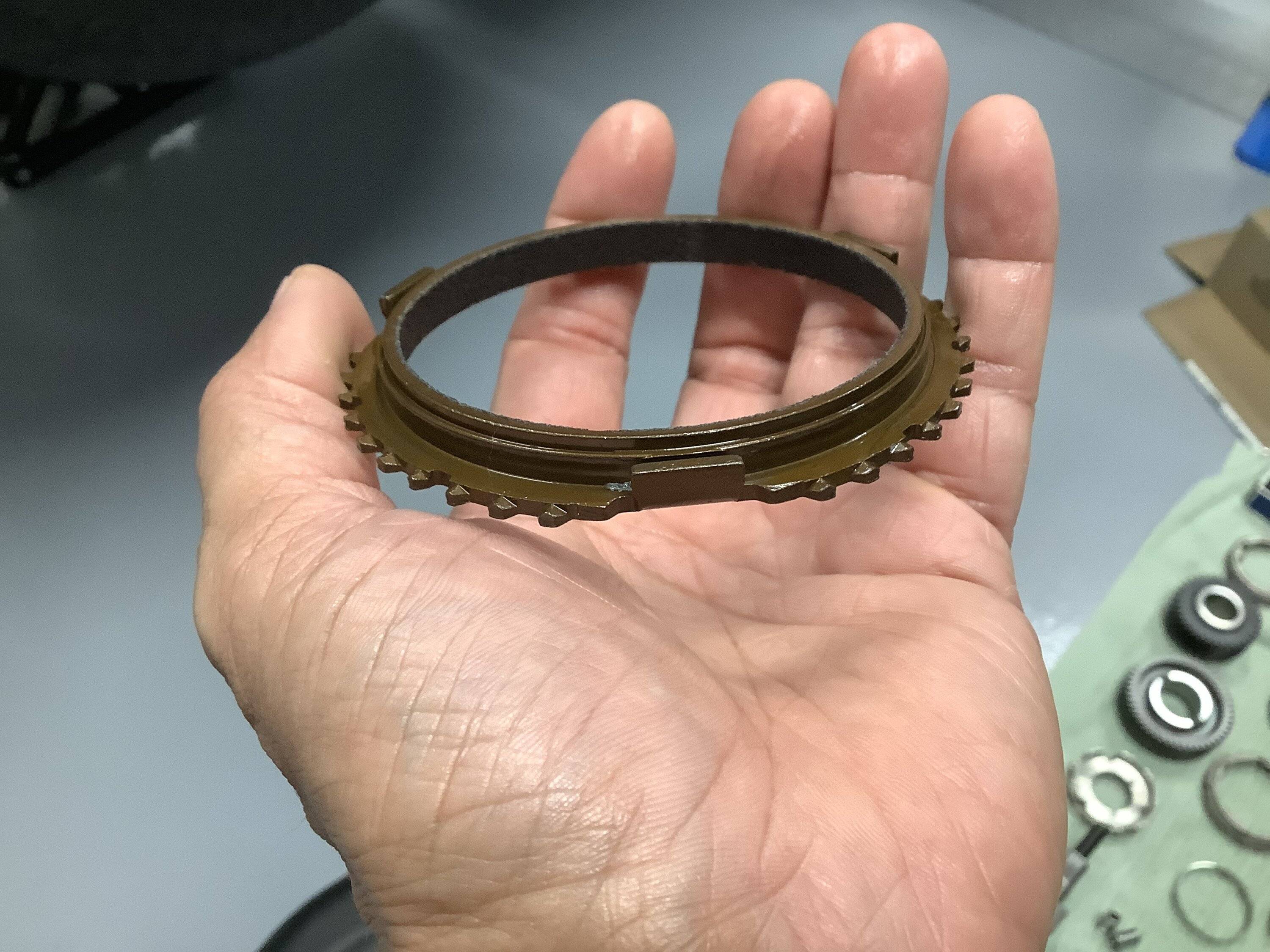

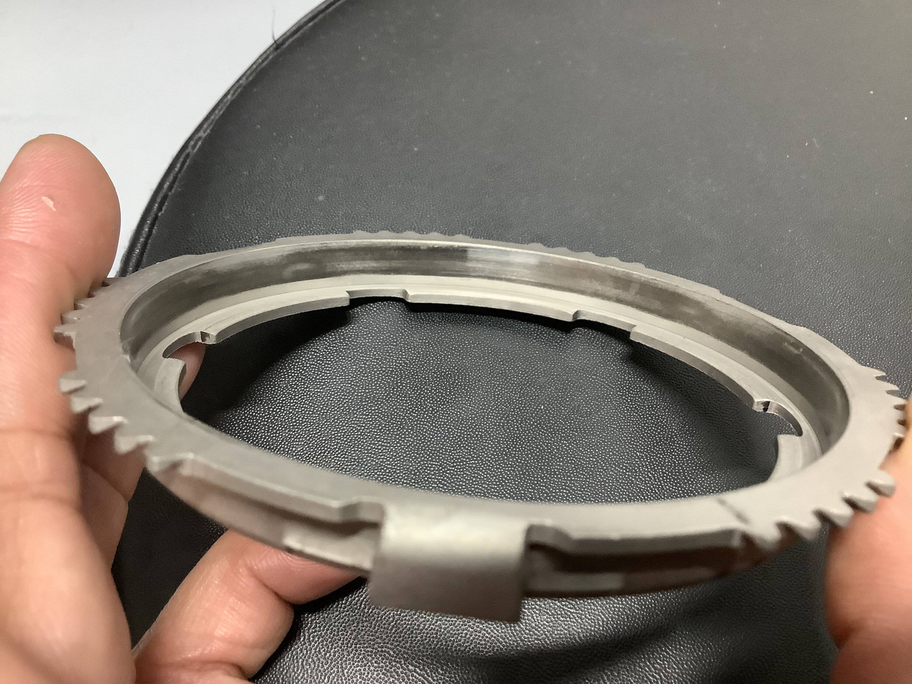

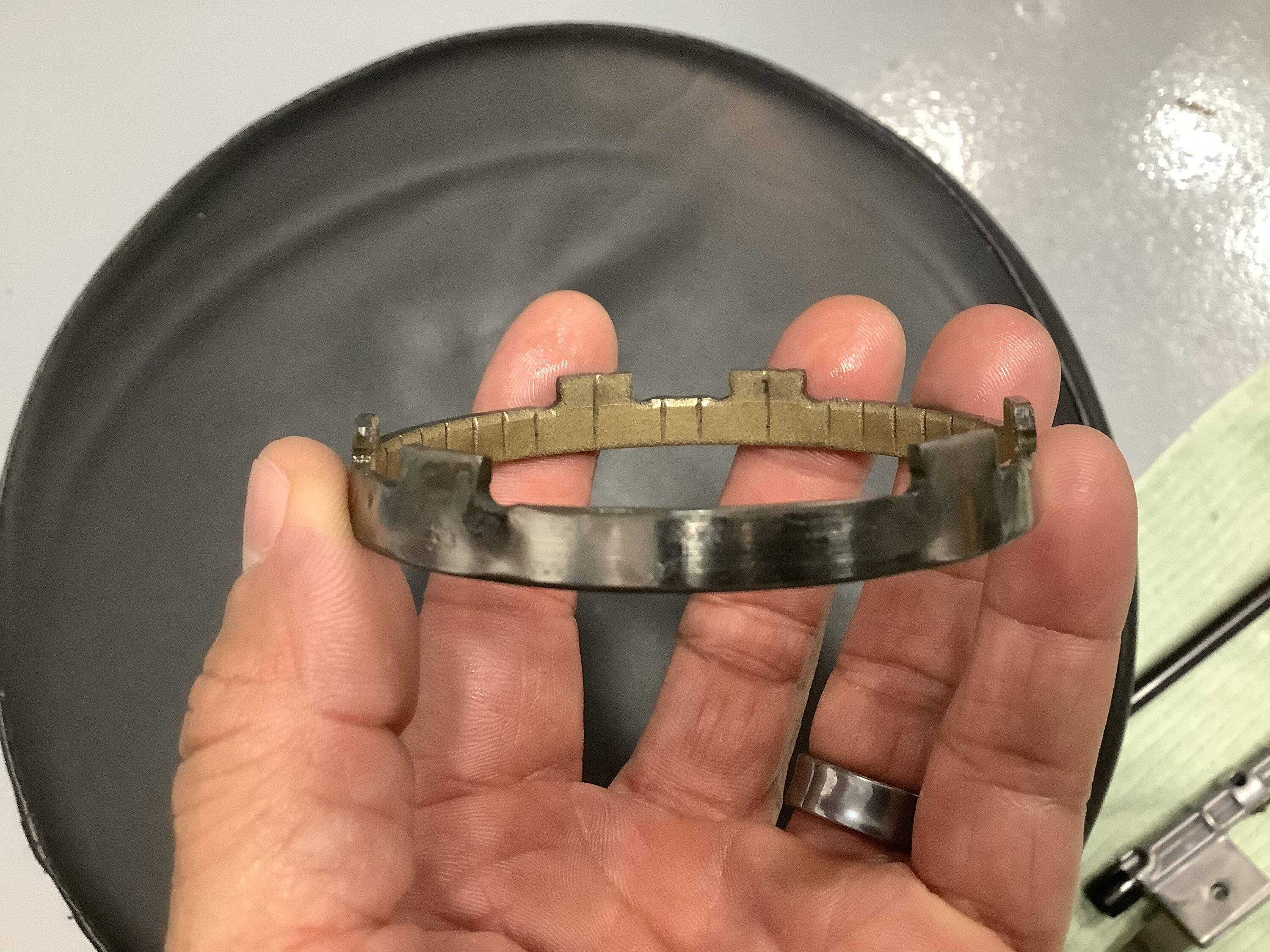

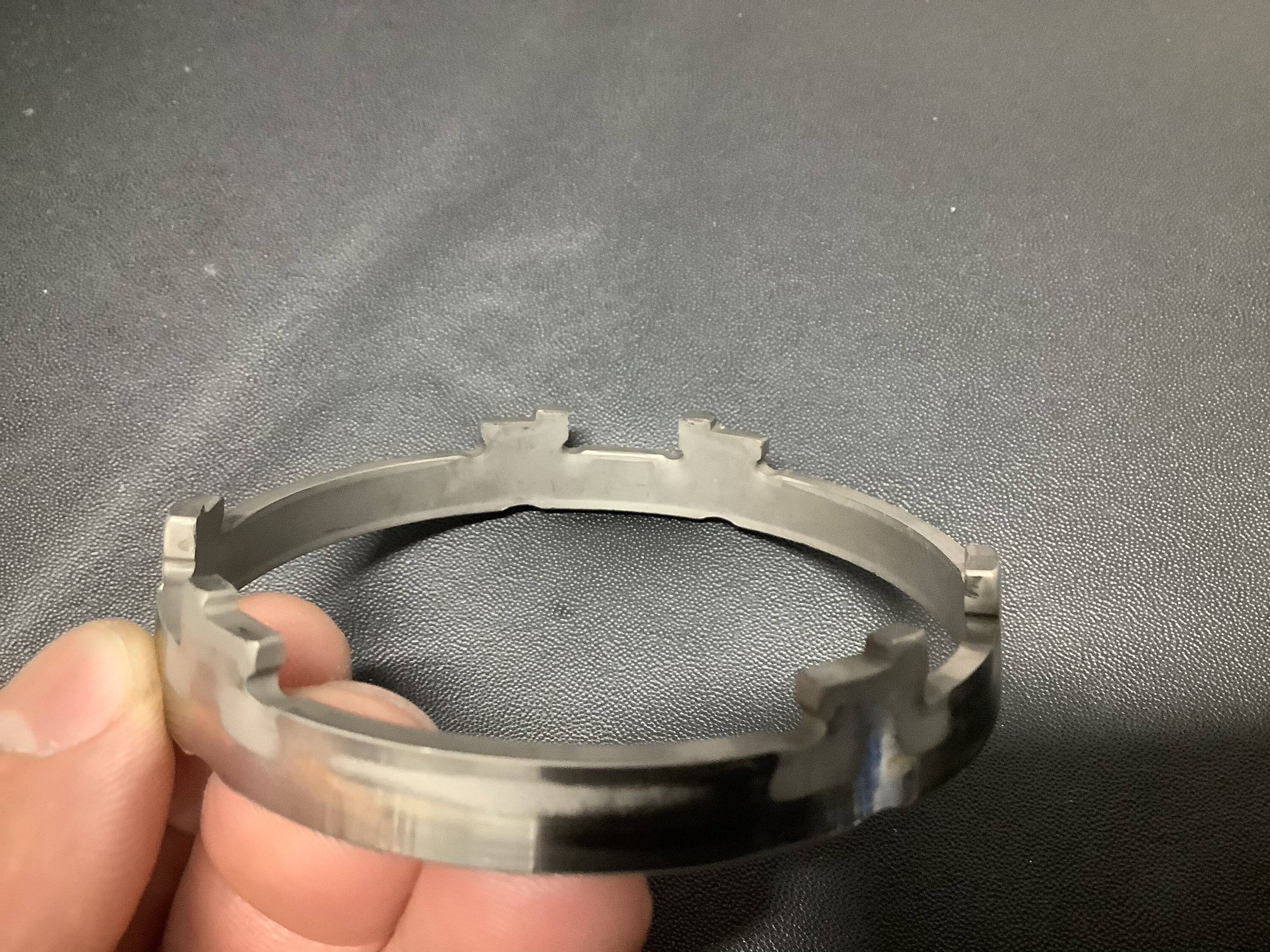

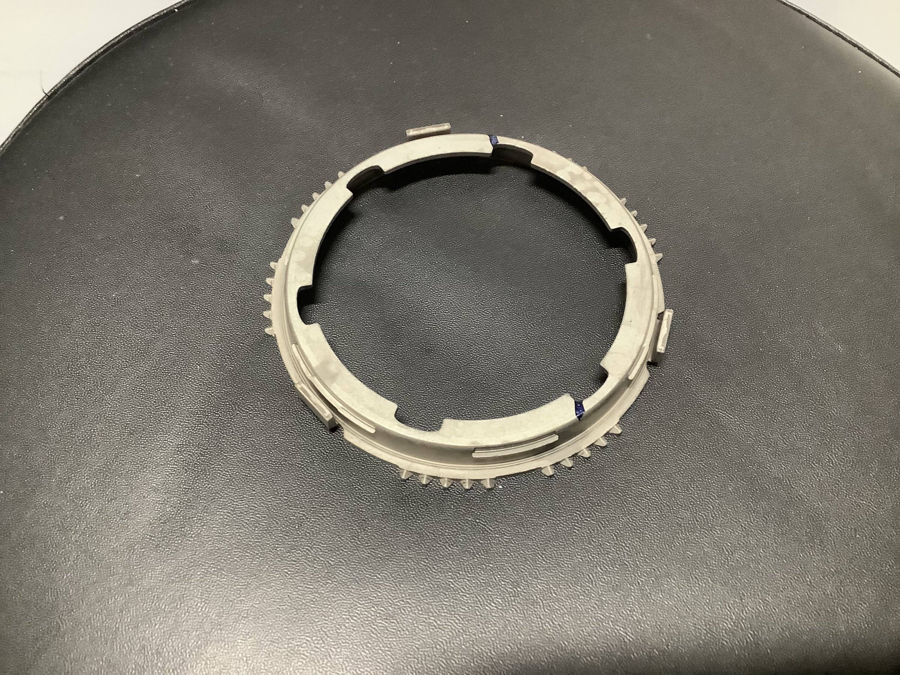

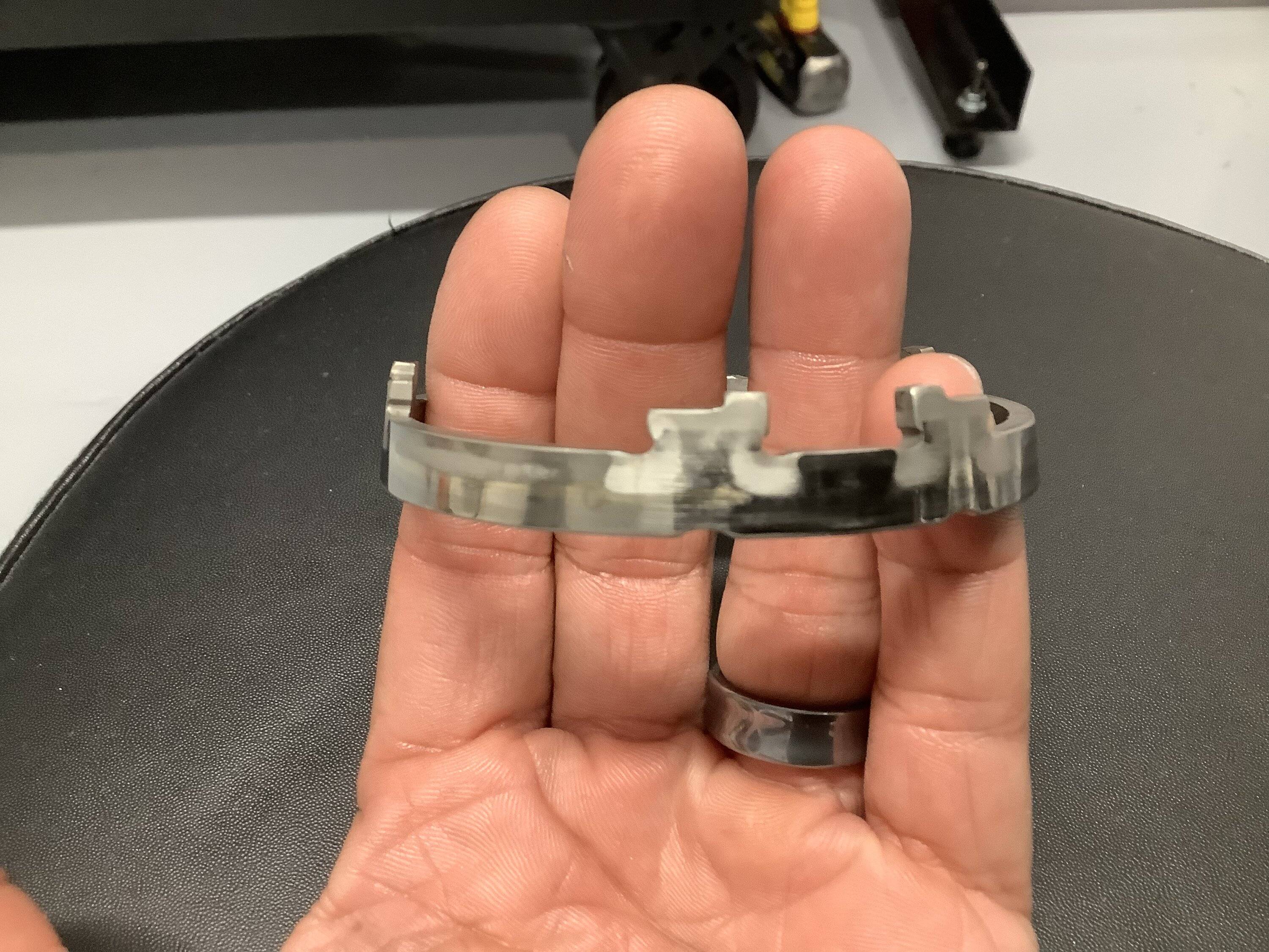

Something worth taking notice of was the coating on the 1-2 synchro inner ring as well as 1-2-3-4 synchros are missing some or most of the coating which I believe is called molybenum coating (that’s intended for grip). I‘m going to guess that with the coating gone, less grip would mean there would be some slippage at some point.
Also, 5-6 synchros appear to have some variation of a carbon lining on the insides. However, with me just lightly handling them, I could feel and see grit from the carbon lining coming off onto my fingers. Keep in mind, that these parts only have about 6400 miles on them.
I have read that the WPC treatment will improve the grip on synchros, so they should be good to go once they’re treated.
