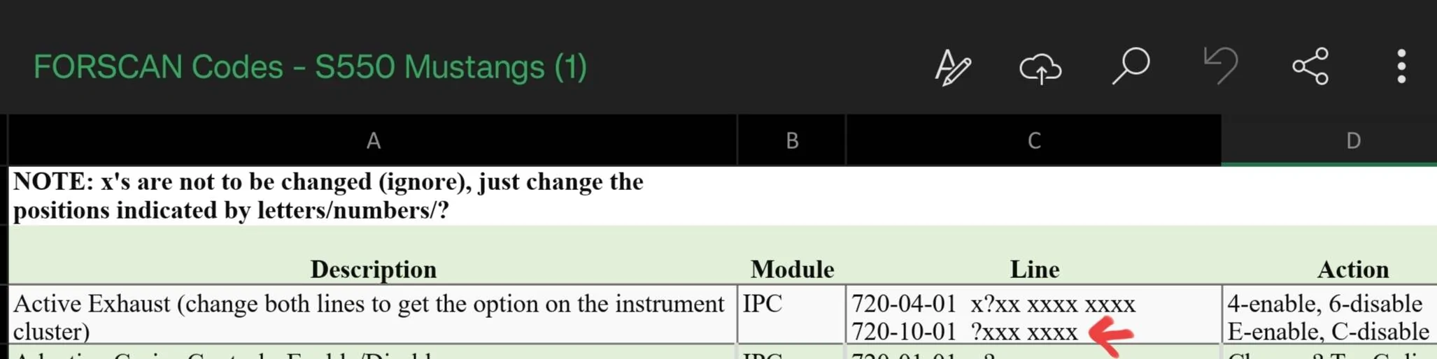

Not sure this is the correct place but since my car got tuned it seems my active exhaust is well half there... it's a 2021 Mustang GT base with factory Active exhaust. So I can get in to quiet mode and then I think just normal mode. If I switch between normal and track I don't hear the actuator, quiet to any mode I hear the actuator. Checked Forscan and line one shows it's disabled, so easy enough I can enable it again but line 2 is asking to replace with a letter but in my line the letter is the last character showing that's it's disabled. I'm confused and have left it as is. Hoping someone can help me out. So I've attached a picture below showing where the change should take place but in my code the letter C is where I have drawn the arrow. Sorry for the confusing post. Any helps appreciated.

Those are hexadecimal values.
each ? or X corresponds to four 1/0 values.
E = 1110
C = 1100
Your image indicates that the 2^1 bit in the first nibble of 720-10-01 applies to active exhaust.
Convention says that the X's are not to be touched as they have no bearing on the particular feature you are attempting to fiddle with. However, there are checksum bits that forscan will automatically toggle.

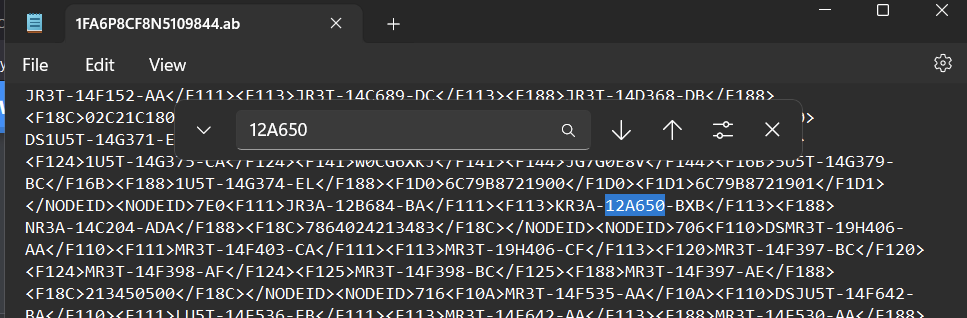

Can anyone help me with getting forscan to recognize my 23 Mach 1? It keeps asking for a pcm or tune number. TIA.

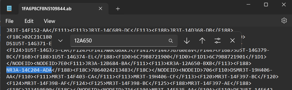

I'm gonna try to make this sound as basic as possible. So if you already know some of this stuff please don't take it as me being a dick - I'm not sure how familiar people are with computers and such.
Enter your VIN on this website: https://www.motorcraftservice.com/AsBuilt
It'll let you download the default asbuilt data from ford for your car.
Find the downloaded file in your downloads folder. It should be labeled "YOURVIN.ab"
Control + click on the file and choose "open with" and select the app "notepad"
Then when it's open hit "Control + F" for 'find' and a pop up will come up and allow you to type into the search bar
In the search bar type "12A650" - this is the base ford number for the PCM. It should highight a section of text in all the mess of data that you're looking at.
The number you want to use for PCM stategy is the set of numbers NEXT to the PCM number. I've attached a screenshot below of what mine looks like.
That number is what goes into forscan and allows you to read the PCM while tuned!
Let me know if you need help
This is what the search shows up with for MY car:
This is the number that you need to enter into Forscan (it might be a different number from what mine shows but should be structured the same) 'XXXX-XXXXXX-XXX'

Thanks so much for the help! Your images are broken links for me. I think I was able to get the PCM but just wnat to make sure I pulled the right numbers.

Check the images now. I just reuploaded them
