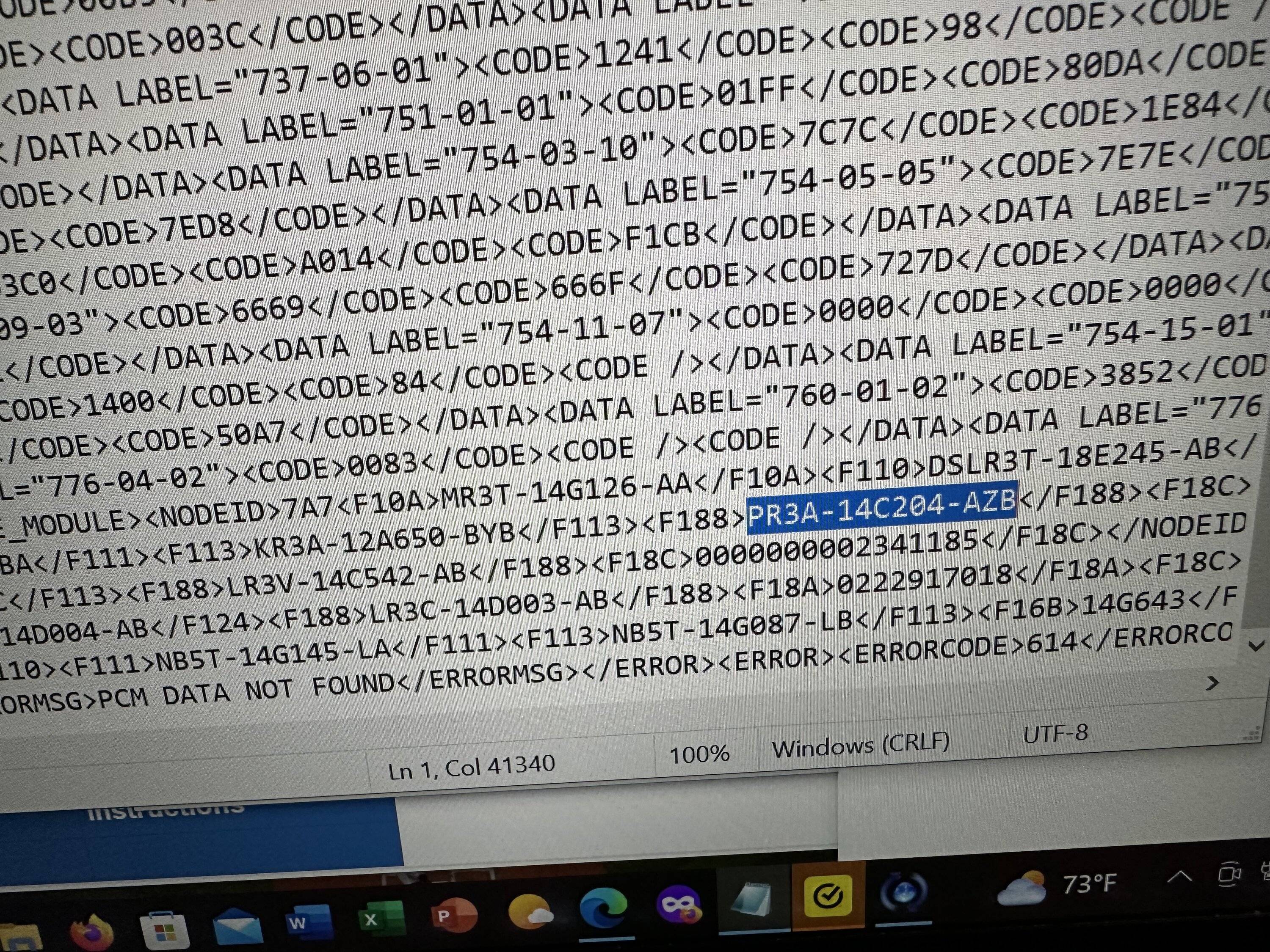

Check the images now. I just reuploaded them
Thanks I can see them now. So I put my number in and still says unable to identify vehicle. I attached a pic of the number I used.
