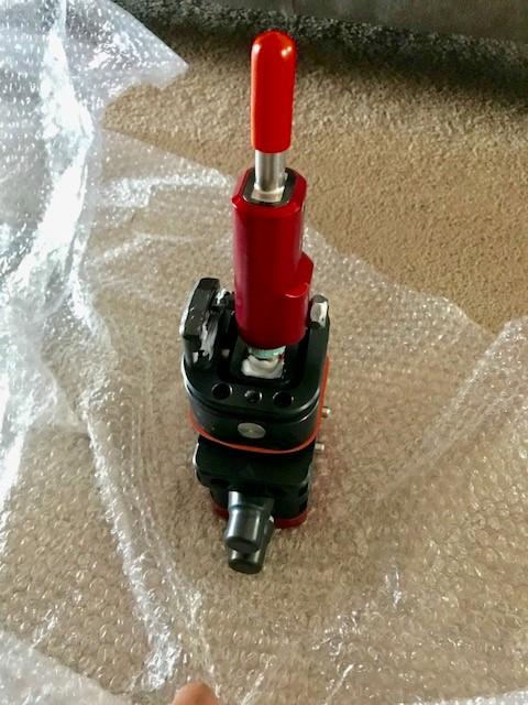

My mechanic and I had a little problem when installing my shifter. It only had one hole drilled deep enough for the rear support to go in all the way. He quickly drilled the other hole the same depth as the other and was able to finish the install with no other issue. Oh...I had to adjust the nut since it wouldn't go in into first gear, only to third at first.
Can’t picture where/what you’re talking about.
This is normal. They don’t come adjusted.

I can’t picture this either [MENTION=34715]GrabberBootyBlue88[/MENTION]. Are you saying you had to drill into the MGW shifter?
Drill into anything??

There are two holes for the rods in the shifter body that connects to the stock rear mounts. Only one of the holes were threaded all the way in.
The two holes above the 2 grey covers in the picture attached.
