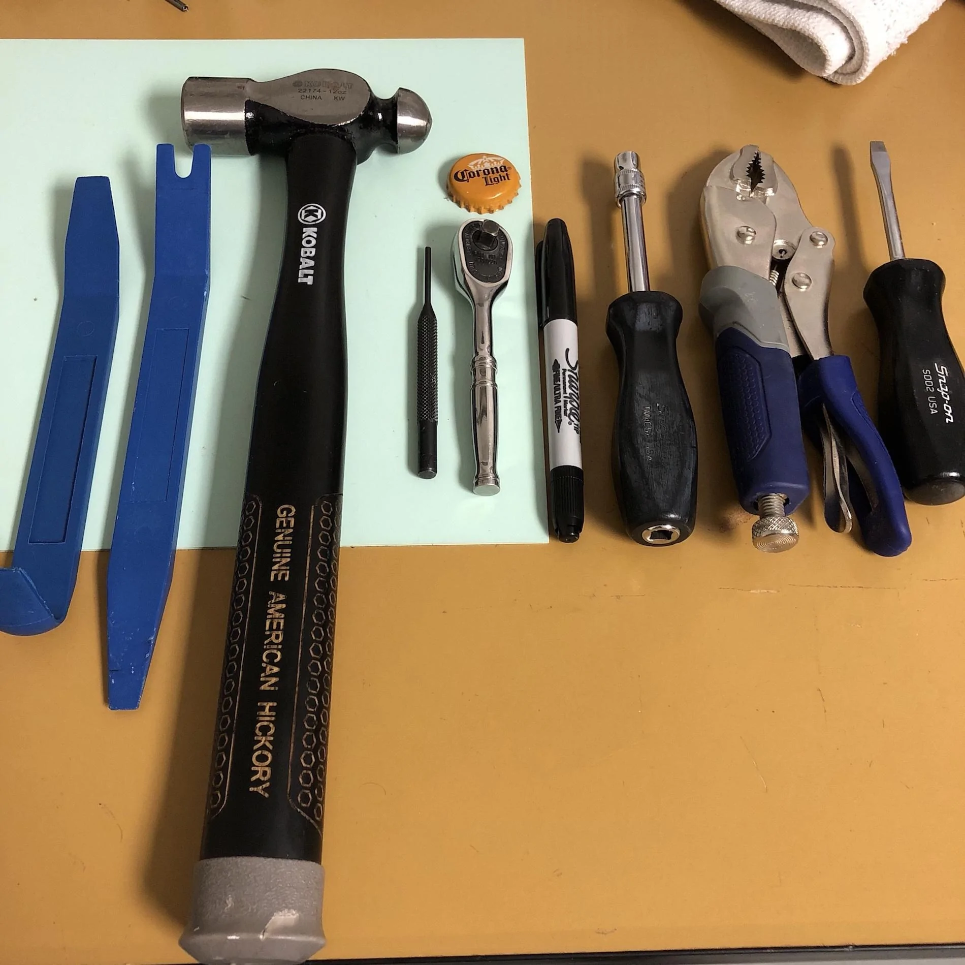

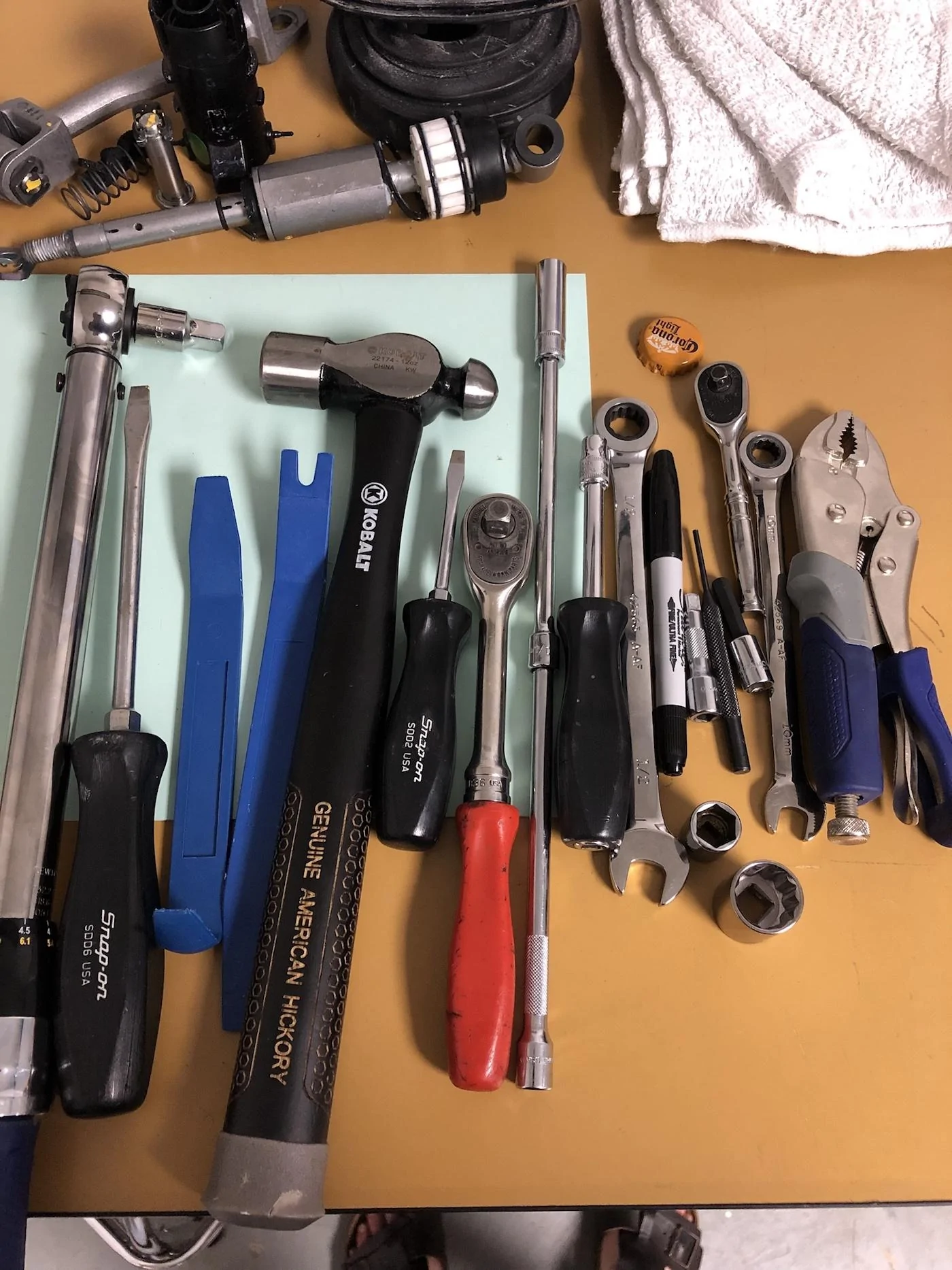

Tools used for interior disassembly:

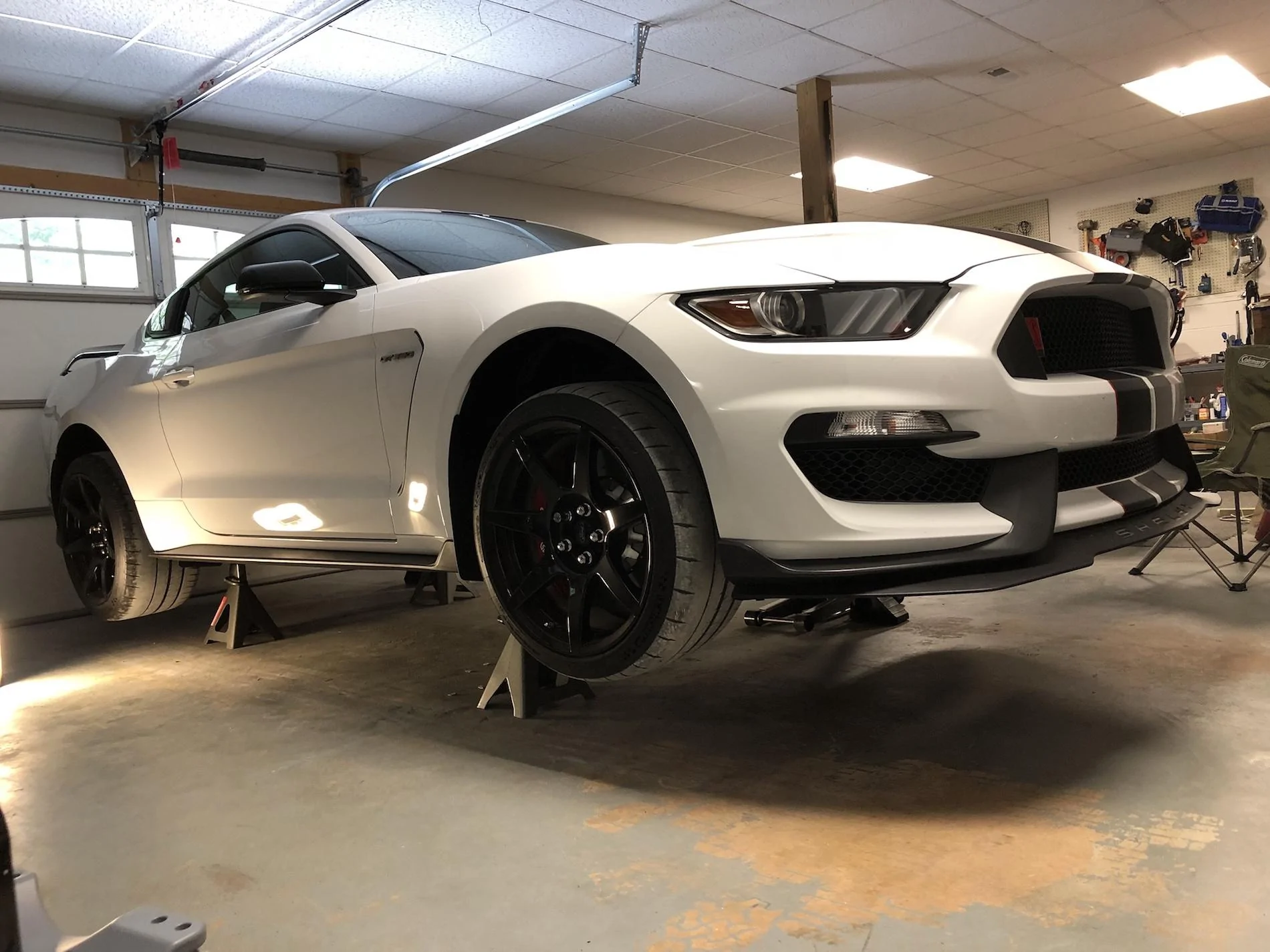

I put the car up on 4 jack stands in my garage and used a creeper for sliding around underneath. The picture will give you an idea of approx height:

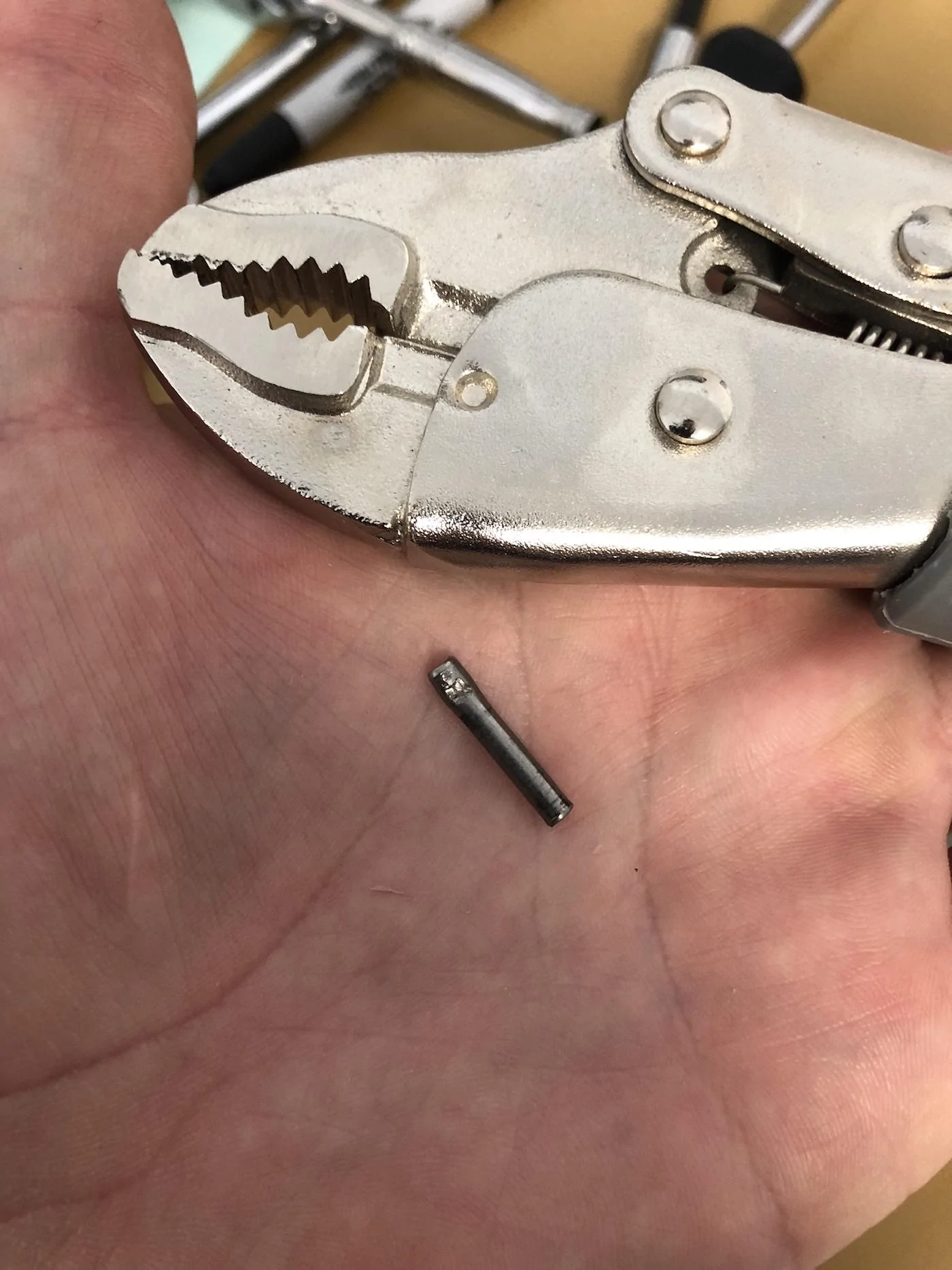

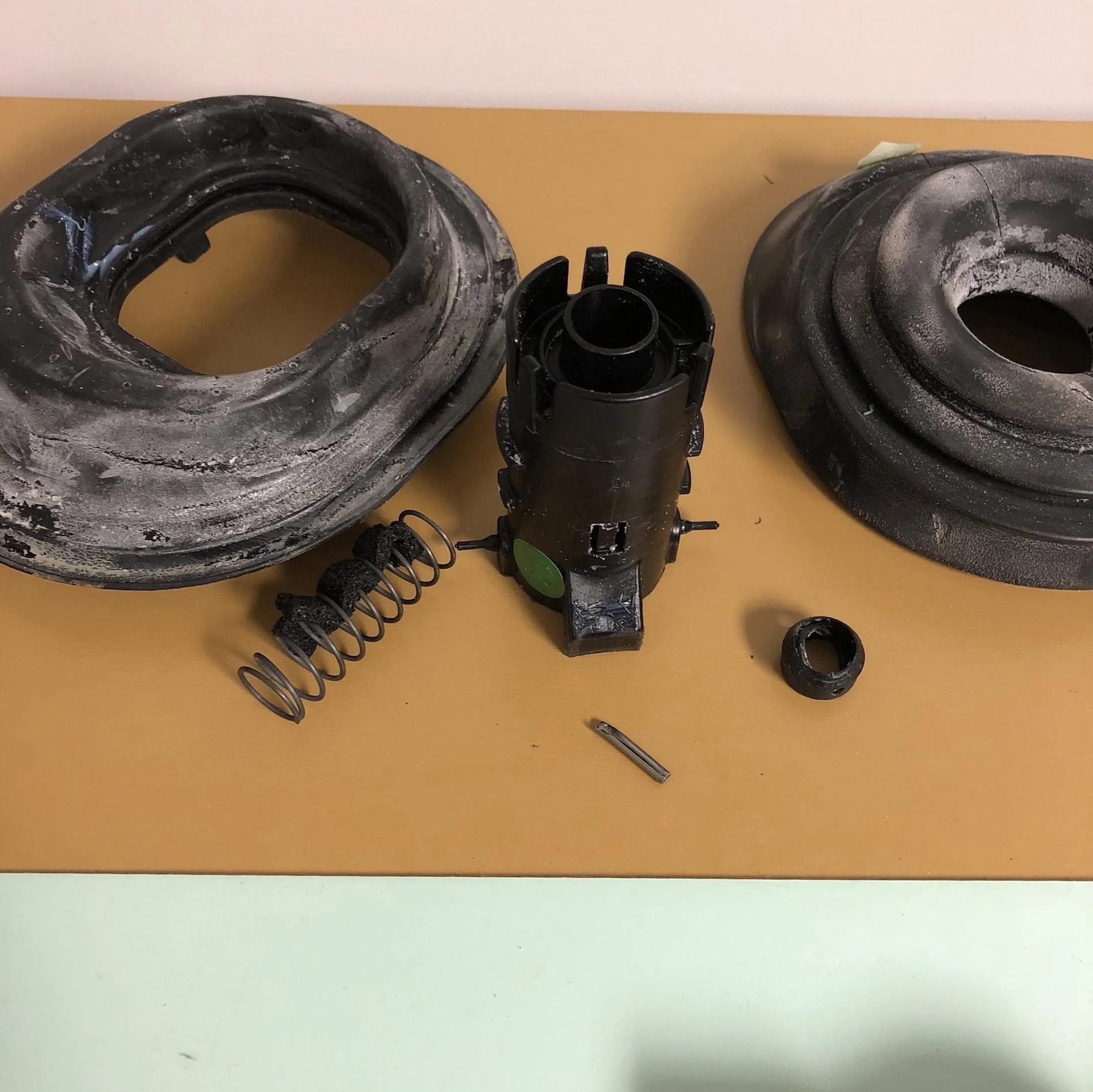

Interior components pulled out for discard. One thing to note here is that rather than beat the roll pin out of the shifter handle, I used vice grips to grab and pull. It seemed easier and less stressful to components.

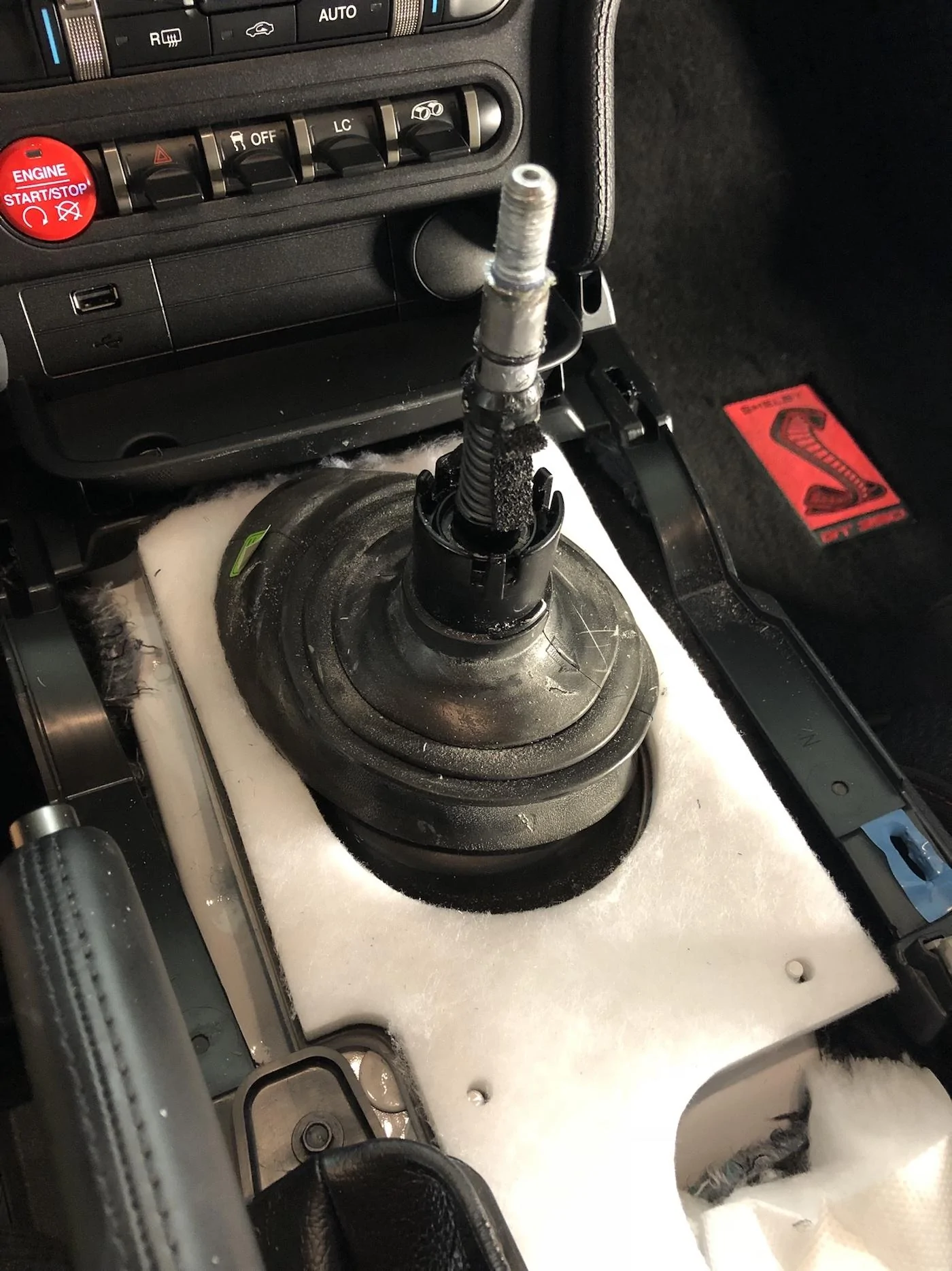

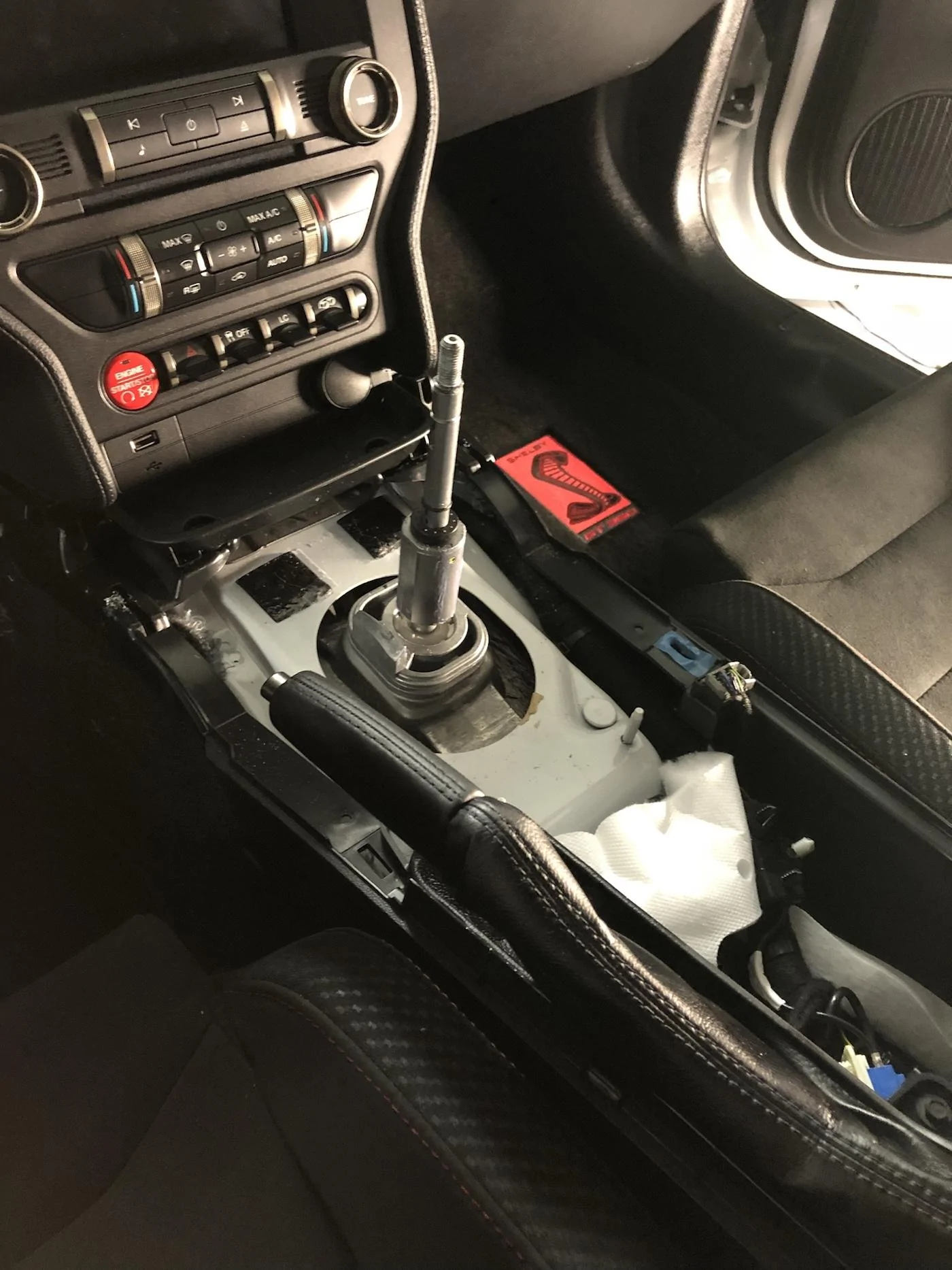

What it looks like once you're done with disassembly on the inside of car:
Underside disassembly was a breeze, taking no time at all. Here's an updated tool shot with everything that was used (including interior tools)

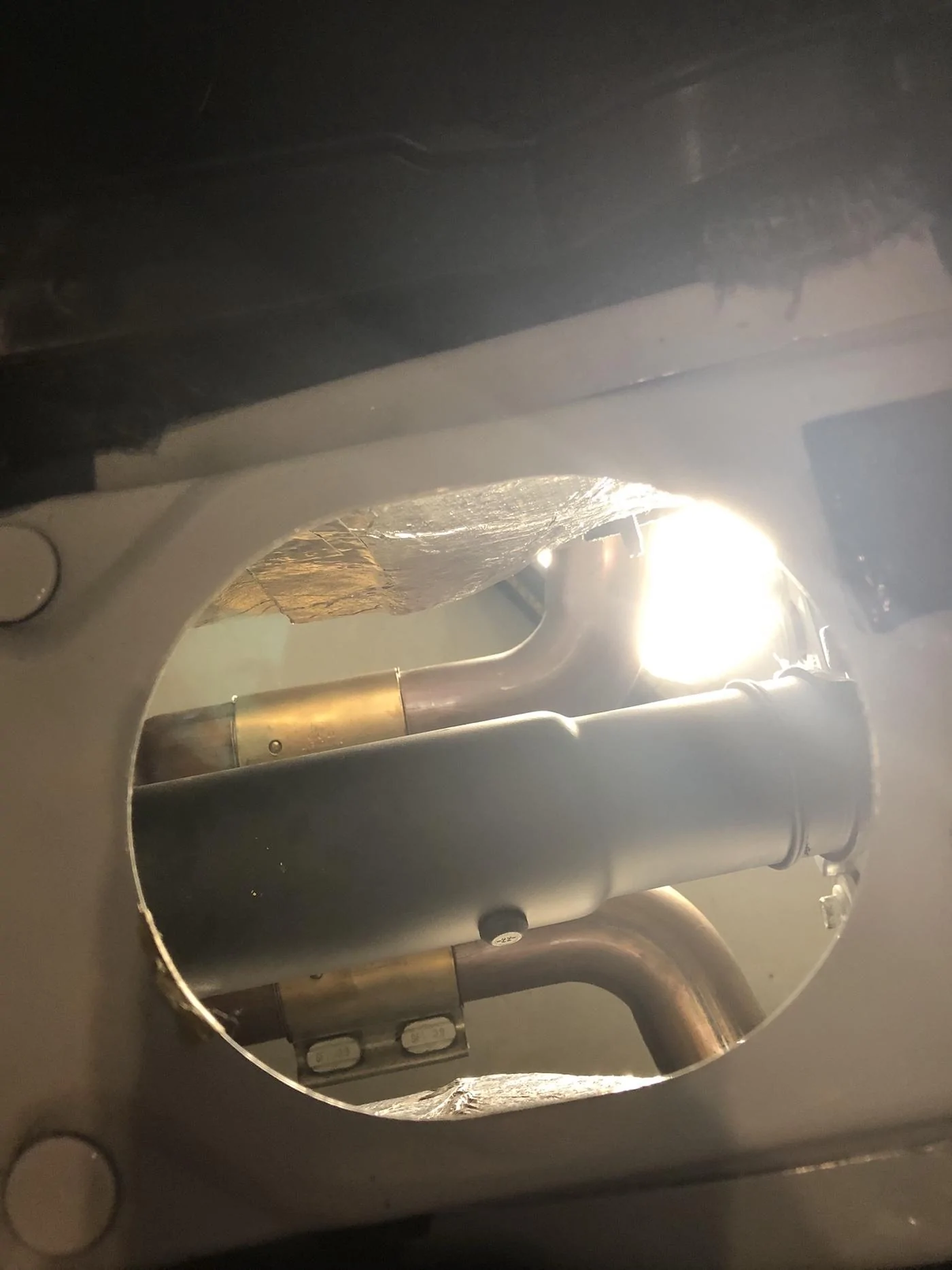

Big hole:

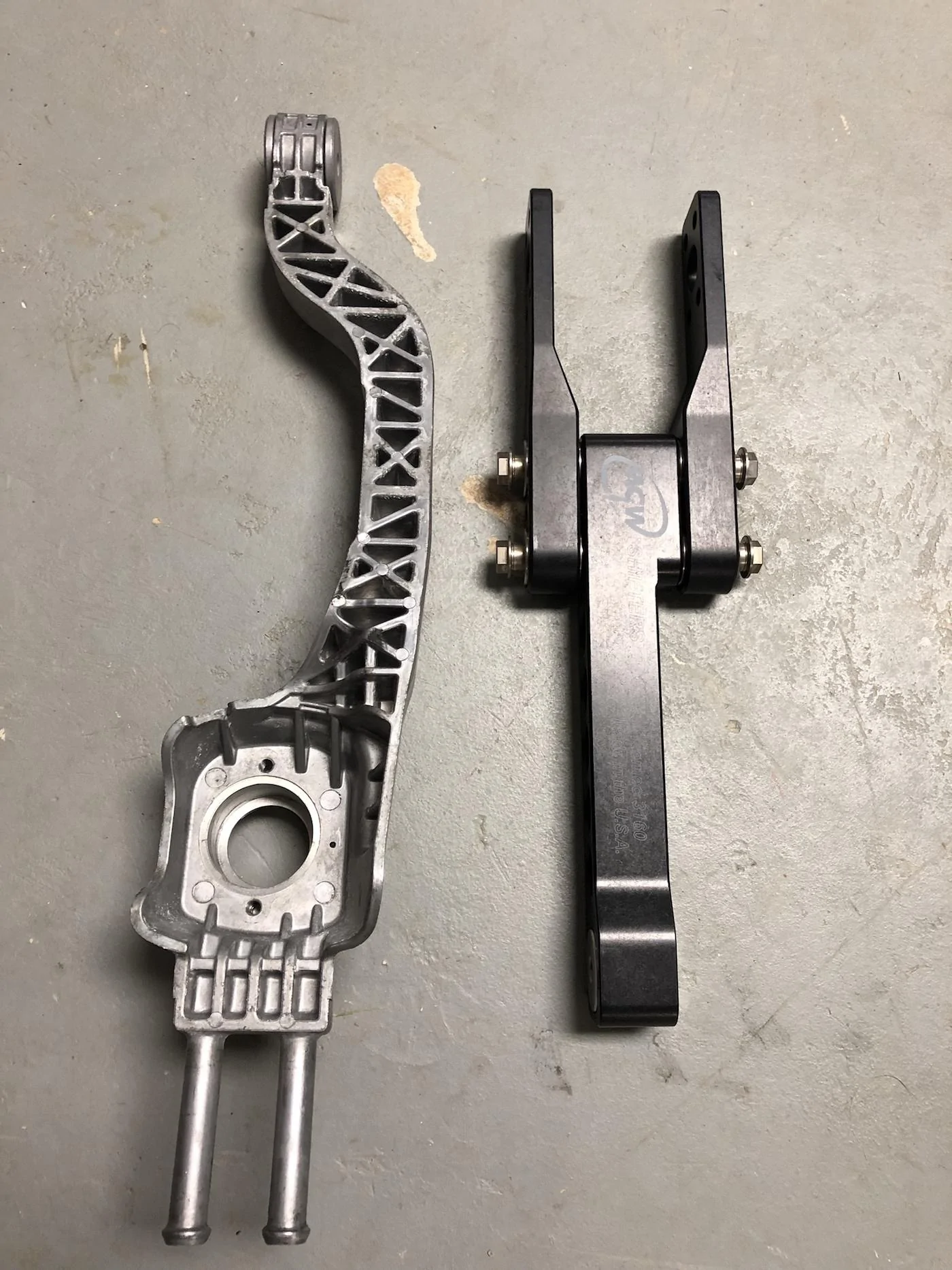

Side by side arms:

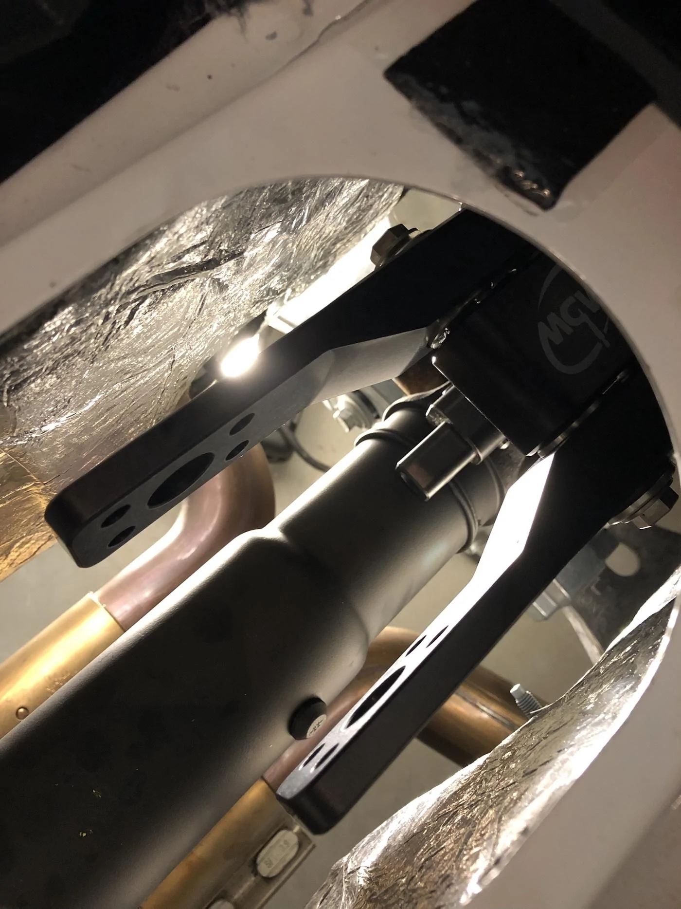

Linkage and arm installed. its the only part I thought was tight. Getting that long front bolt lined up and installed took a minute.
Dropped in the new unit:

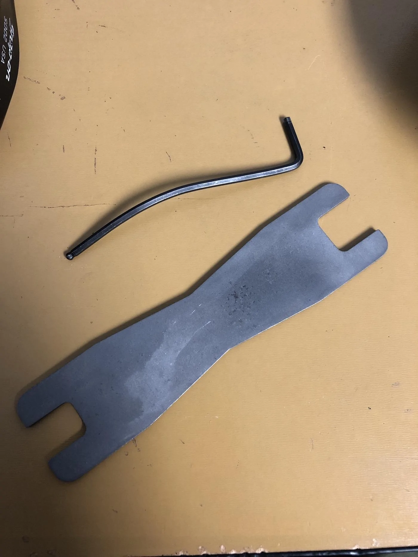

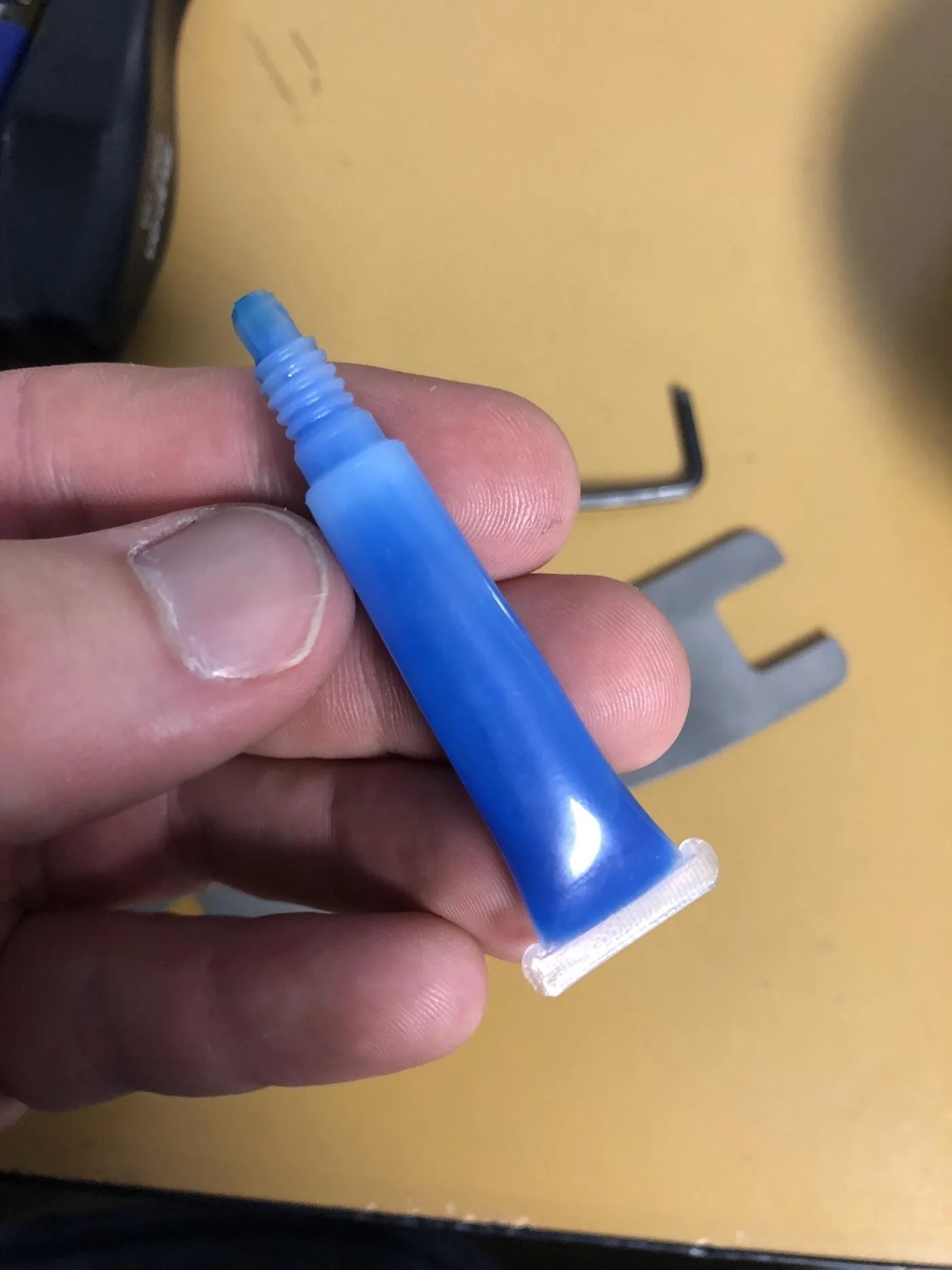

I adjusted the shifter as advised. Mine was not in calibration from the factory as the video states. IT WAS WAY OFF EXTREMELY TIGHT. This is the allen key that I sacrificed to adjust it:
Another thing I saw folks mentioning was a that there wasn't enough loctite. I had more than enough! Enough if not, its just standard BLUE found at any parts store.

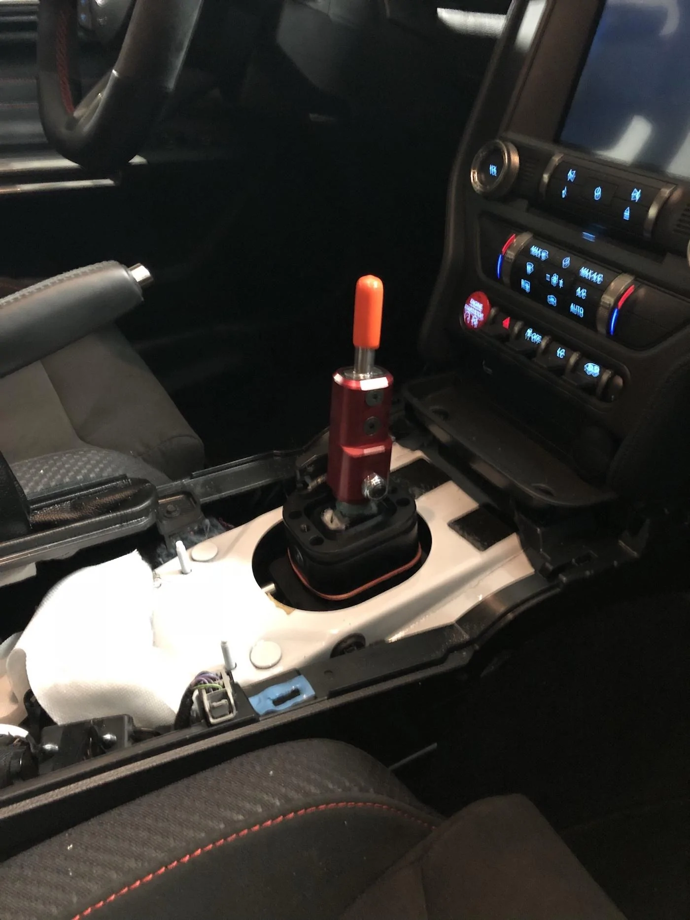

Overall, I enjoyed the install and give it a 2 out of 5 on install difficulty. It took less than 5 hours total and I wouldn't hesitate to do it again on the floor vs a lift. I encourage everyone to get the MGW. Its so much of an upgrade it makes you wonder how you've never had one before... I forgot to take a pic of the finished product lol. I'll add one later.:cheers:
finished:
