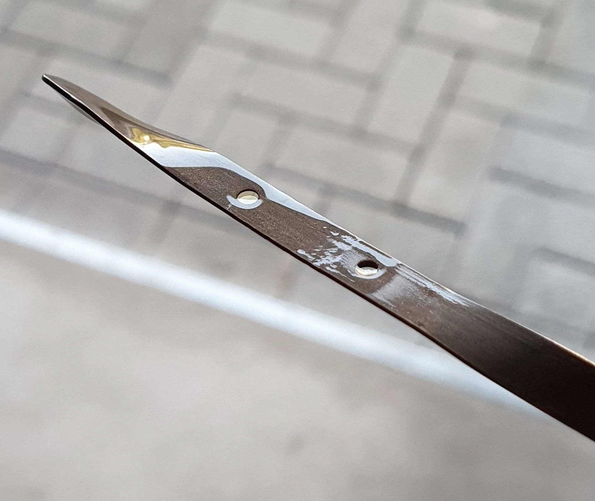

Hi folks,
I found the thread as I am dealing with the exct question - what is the correct oil level when hot/cold.
I have been a the Ford dealship for an oil change - and this morning when the engine was cold I checked the oil level :
It is at the top hasmark - prolly a tiny tiny tiny bit above the the hashmark (see the picture)
Would you guys consider it as ok - or overfilled ?

Hi folks,
Did you happen to check it 15 minutes after you parked it at home? Curious where the level was.

Hi folks,
Looks ok to me. I wouldn't touch it.

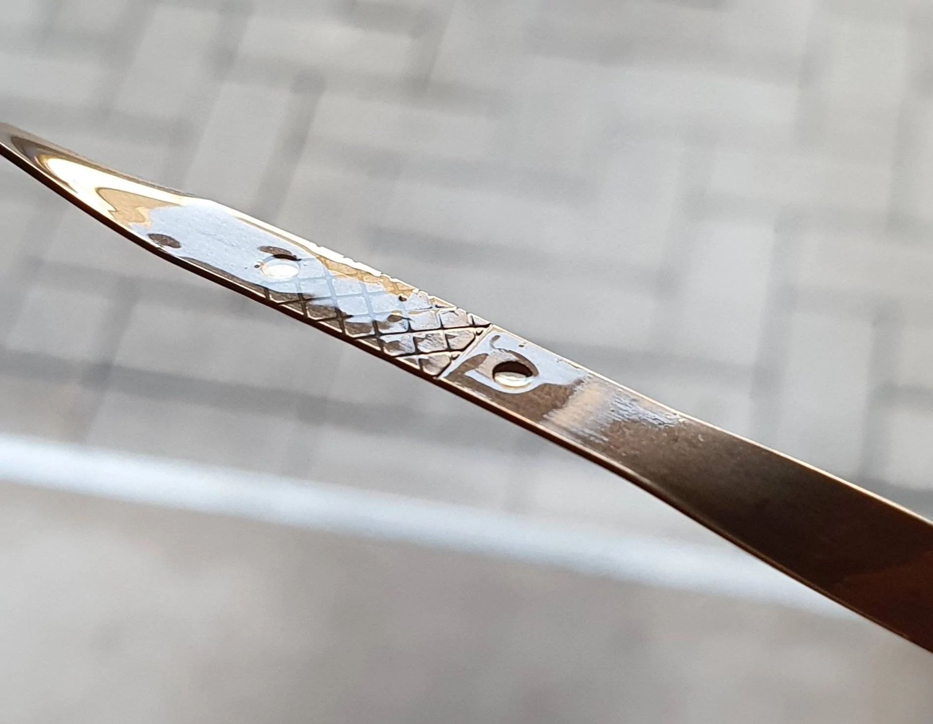

Not yet, I will do so this afternoon (I am located in Germany - so don't worry :-D)
I will check it in the same place and take a pic.
EDIT : I guess it will reach until the upper hole - hope it will not exceed it.
Next question : What is the correct direction for the disptick to insert - the hashmark showing on the upper side (towards the passenger side) or the hashmark on the lower side (pointing to the driver side)
My picture was taken with the hashrmark on upper side - pointing to the passenger side)

It really does not matter which direction you use.

So, Ford's instructions are that "full" is anywhere between the two holes. That means that the hash marks don't count - maybe they're for a different engine or something. What you're seeing on the dipstick after an oil change is what we all see - solidly between the holes and maybe slightly above the hash marks that don't count.
The way I manage my oil level - my car consumes about a litre every 3,000 km - is to check it occasionally hot or cold and add 1/2 quart or litre when it gets close to the lower hole. It doesn't matter if it's hot or cold that way - it never gets too low, and because you're only adding half a bottle, it never overfills either.
Which ever one makes you feel better! Seriously!

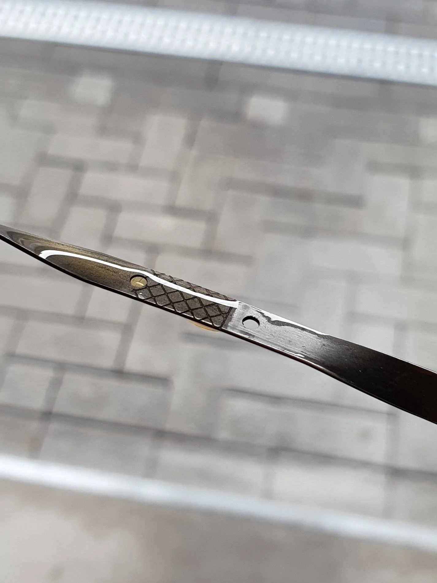

So, back from a 45 Minute drive - motor still warm the car was sitting for 15 minutes in the garage - and here you go :
I am not sure but somehow I am far away from being happy :crazy: At least this is what they call : Do not add any oil.
But is it already too much ?

Don’t sweat it. It’s not enough to matter.
It's fine - don't worry about it. The patchy coverage at the very top could just be pickup from inside the tube - it doesn't get solidly covered until below the upper hole.
