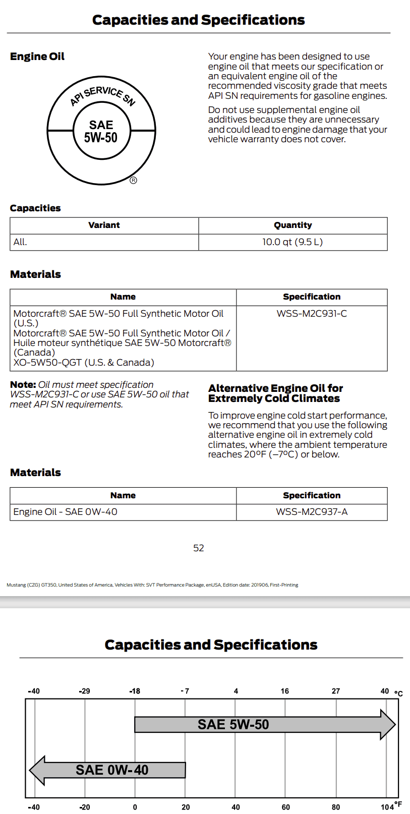

I think I would use 0w40 oil in the winter if it gets relatively cold where you are, amsoil signature series or pennzoil ultra platinum. I also add ceratec

Just an update. I sent my oil sample to blackstone and have observed that lead levels went back down (8 ppm this time) but potentially due to my idling in the morning there is no trace level fuels in the oil and the oil flashpoint/viscosity have both gone down. I have now started to reduce the cold start wait period to only to wait for CHT to reach 70F and drive off keeping revs below 2000 rpm until CHT reaches 150F and oil reaches 100F. Let's see how the modified driving behavior helps/hurts the metals.
