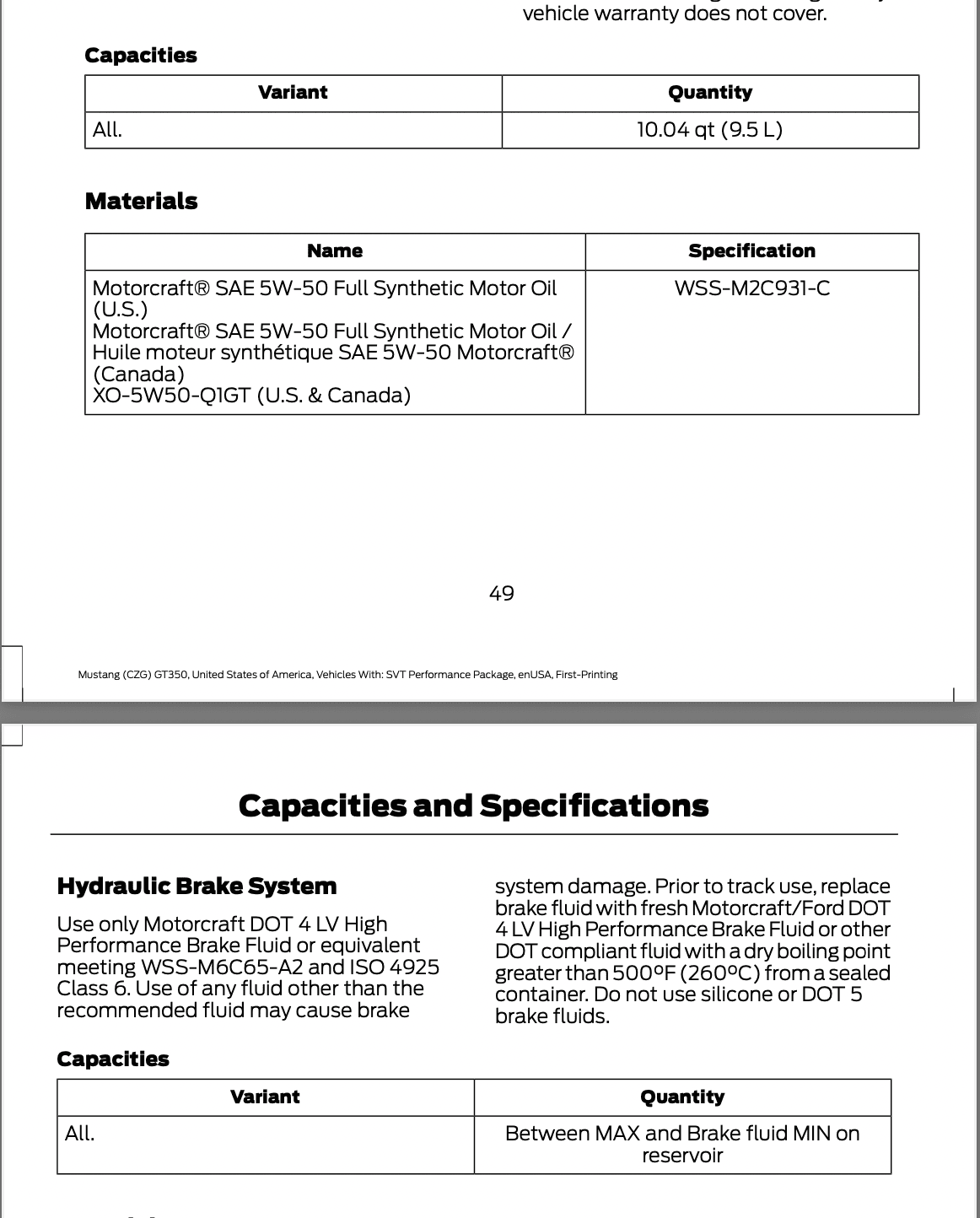

For the GT350 yes, 5w-50 synthetic is the only oil that ford recommends under all conditions. They do have recommendations for changing the oil sooner if you operate in certain conditions though.
Yup, stand corrected, just looked it up, thanks

Interesting, I looked in my '19 manual and didn't see the 0w40 recommendation. Any chance you can copy/paste it? Makes sense.
