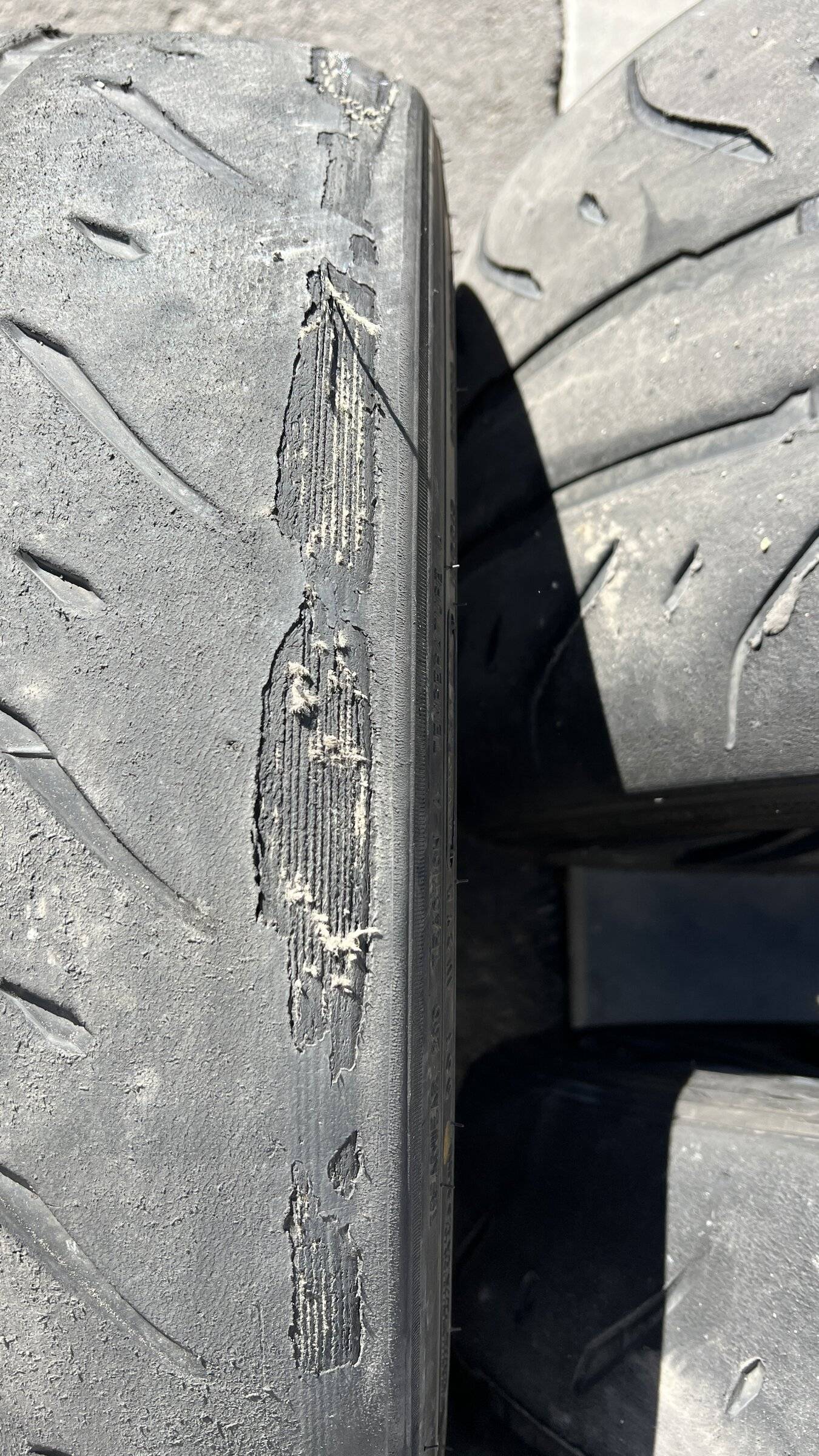

Camber doesn't hurt tire wear so set it as aggressive as you want for the track and leave it.
I wanted to believe this years ago, but it’s just not true on heavy, high HP cars driven at/near the limit at very high speeds (and the resultant heavy braking, which I think is the culprit). I run -4.25 up front, 0 toe w/ spherical bearings (no rubber = no movement under heavy load), and ABS. Here’s what my inside fronts looked like (note the usable tread left elsewhere), after excursions at UMC and LVMS (as well as concrete autox/prosolo exposure at Lincoln and Crows Landing):
I guess I could've put more detail into my overly-generalized statement.
The point I was trying to make is that track-oriented amounts of camber will not be overly detrimental for street miles. The effort required to switch back and forth between street alignment and track alignment on a mostly street driven car is not worth while, in my opinion. Toe will kill tires much much faster on street miles than camber ever will.
