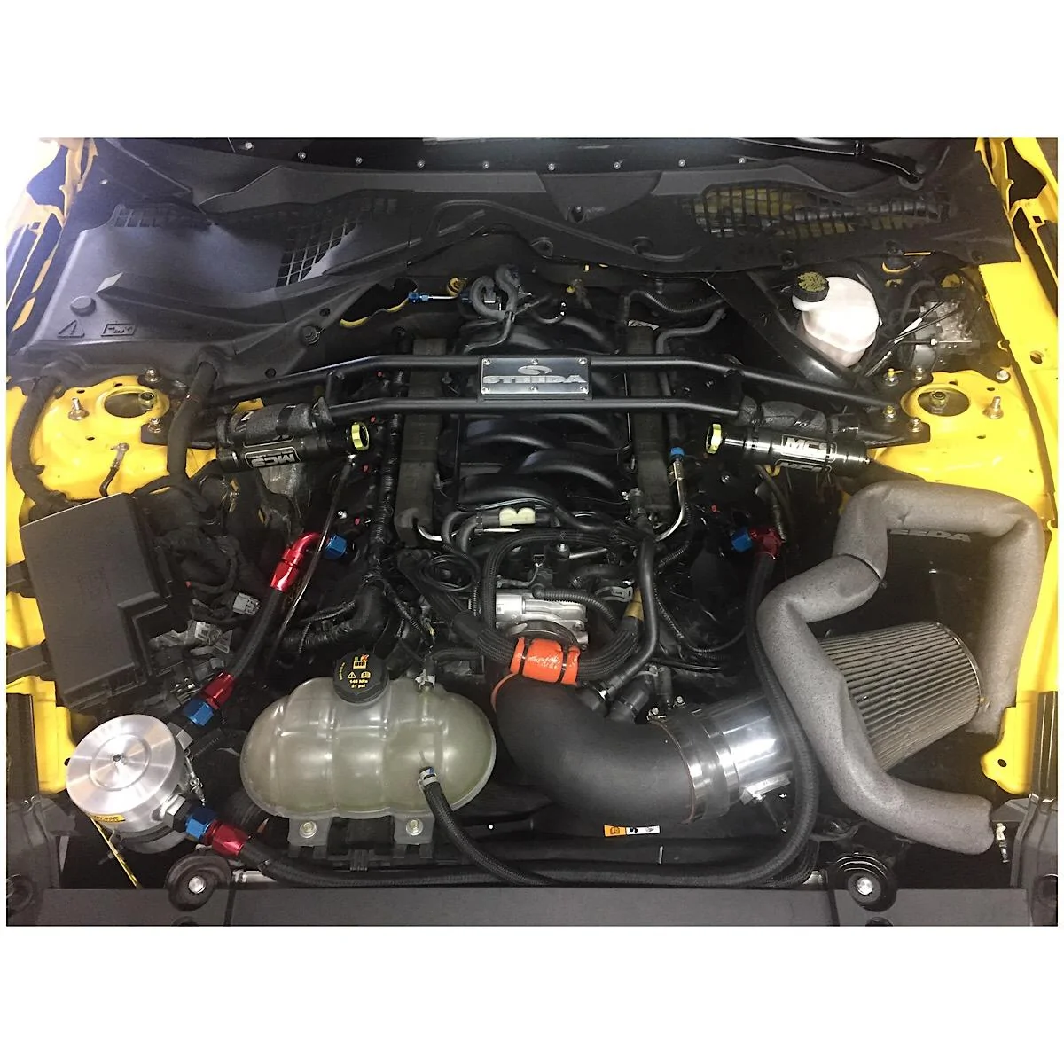

Steeda's Sloution
Under hard core road racing and HPDE events you will push oil out because of the excessive windage at high RPM. It also has a simple return line back to the pan.
Contact Mike D @Steeda for further info 954-960-0774
What separator setup is this?
