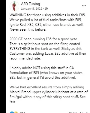

The reason for the regular gas every oil change interval in the F150 is for lubrication. Also, would suggest not using the Lucas based on this:
They recommend MarvelMysteryOil instead. I add a few ounces every couple tanks and havent looked back
Glad I read this. I have a bottle of Lucas injector cleaner on hand now. I definitely won’t be using it in my Mustang.

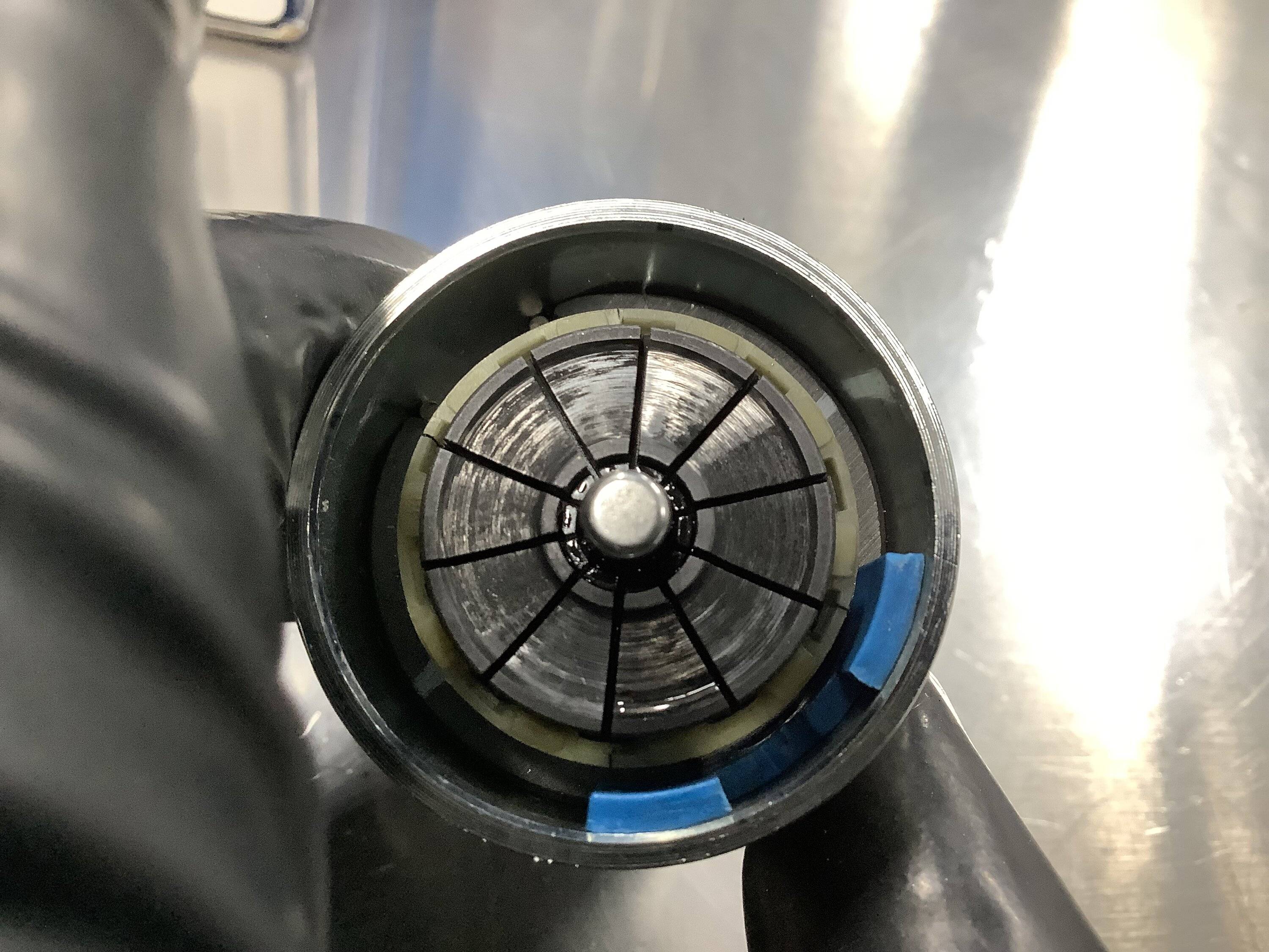

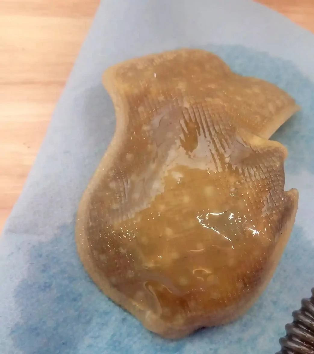

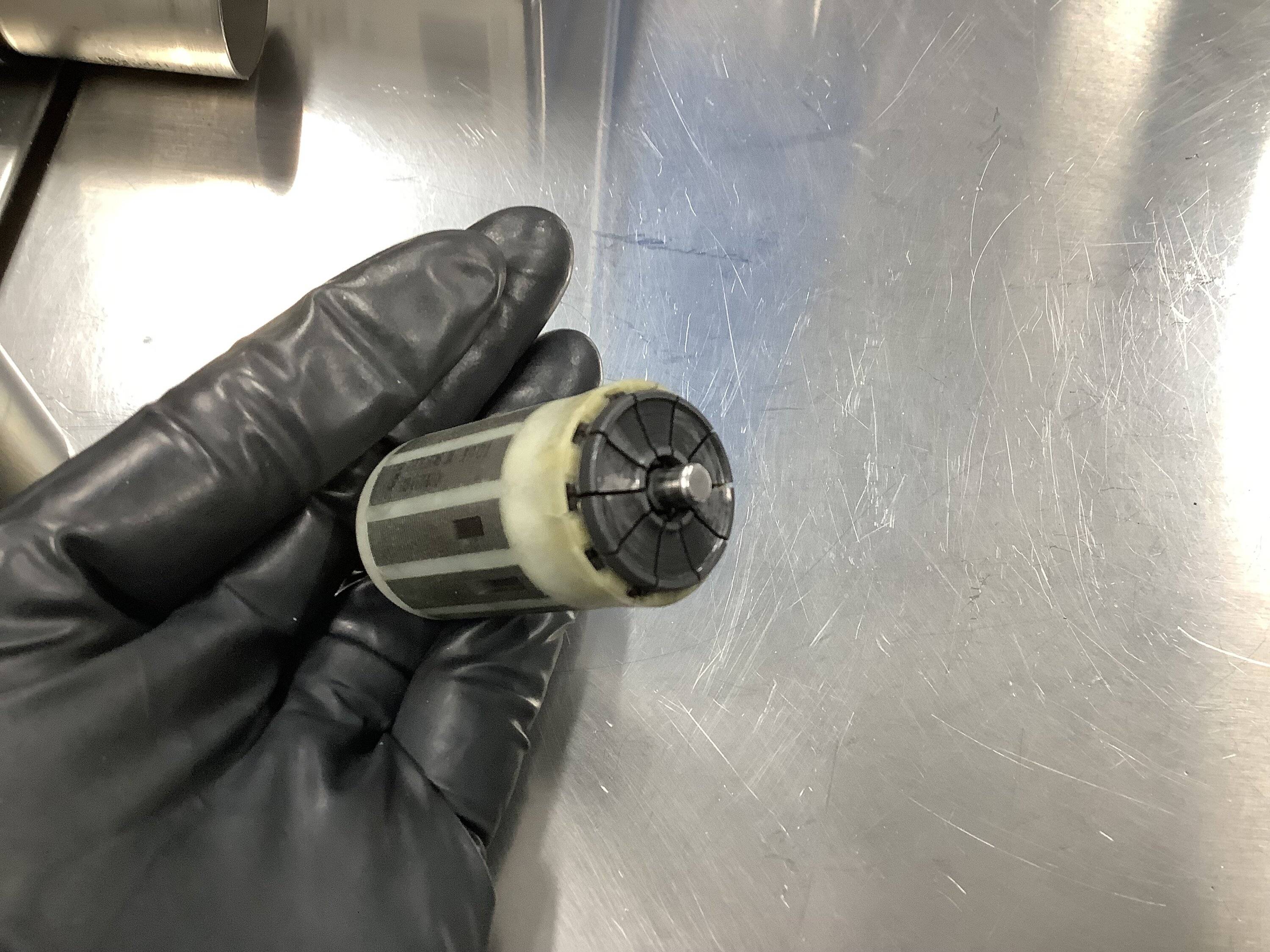

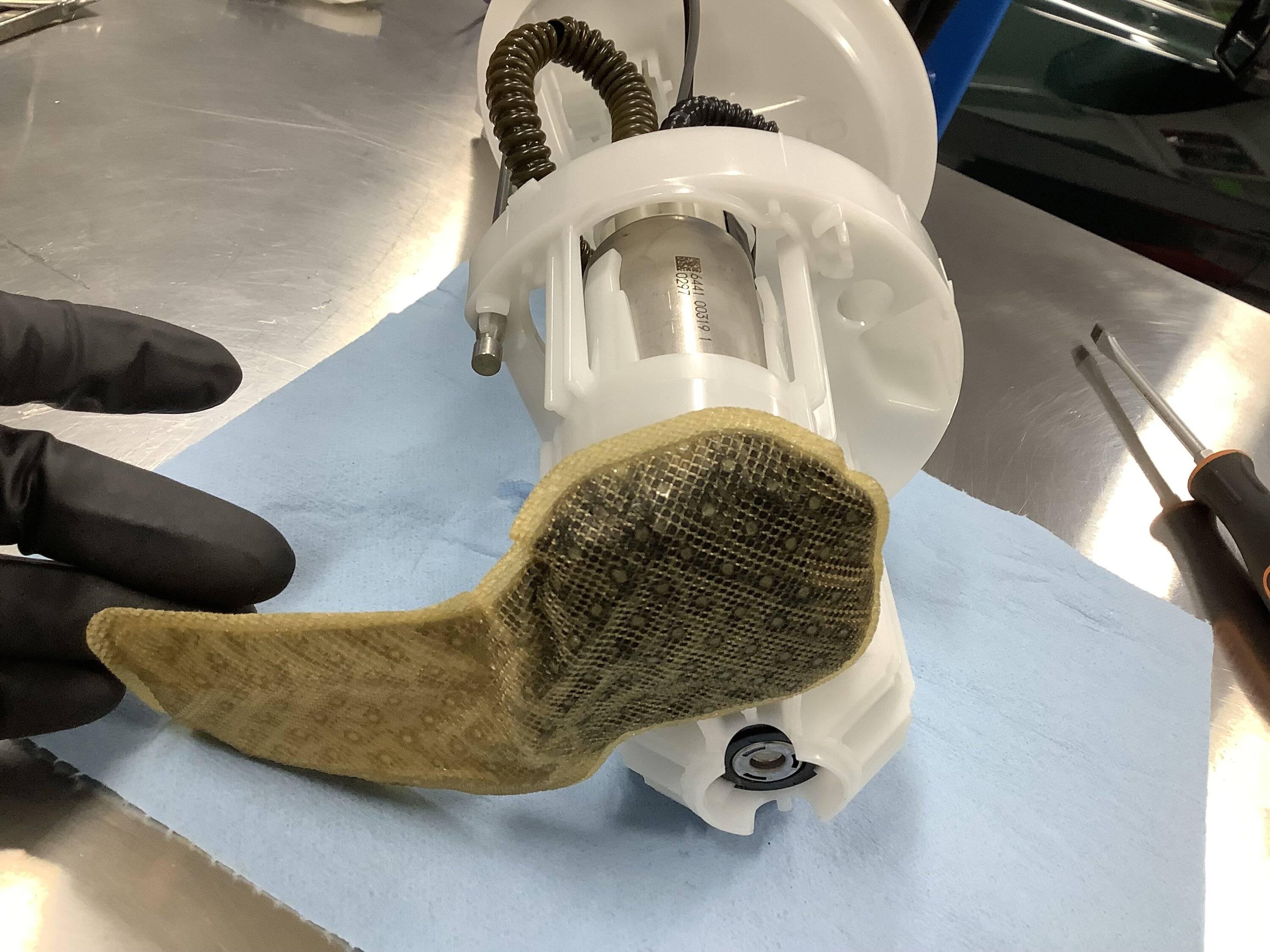

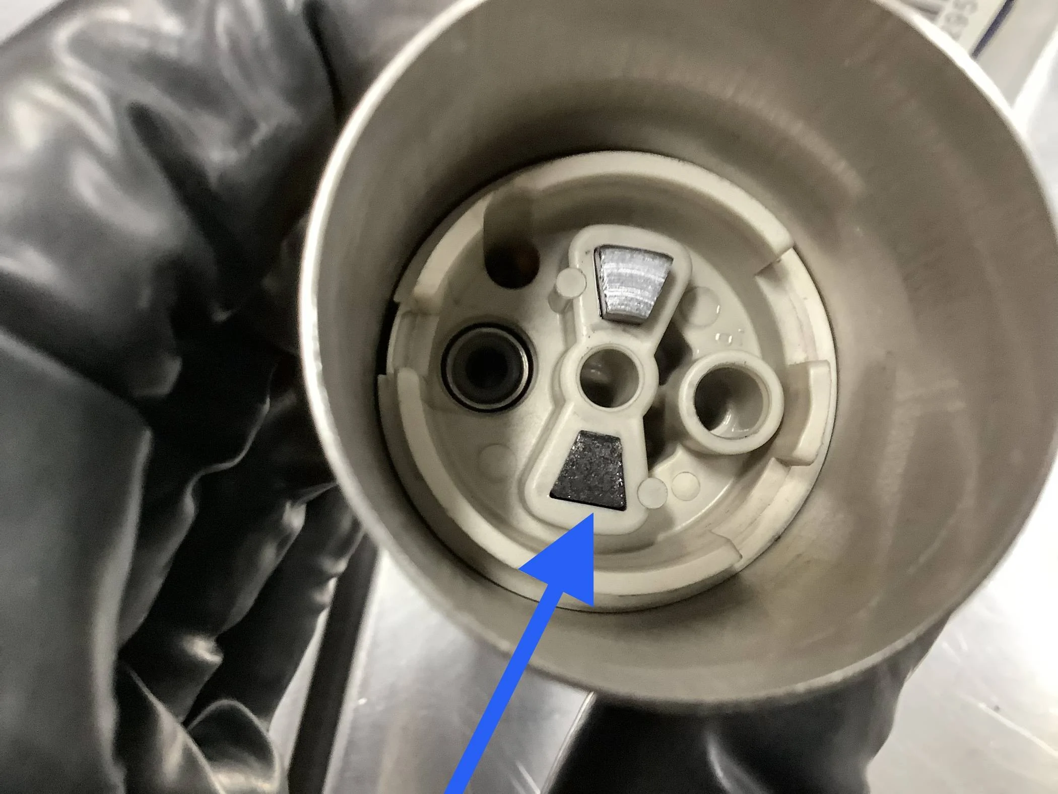

I did just clean my injectors two weeks ago and replaced the factory fuel pump which burnt up on me (with no warning) while I was out on a drive. Had to get towed home from a busy intersection.
I cut the pump open to inspect it and found that the brushes had burnt up inside. The sock filter was also dirty with 6900 miles on the car and 3 years of running E85. I should also add that I was running a JMS BAP which wasn’t boosting voltage constantly (only when at 50% throttle or more).
