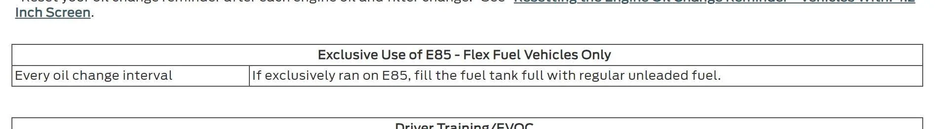

Ooh I found this in the F150 manual
seems that 93 every 10th fill up might be a little excessive lol

The reason for the regular gas every oil change interval in the F150 is for lubrication. Also, would suggest not using the Lucas based on this:
They recommend MarvelMysteryOil instead. I add a few ounces every couple tanks and havent looked back
