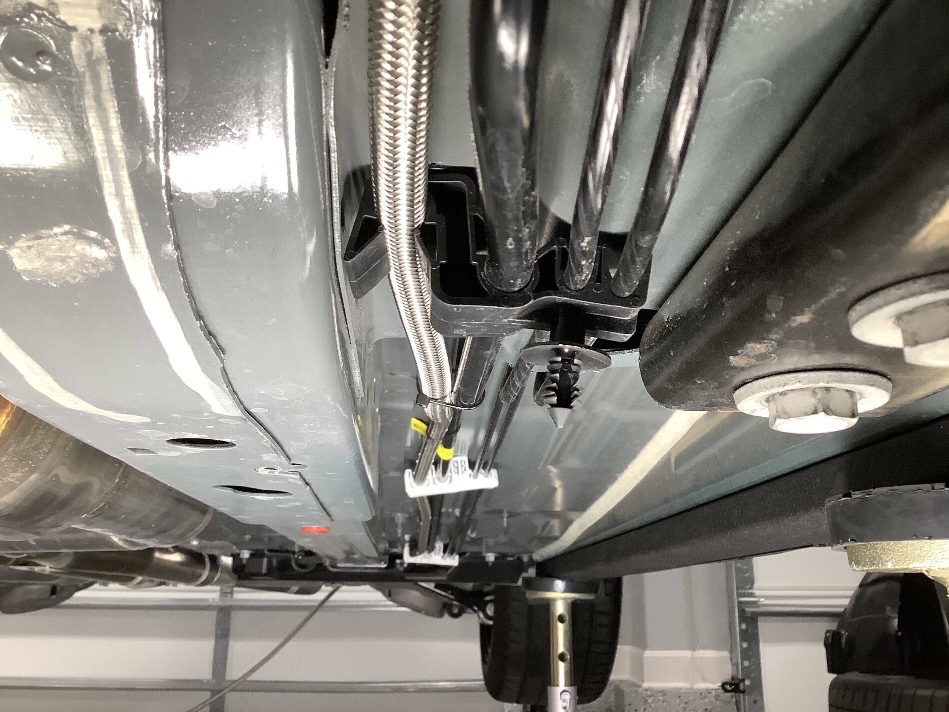

What replacement fuel filter are you using when running E85? This is a piece of maintenance that I haven’t done yet on this car. Is it located on the fuel pump itself? I recently reviewed the thread about the mystery goo balls. Would like to stay ahead of this if possible. Current mileage is 6800.

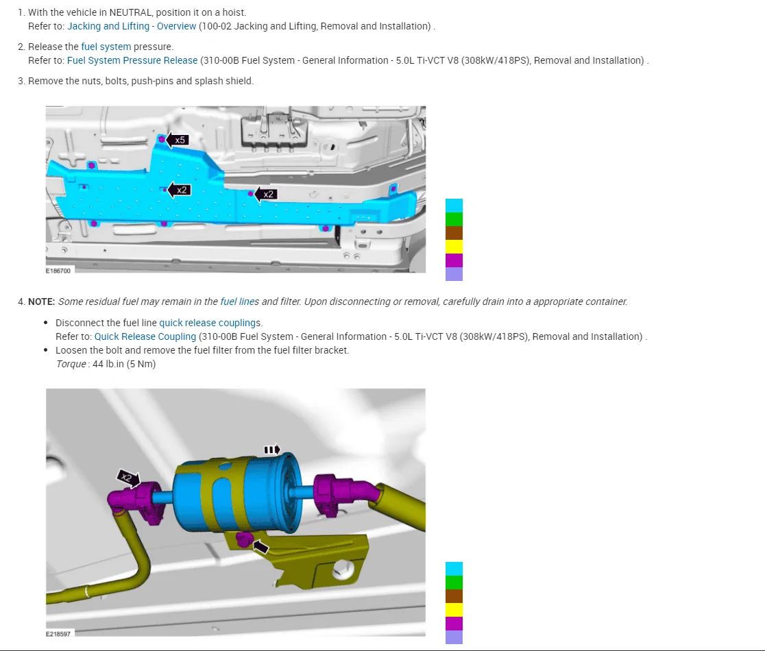

There is a fuel filter its under a splash shield near the middle of the car on the bottom.
Disconnect the FPDM, start the car when it stalls, jack it up and remove the filter, replace, reconnect FPDM, cycle the key a few times and start it up. This is what the service manual says to do.

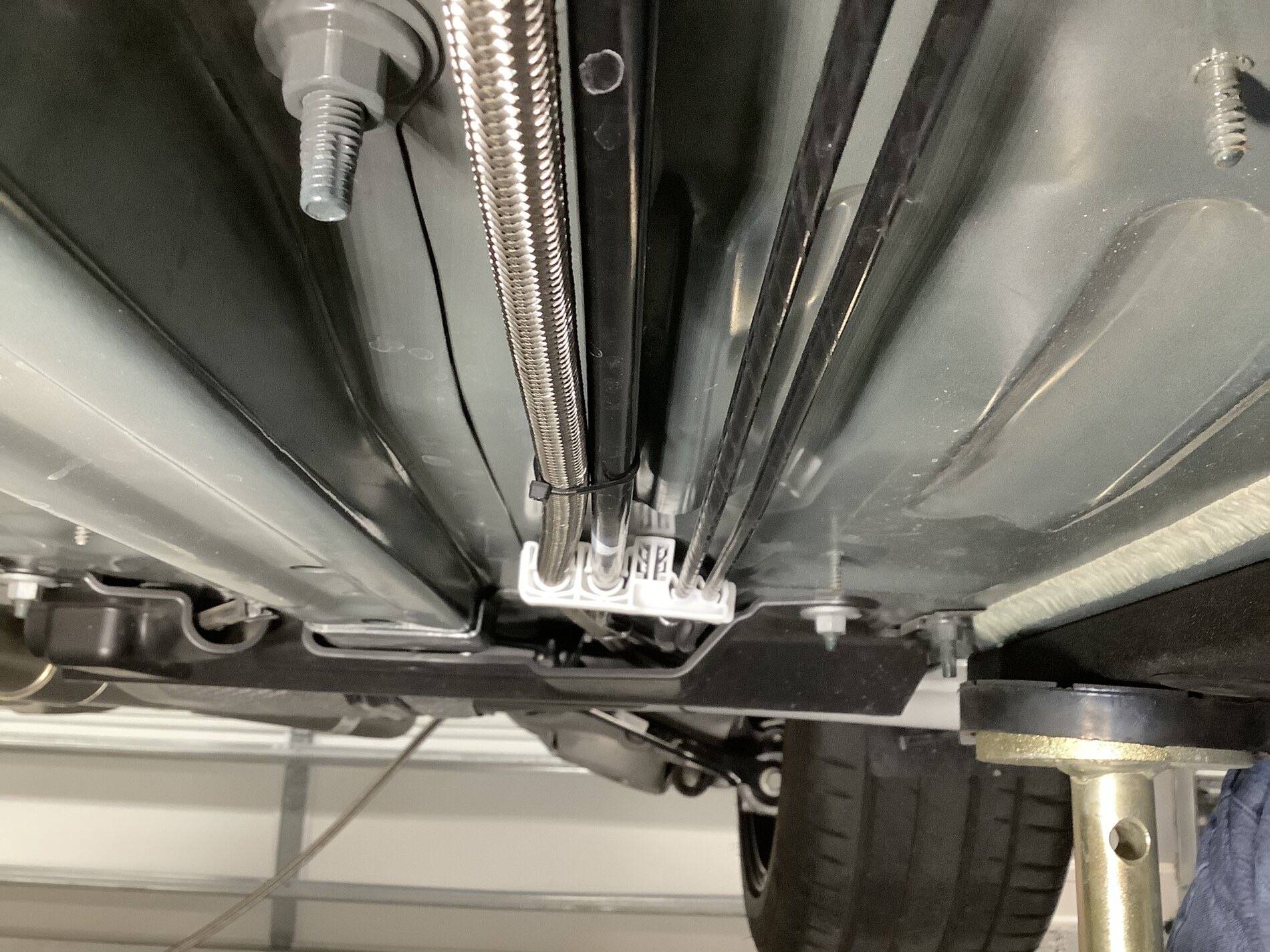

I didn’t notice a fuel filter in that area on mine when I had that cover off to run my nitrous line. I may have to take a second look, but I’m pretty sure I didn’t see one.

I saw a page from a service manual with an illustration just like that as well, but it only referenced the 5.2 engine.
That must be it, I bought a subscription specifically for the 5.0, but its totally possible that they got confused while writing it.

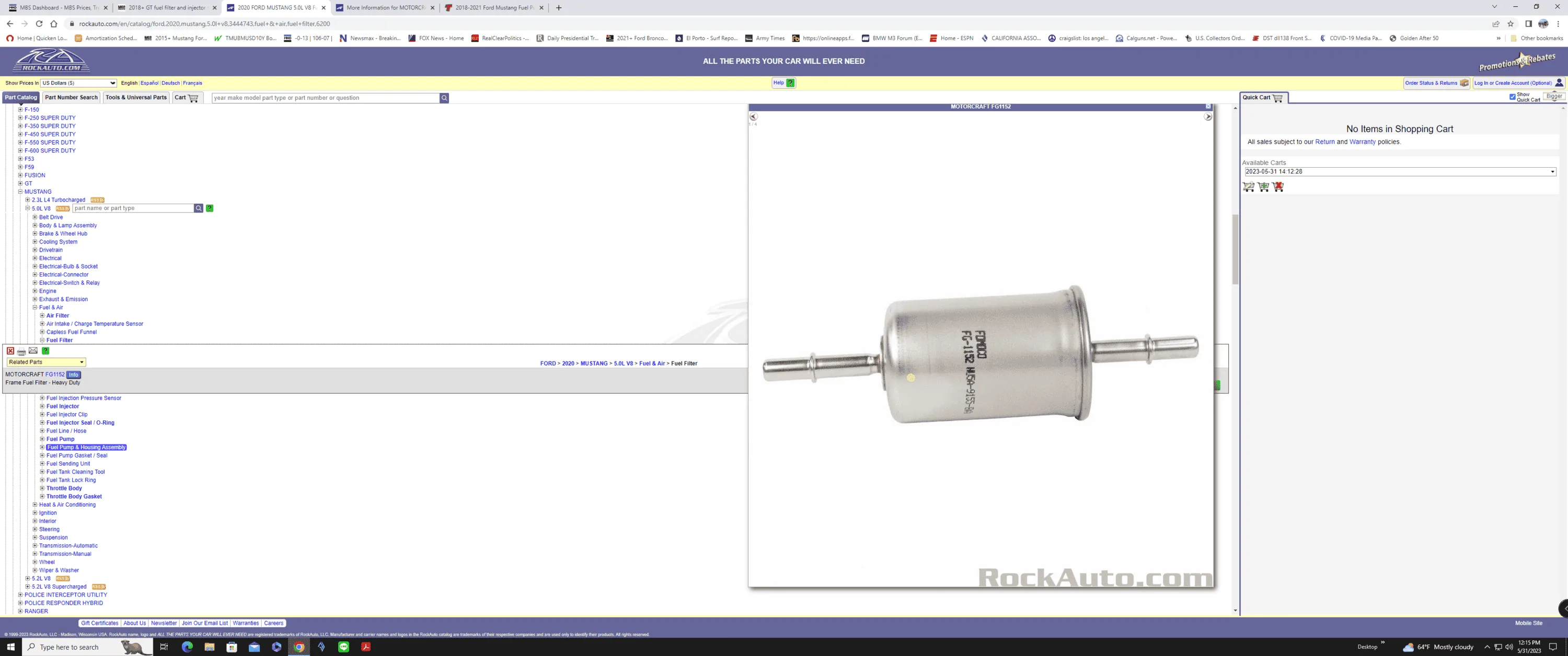

Dave2013M3
Aug 22, 2014
92
3,731
3,458
El Segundo,Ca
2024 BMW M2 G87 6MT Toronto Red, 2025 Ford Bronco Badlands 2dr. 7MT
Just went on Rockauto.com and they are showing a fuel filter.
Interesting.
Dave2013M3
Aug 22, 2014
92
3,731
3,458
El Segundo,Ca
Just went on a few auto parts stores and they are showing one as well. Not showing the position though.
engineermike
Jul 15, 2018
6,302
6,630
La
2018 GTPP A10
That filter is for the 5.2’s only. The 5.2’s have dual pumps so there isn’t room for a filter inside the bucket, thus the filter under the car. The gt filter in the bucket isn’t replaceable.
