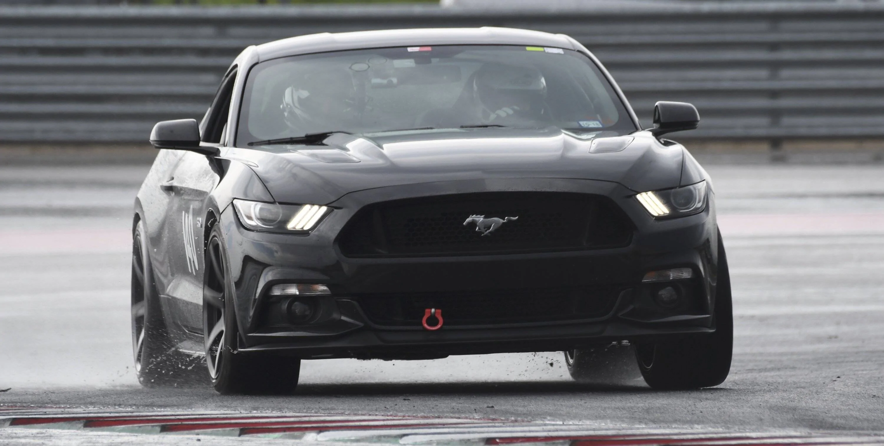

Yeah the difference at the outside fender between a 11" ET50 wheel and a 10" ET35 is only 2.3mm. From the sides they look the same. I daily on square 285/35R19s on 19x10"ET35 wheels and no regrets. Being able to rotate with identical wheels and tires on all four corners just makes everything easy.
With the right parts (extended studs, slip on spacers, and camber plates), you can run a 305 tire on a 11" wheel on all four corners. That's completely overkill on the street for most people, but a lot of us track like that..
This, however, is just the daily square 285s setup, with a little bit of extra front camber.
