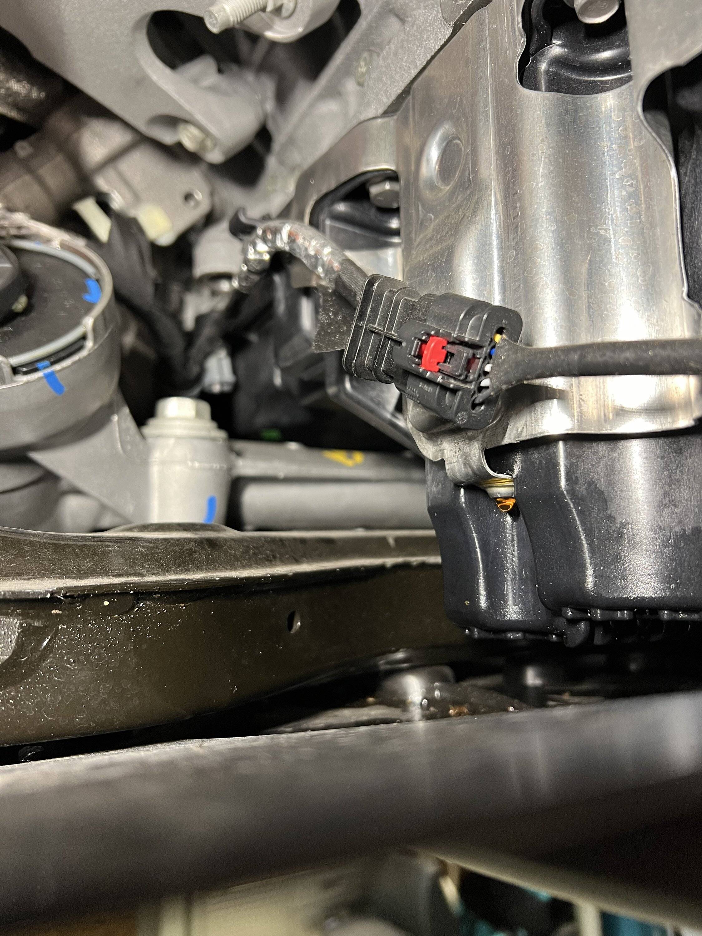

BTW - my original oil pan, which leaked from day 1, was diagnosed as leaking at one of the wire harness bracket attachment points.

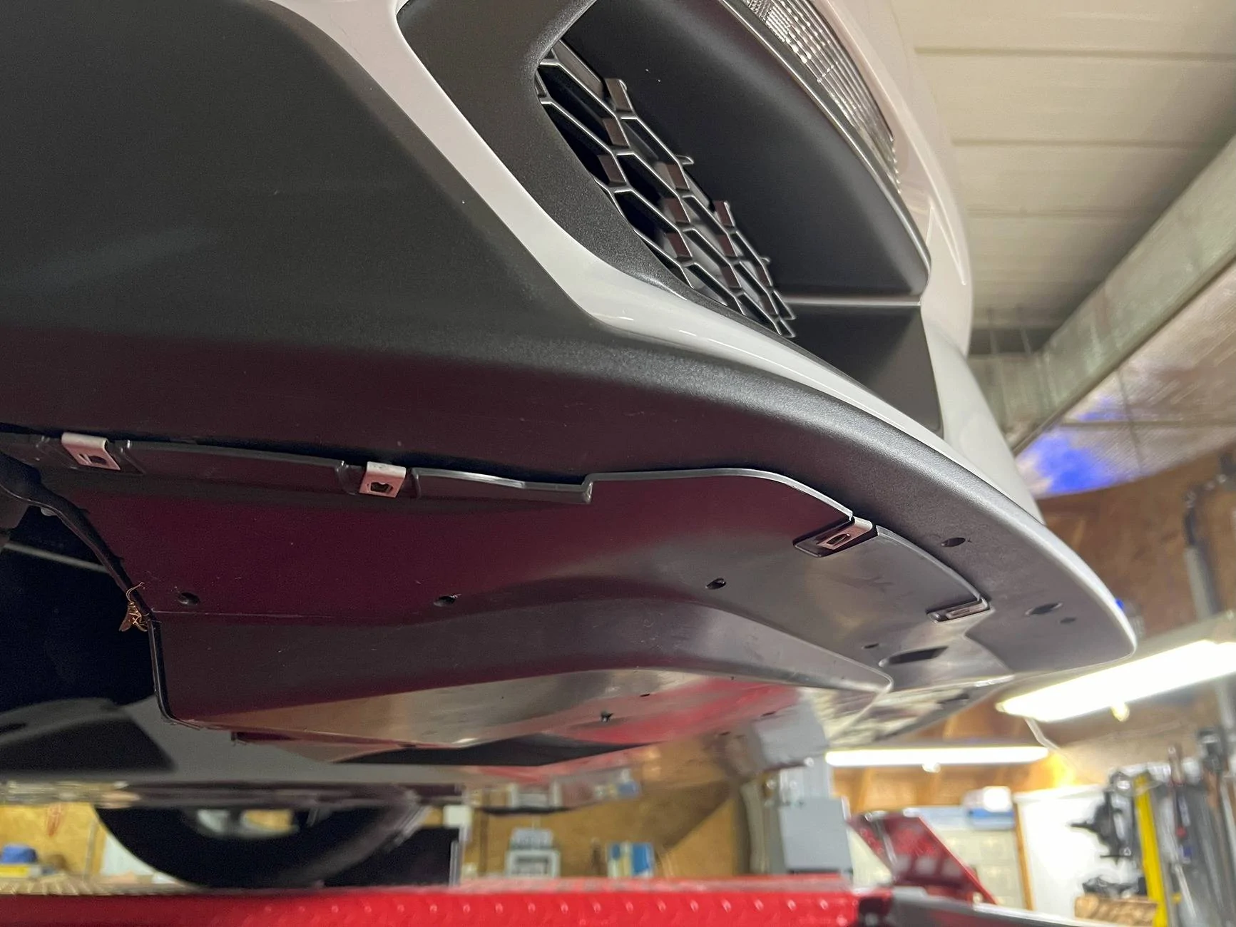

The dealer did a great job on the oil pan change, although they did screw up a bit on installing the leading edge of the belly pan resulting in the lower splitter to be installed incorrectly. This is what I found after dropping the lower splitter. I am working on straightening that out as I type.
