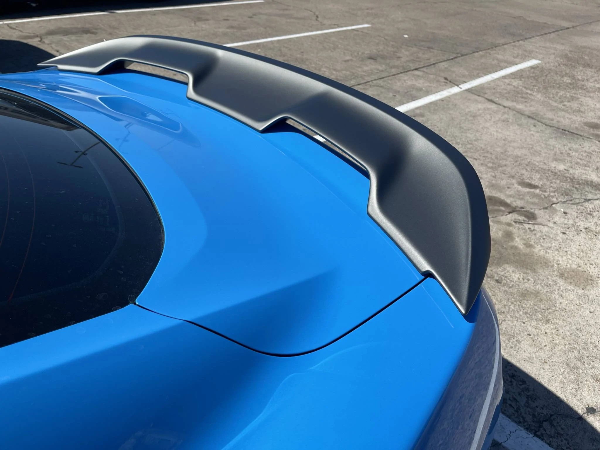

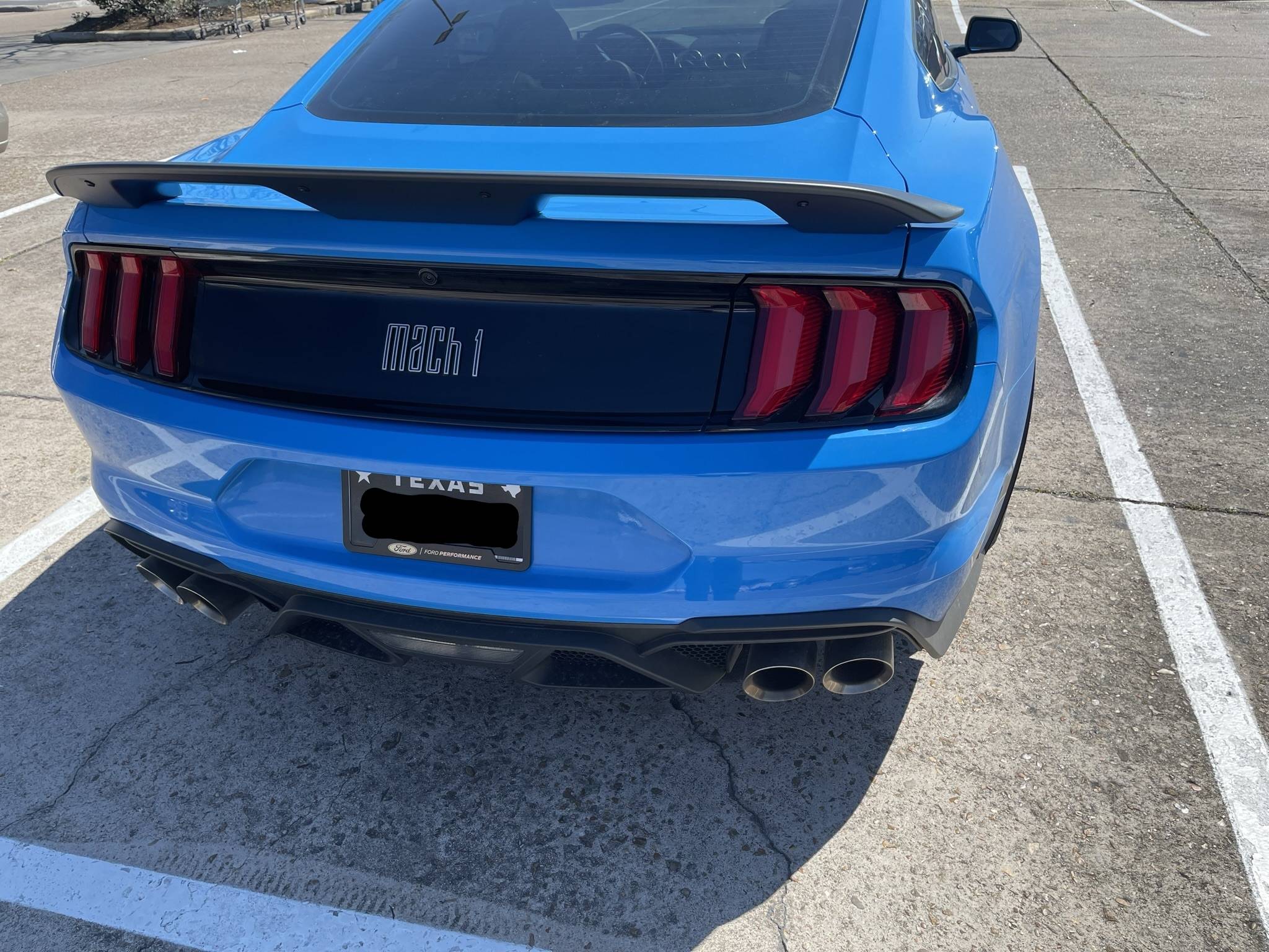

Wanted to give an update here as well: If you are having your spoiler painted, make sure to check the threaded studs. My paint shop left nuts on that were covered by a foam washer (to avoid painting the threads and nut but did not remove them after delivering it to me. I didn't check and created that gap 😅 easy fix once I unbolted and noticed it. I had my spoiler painted by Tommy Vaughn Ford body shop here in Houston and besides accidentally hiding these bolts it turned out great!

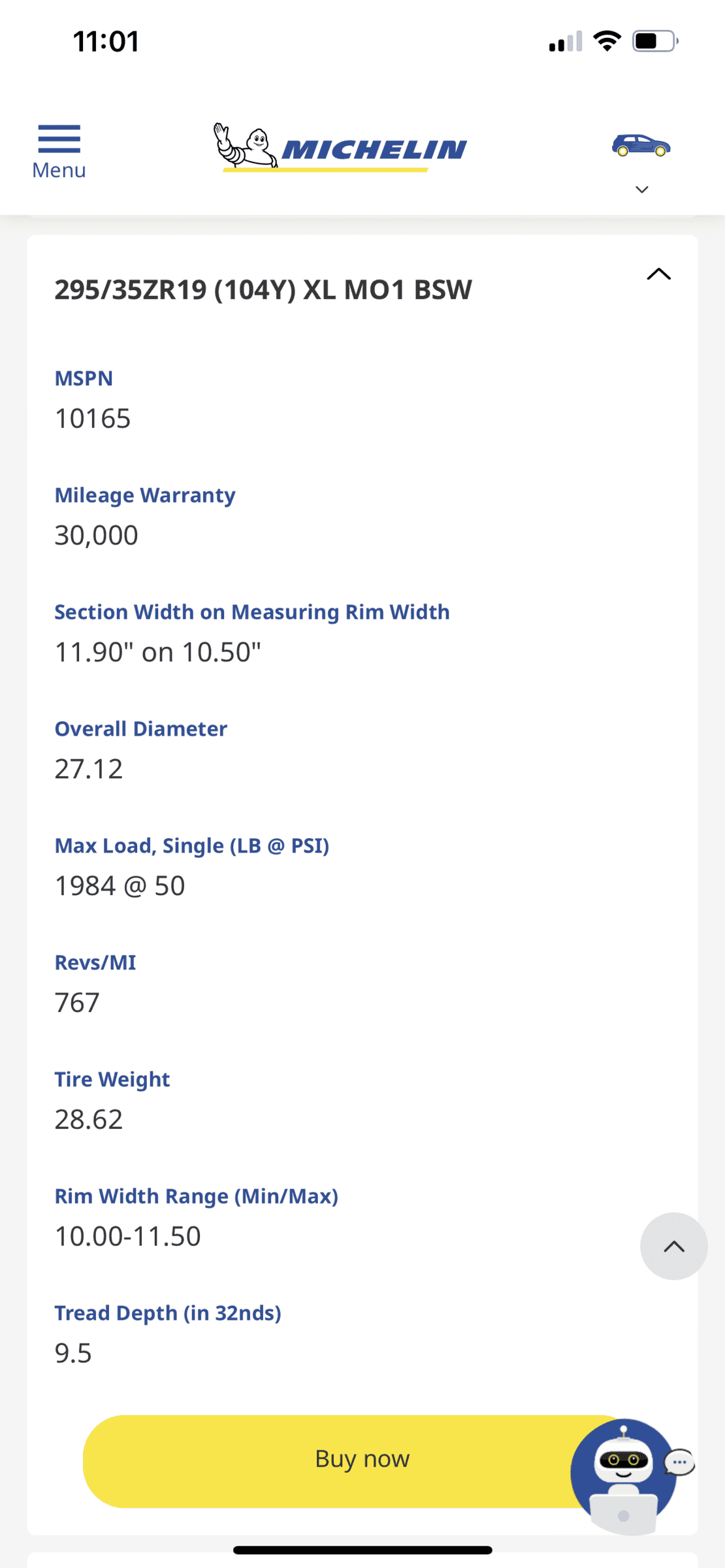

The Pilot Sport 4s 295/35 R19 is made for rims 10-11.5 inch. I have checked this with 3 independent tyre stores here in Aus and the tyre is fine without any compromise, despite the slight stretch.
Here are the details also from Michelins site..

@OZMACH Yes, it works fine on the rims, the slight stretch is due to narrower tread width. The look is just cosmetics but there is functional aspect too. Supposedly that tire is meant specially for 10" rims on Mercedes as mentioned in another topic.
When you check specs on Tirerack.com, tread widths are:
PS4S 295/35 = 9.8"
PS4S 285/35 = 10"
PS4S 275/40 = 10.1"
PSS 305/35 = 10.7"
PS4S 305/30 = 11.1"
PS4S 315/30 = 11.7"
SportContact 6 295/35 = 11.6"
From this you can see that the oem size 275/40 has wider contact area than 295/35 so it kinda beats the purpose of going wider. That's why the tyre looks quite a bit stretched. I don't have any stretch with the PSS 305/35. Even that one could have wider tread width but alas. Too bad you had to walk this road down for us but hopefully there'll be better options in the future.
