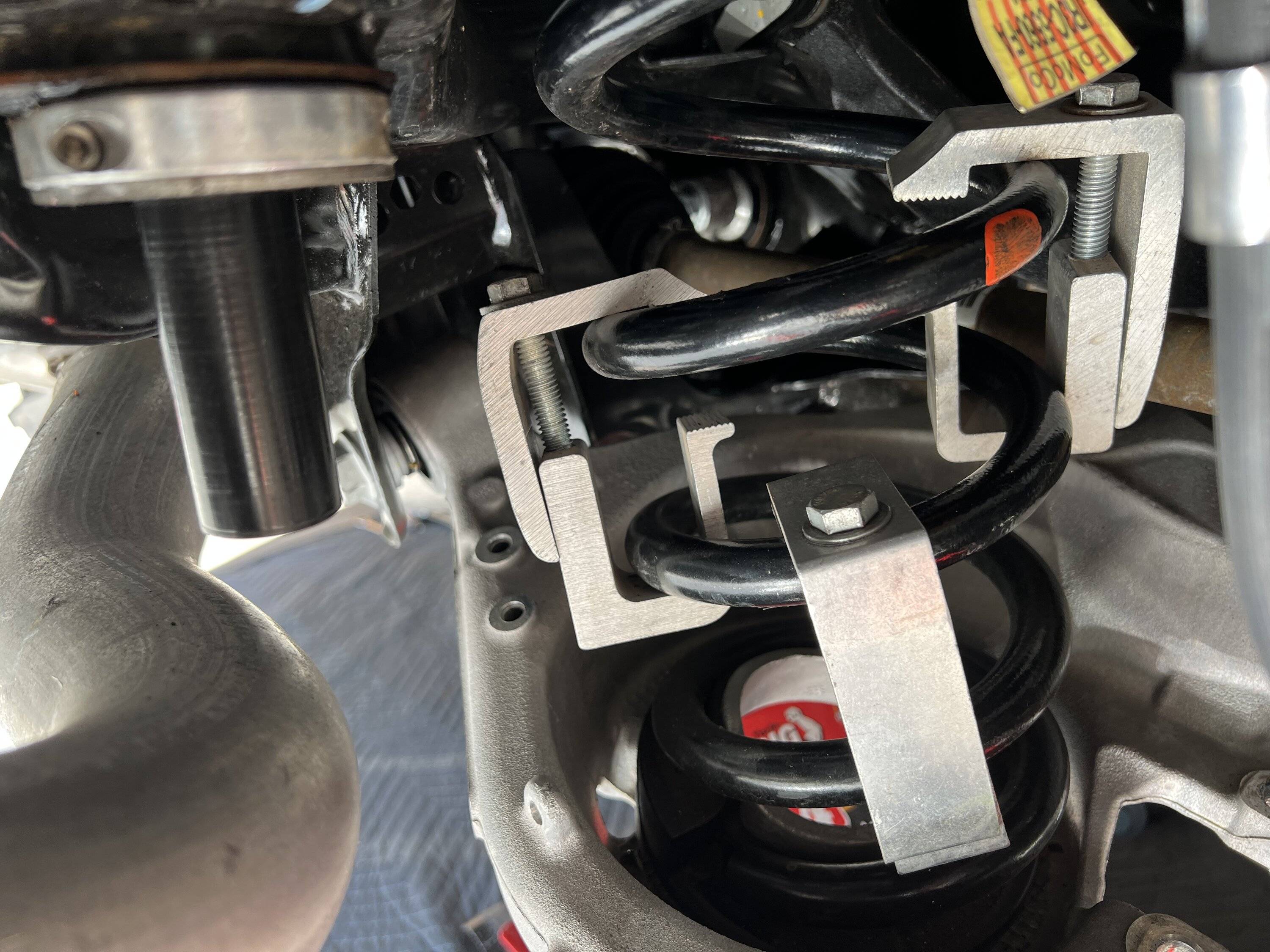

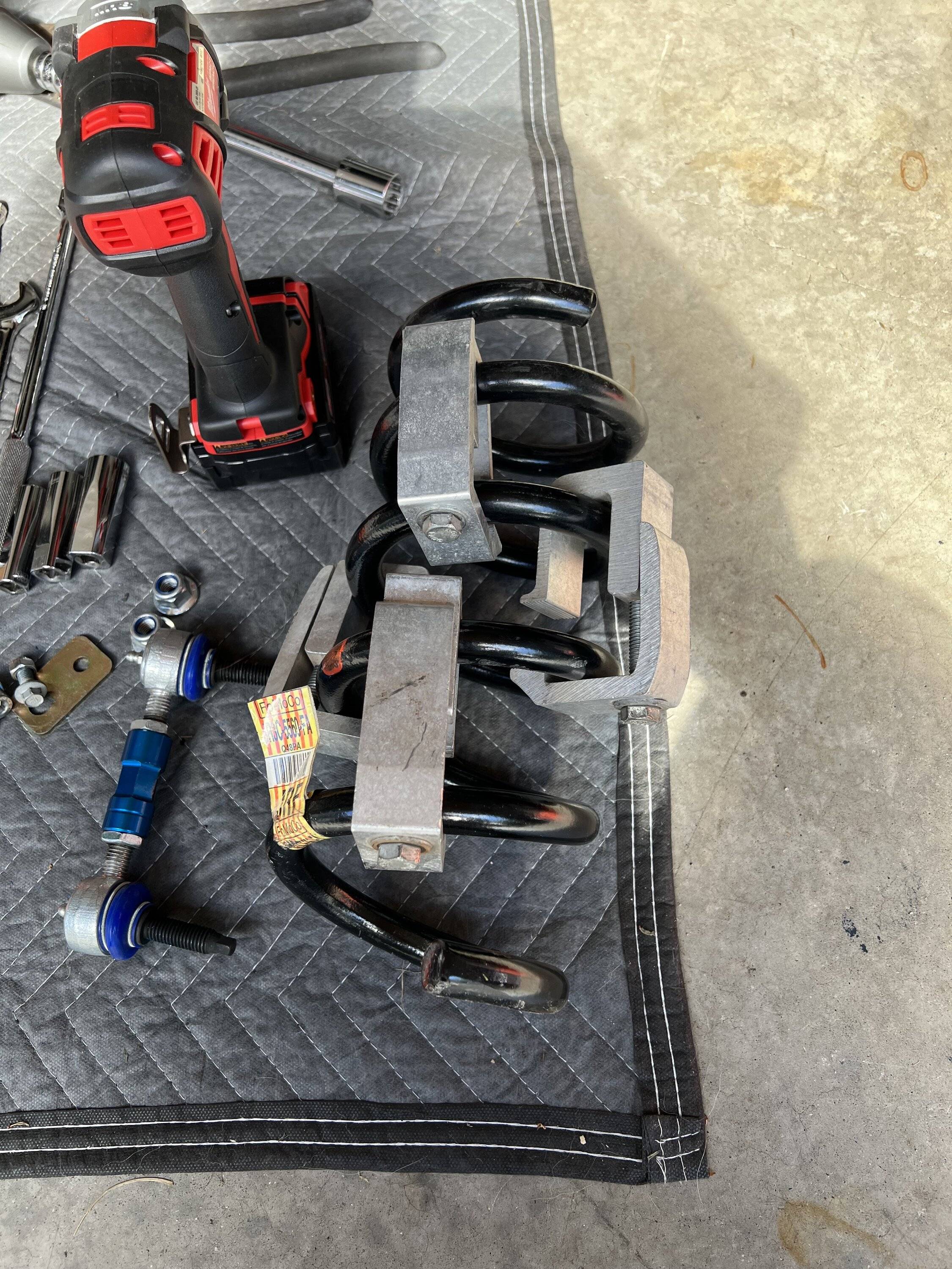

No issues with mine at all; the fronts were actually a breeze. However, dropping one side at a time in the rear didn't release the springs, so I had to get a bit creative. I had the old clamps that affixed my camper top to my truck, so used them as compressors for the rear as my actual spring compressors were too gangly to fit in such a small space.

I didn't, as I don't like to add stress to components on the other side that I can't monitor to ensure I remain within yield limits. Too many stories about, "I installed XX parts and now I have this weird thing (squeaks, rattles, clunks) going on.
Ideally, I would drop both sides at the same time but not without a second set of eyes and hands, so with the car on stands, the camper top clamps was the most stress free process for me and the results have been stellar.
