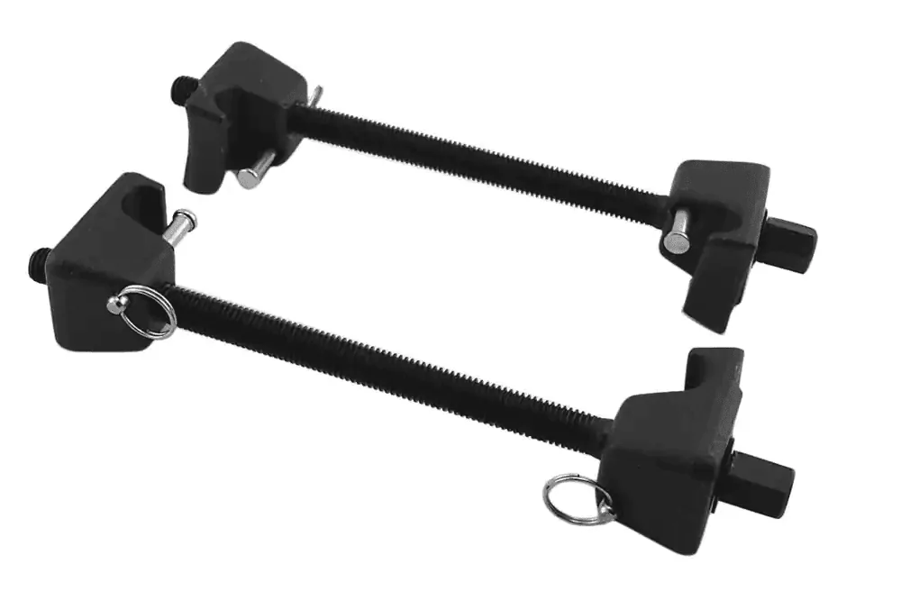

I used these "hook" style compressors. Got the job done with a little finagling:
They were dirt cheap and I was only doing this one time.
This style (shown below) may collide with the strut housing plate. These might work upside down (bolt head facing the strut plate) and use a ratchetting or open end wrench instead of an impact driver:
