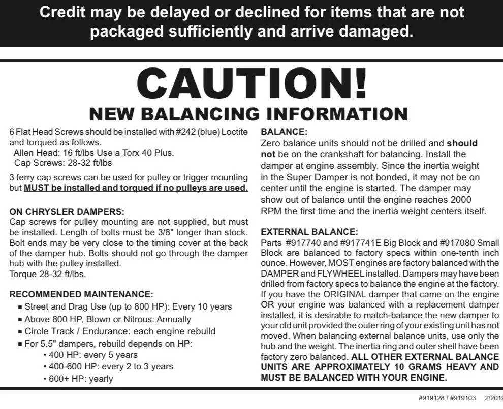

A few years ago I was at Killer Performance in Grain Valley, MO, during which I received a tour of the shop by one of the owners. He pointed out an S550 Mustang that ha the motor out of it. He said the owner had a harmonic balancer on it that was improperly installed. He said that wasn’t the first time that they had seen that scenario before either.
I’ve been looking at balancers for my car and the one that’s most appealing to me is the Fluidampr because it doesn’t require periodic rebuilds like the ATI Super Damper which says this right on the damper itself:
