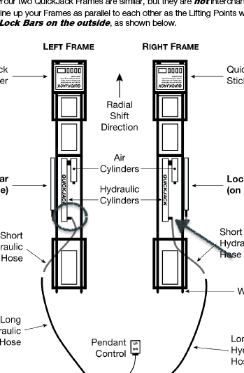

Mine wont lower im super pissed
The air charge in the cylinders, the purpose is only to close the jacks after the car is on the ground.
I will assume the car is not sitting in the air & just the jacks are stuck up
The quick disconnects & lines are keeping the ram pressurized. Need to release,bleed it off.
The way to do that is to open the system. Which will spill some HYD fluid, and the rail will come down.
I suggest that you remove the short line from the ram. Or the quick disconnect on the end of the line.
No harm no foul, just reconnect and rebleed the system, done.
It's a Cheetos thing.

Yea i did that and created a mess….whats to say it wont happen again ?
thanks for the info
