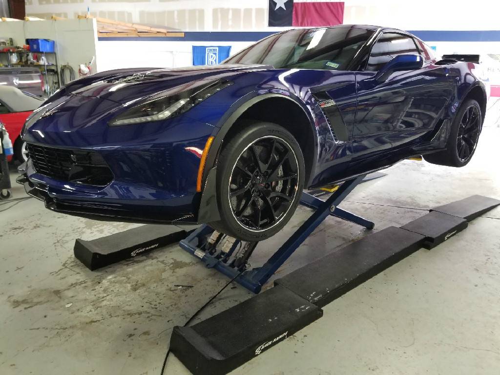

Bend pak 6000lbs with Race ramps. Portable.
My dad has one of those and it weighs a ton. Downside is ya can’t do much underneath and ya have a small fortune in the race ramps. Otherwise they lift high. Still waiting for weather to break so I can set up my 5000TL quickjack.

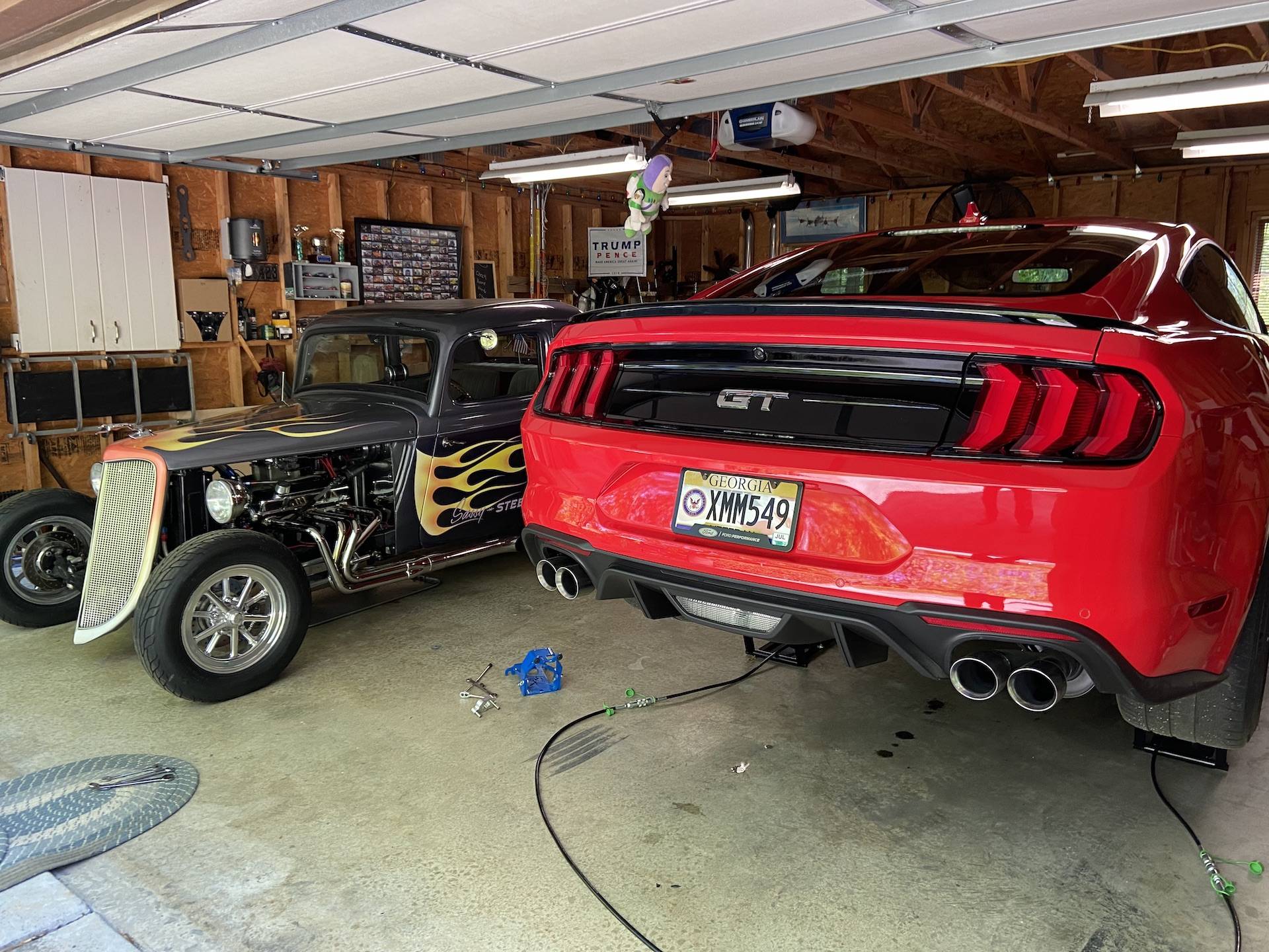

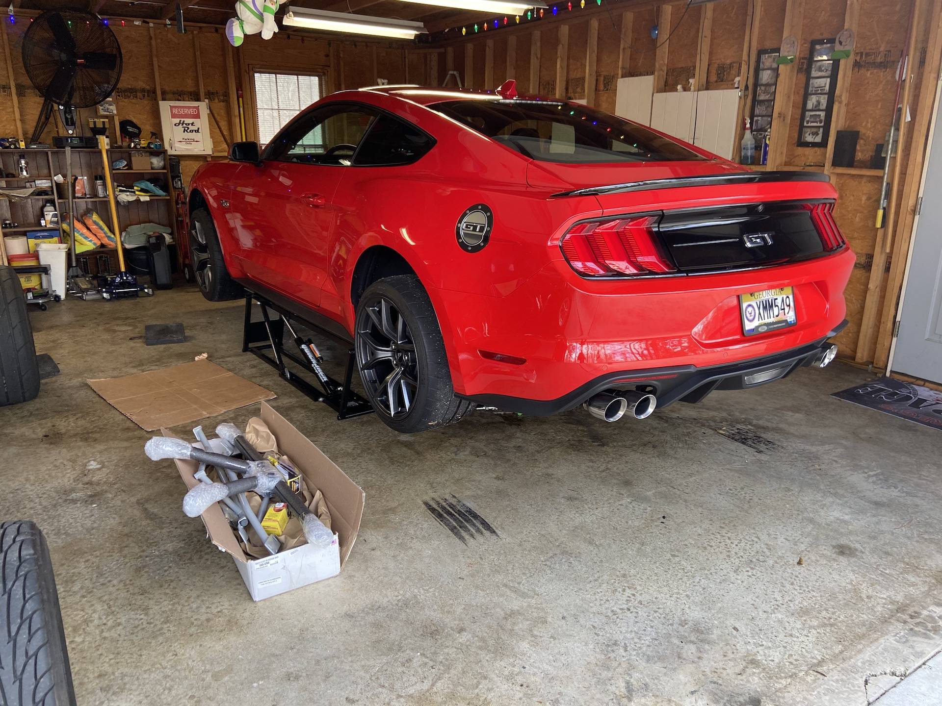

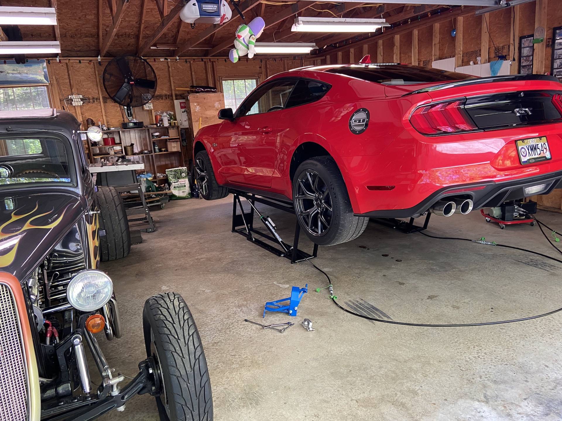

Used a new QJ, purchased recently, the older one is the first picture. The new high lift has plenty of room to work laying on a creeper. I was really surprised by the difference.
Older model, the cardboard creeper was your best friend.
If you cannot tell by looking at the distance off the floor. See the roofline crossing the white far left cabinet door and the windshield to the window header.
A real improvement
