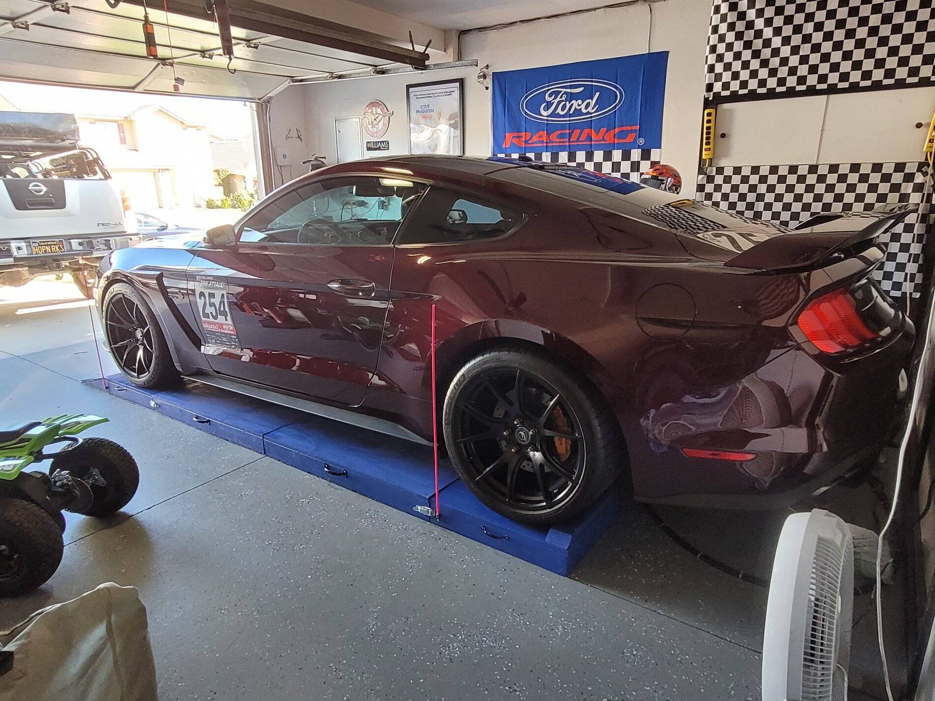

I have the 5000 slx which fits perfect and allows the lifting blocks to be located in a well balanced position. I lift my Audi A6 wagon it fits it just as well as it does the Mustang. I have even lifted my Nissan Titan 4x4 and it lifted it just fine as far as lifting power. but it only lifted it high enough to change to do a tire rotation due to height. I use to store mine centered under my lowered by 1" mustang gt with 285/35/19F. 305/30-19 R. However when I added a Steeda 4 point K brace it stuck down just enough that the car would lightly touch the Quick Jack. So I built a modular full length ramps. Anyway, here are some photos of the quick jack position on the floor when I parked directly over it. and with my drive up ramps. Also I put reflective tape on my jacks so that I can see them when backing into a dark garage.

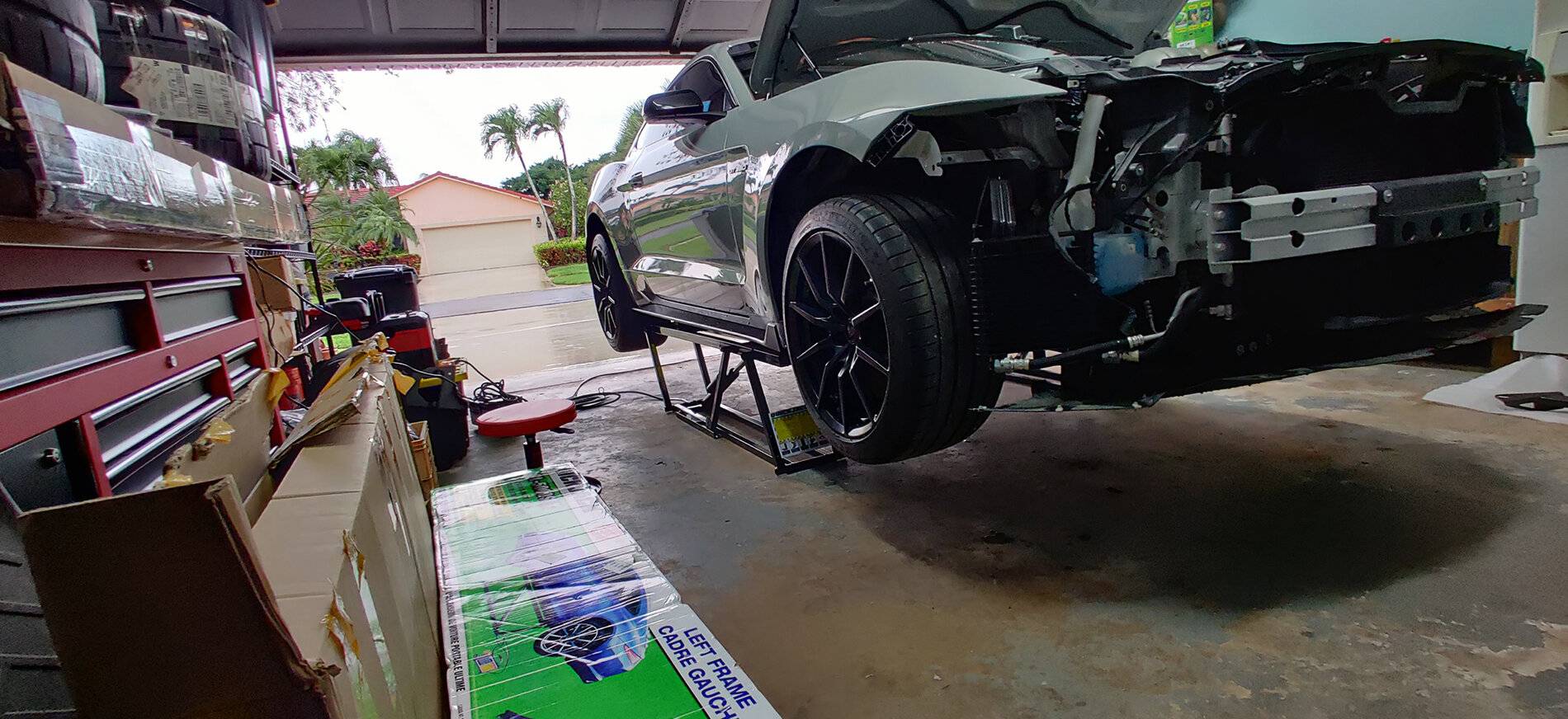

I'll just say this...QuickJack is one of those purchases I kick myself for not making a lloooonnnnggggg time ago. Lifechanging. I had no budget, so the sky was the limit. I didn't want a drive on lift (didn't want to give up the real estate and didn't want to still be left with dealing how to get the car up for wheels off maintenance/mods), and I didn't want a two post lift where wheels hanging was the only option. Obviously with the QuickJack you're still laying on the ground to do these things, but it gives me more under-car clearance than I've ever ever been able to achieve with a jack and jackstands. A great compromise. No regrets. Dumb to wait this long.

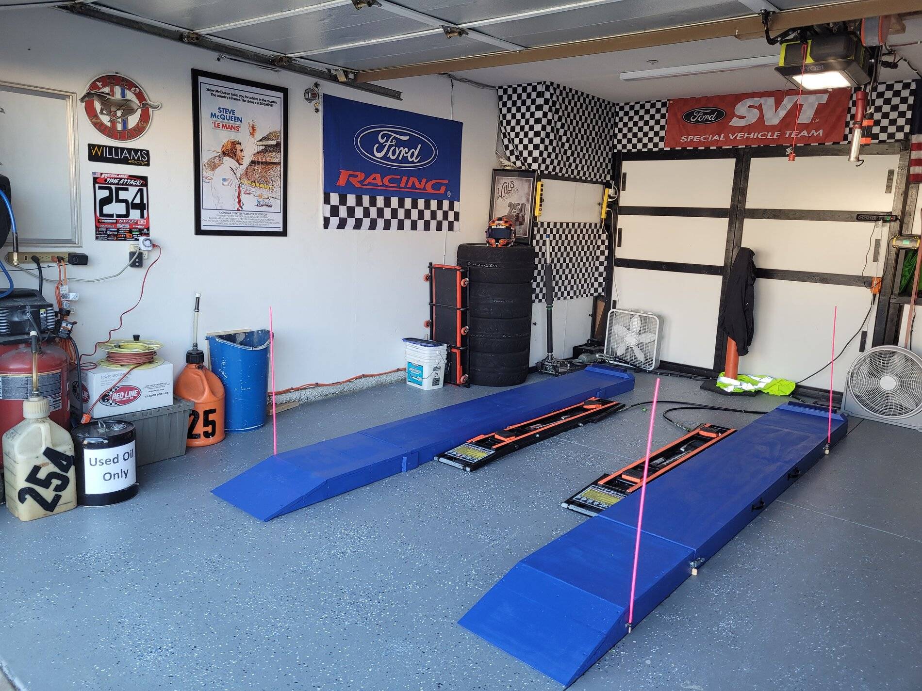

So Will (1 old racer) That looks like the ticket to me.
I cannot really tell from the photo but that ramp set is wood correct?
I think I am going to try to replicate what you have there. Really nice job.
I really like the fact that you can just leave everything in place.
I do not have jacking rails, am I going to need those?
On bend pack website it looks like they have hard rubber blocks that go where the jack will make contact with the pinch welds?? Am I correct in that??

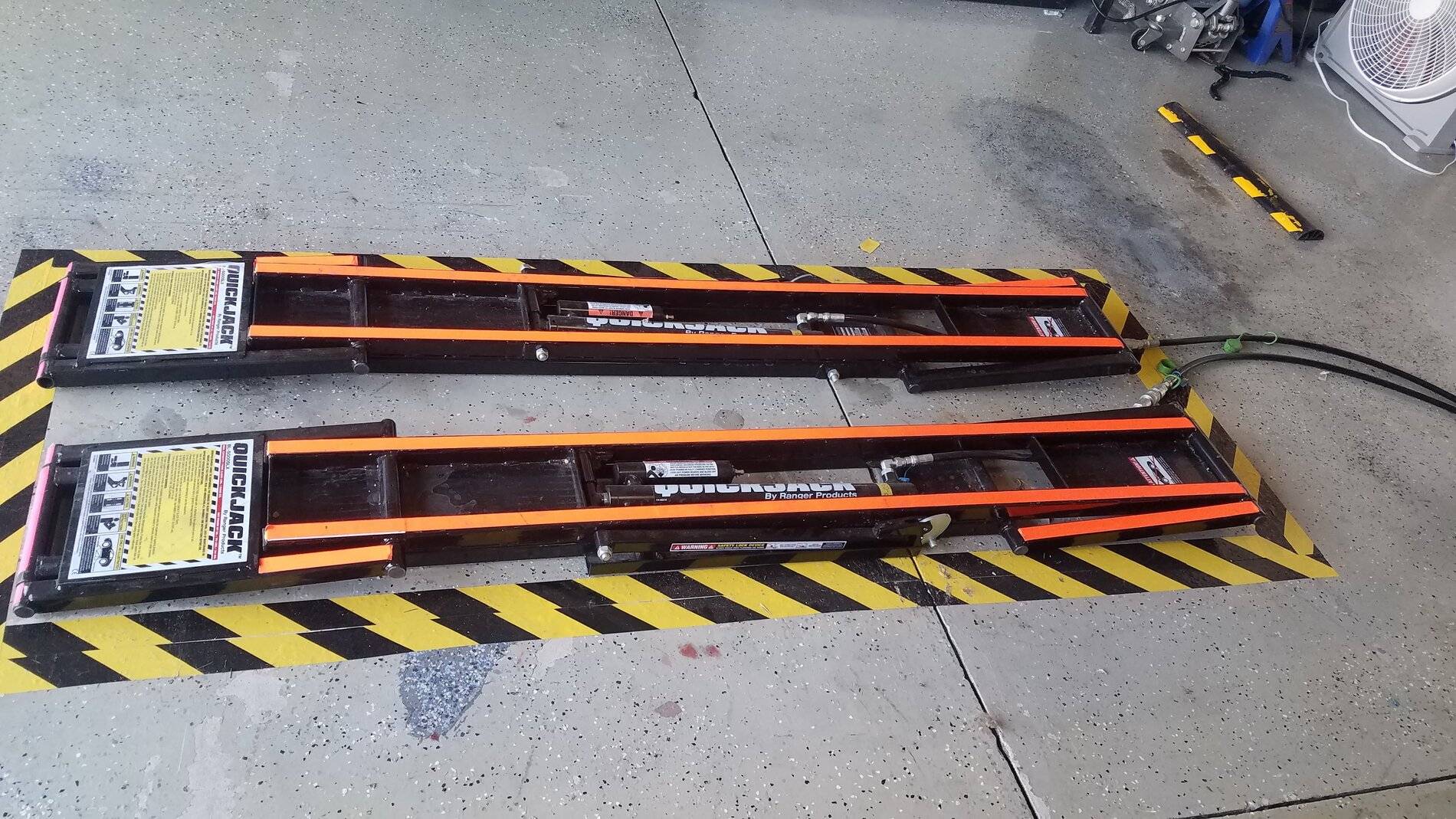

I only needed the full length ramps because the car was hitting the quick jack right at the locking tab that is about 1/4" inch above the rail. the web site is correct they are 3.5" but the locking tabs are a 1/4" taller.. They hit the steeda k brace right where it crosses the frame rails. Other then that they are perfect on a 1" lowered mustang. as far as length i know the 5000slx fits perfect for the mustang so make sure the 7000 will fit between the tires. And I think that with the quick jack's rubber blocks it will work better without jacking rails,. Also I did a DIY to build the modular full length rails found in the DIY thread.
