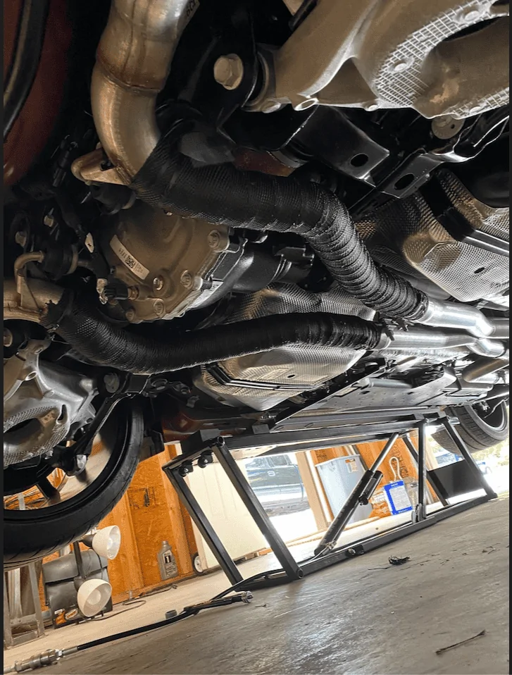

There is a video out there of a guy who did manage to drop a car off one, but it was user error in letting it down. Just have your wits about you when you are operating it (the guy was distracted making the video at the time).
It is great to be able to creeper from bumper to bumper. I've had mine a month or so and getting the car in the air is so much easier than jack stands. Should have bought one years ago as most people say. Now if my damn claustrophobia would just piss off!

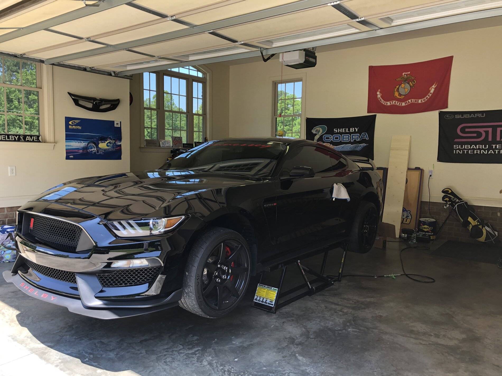

I have the 7000 ext version of the Quick Jack and it fits just fine under the 350, plenty of room.
I learned my lesson the hard way when I had a car slip off the jack as I was getting ready to place a jack stand under the car. The very next week I bought the quick jacks and never looked back.
Best money you'll ever spend if you do your own maintenance.
