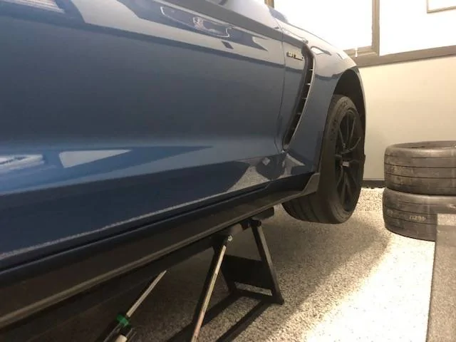

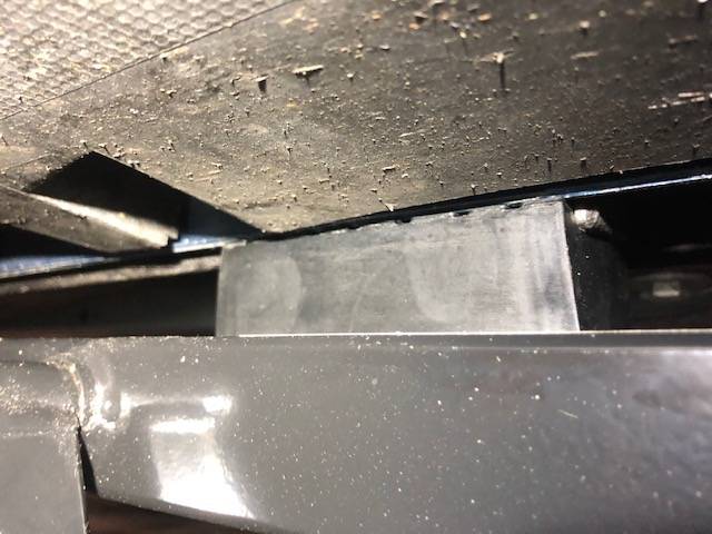

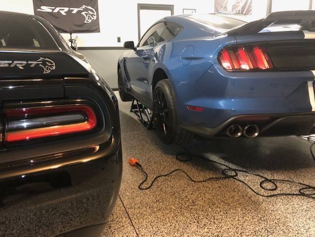

Yup got it done. That lil canister is small! Loses air quick. Ended up using car tire pump to put it to 50 and then check it quick with the tire pressure gauge I use for drag racing. It loses a couple PSI just doing that. It's at 45 each side. Put it under car with the tall blocks and it works AMAZING. Up and down multiple times for giggles. Great purchase, gotta change the oil tomorrow.

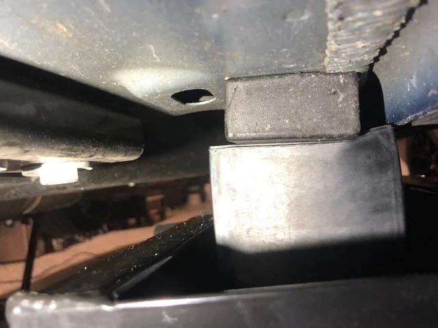

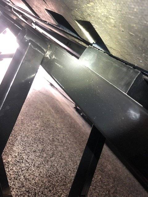

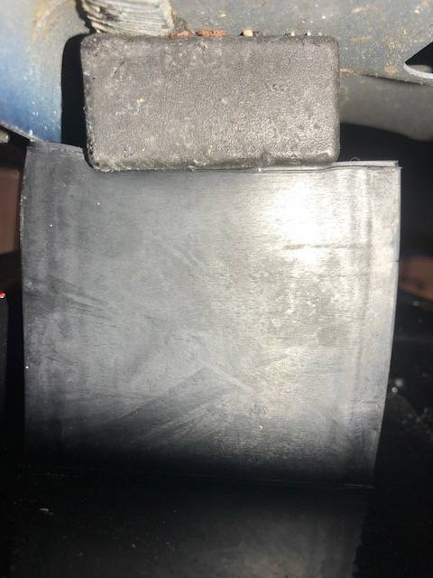

I don't know why I'm a lil surprised by how much the rubber pucks displace under load. I have the Steeda low profile jacking rails and they sit at a slight angle is seems like. Not perfectly parallel to the deck. Car is solid on the lift though.

Use a rubber spacer problem solved

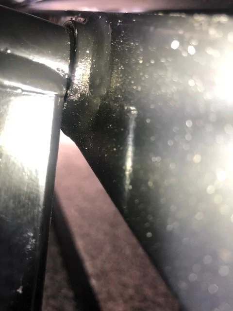

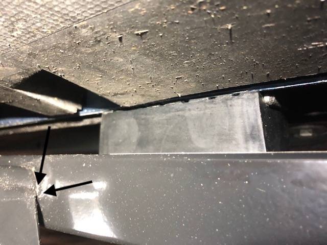

is the weld cracked ?

Nope not cracked just a shadow in a crappy photo. It's the space between the arm and the weld.

Yeah I didn't like how much it flexed either. I don't have the rails though, so I was going straight into the pinch weld, and it wanted to cut right through it. That's why I built my wood block sets. I would recommend anyone that does not have jack rails to either use blocks of wood, or those aluminum "pucks".
Unrelated, but man you got a nice setup in that garage :) Props for being an equal-opportunity "tire roaster" (e.g. Ford + Dodge). Like I told my buddy who is an import fan...I don't care what it is, if it's fast, I like it.
