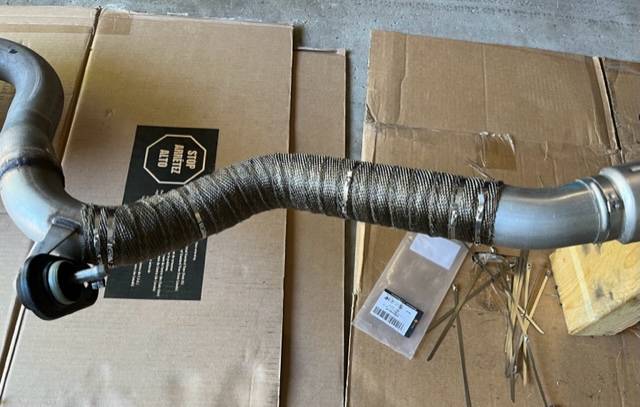

How many feet of exhaust wrap will I need to wrap the section around my Diff? Assuming 50% overlap?
The distance is about 2 feet, so is 5 feet for each side a reasonable be guess? Looks like there is 15 Ft rolls available.
Thanks for input from those who have done it!
I apologize if this has been addressed earlier in the thread.

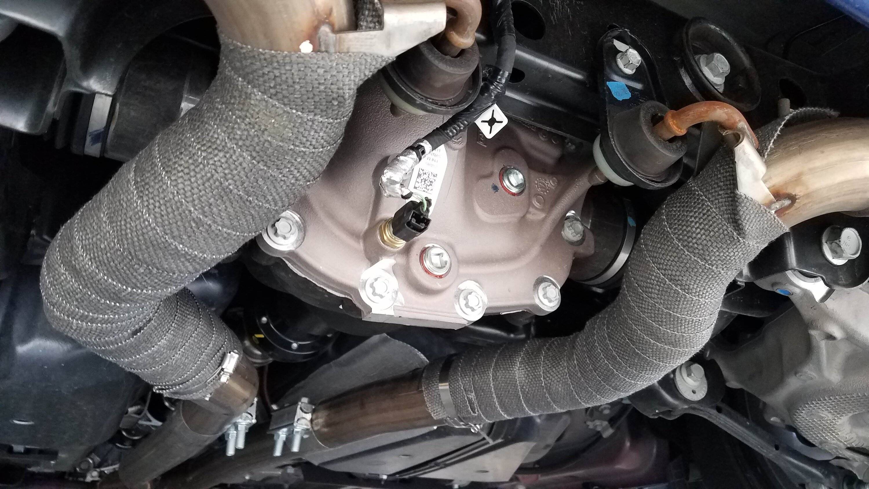

1 old racer
Feb 20, 2018
89
1,719
2,364
Fontana CA
Will
2018 Royal Crimson GT PP1 prem., and others
I cant remember how much I used but yes use 50% overlap. Here is a old pic I took when I installed my wrap
Bossdog
Feb 6, 2016
321
163
SE Michigan
2019 GT PP2
I should have paused and made a calculation, now that I see it wrapped, its an easy calculation:
Pipe Diameter X3.14 = 8. Each revolution covers 1 inch, (@ 50% overlap) you need to cover about 24 inches. 8" x 24" = 196 inches / 12 = 16 feet
The 15 foot wrap was a little shorter than I intended to cover, but should do the job.
