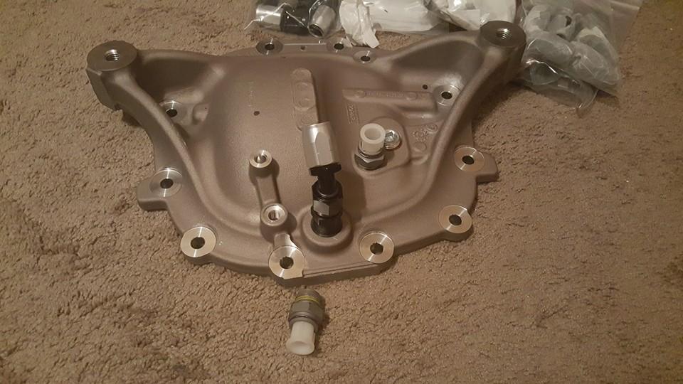

I am still working out the details, I will post the information when I confirm the parts.
For the sensor I am using a Glowshift gauge and sensor. The sensor is mounted in the factory pocket.
The gauge is in the cockpit, I am keeping the differential setup like this until something better comes along.

Thanks Dave. Appreciate the pics. So the sensor stays dry..the socket is threaded...And you fished your own wires?

FR3Z4033B is the correct part number. All my parts were ordered from an R model Vin. The cover is different, it comes with the fittings for the cooler (OEM quick disconnects) so it has three 1/2"NPT holes instead of two. The cover lists for $110.82. Benny has good pricing but he is too far away from us for the volume so I source everything from a local dealer so we can touch and feel parts and compare stuff from other models.
