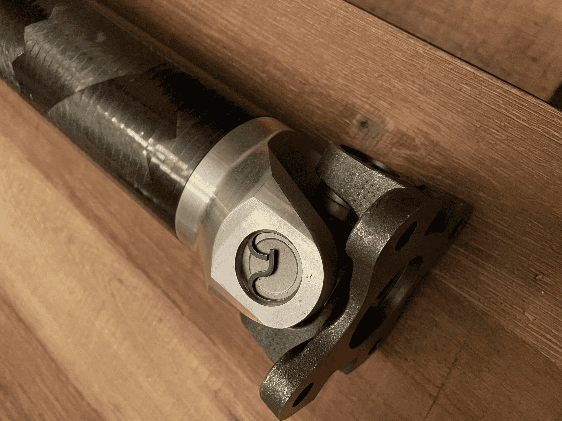

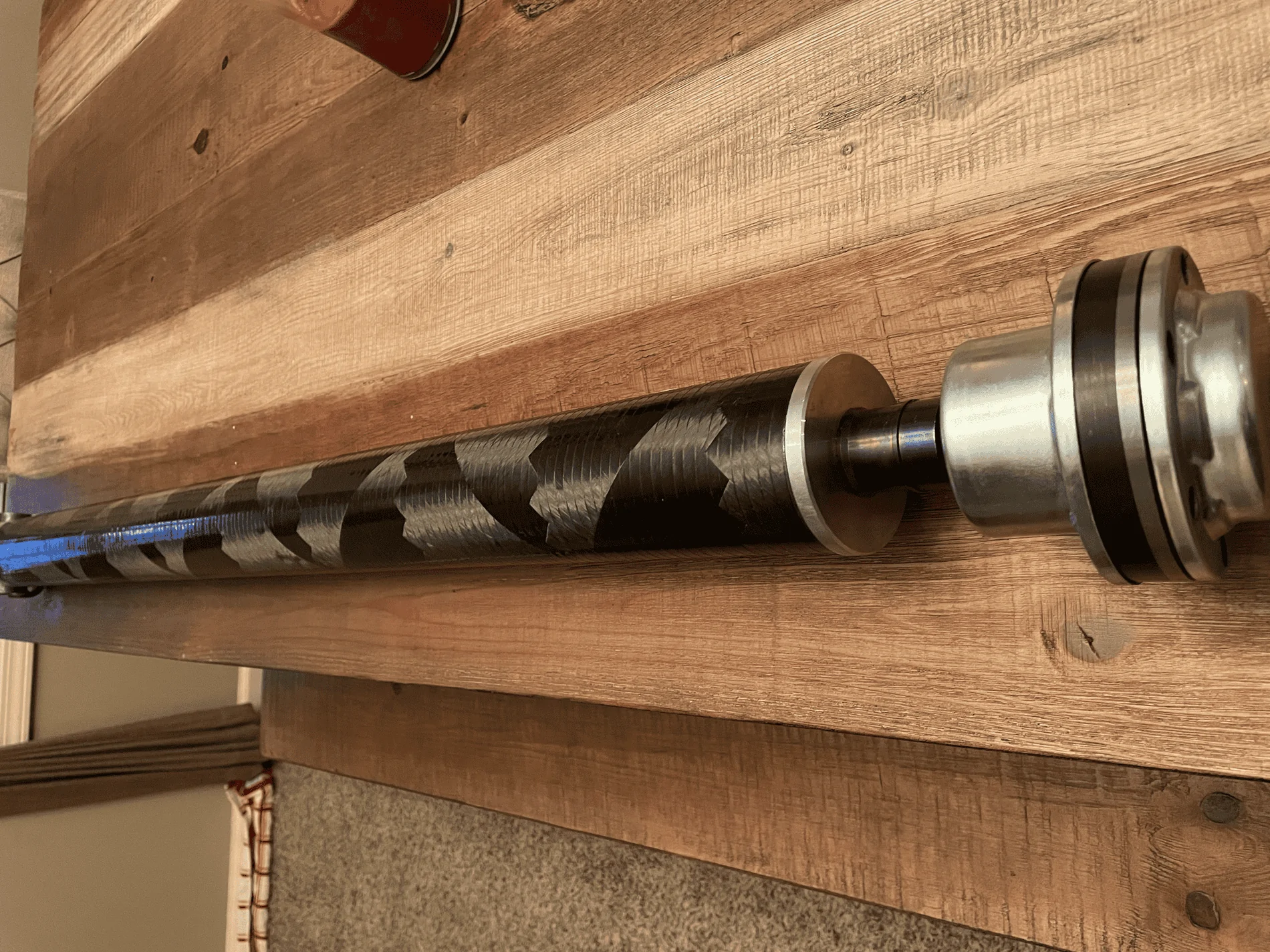

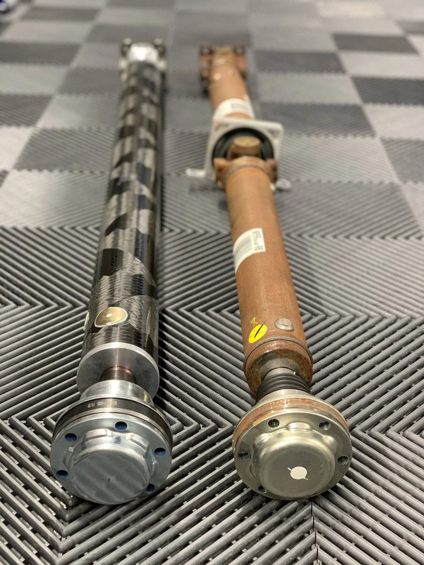

After 10+ weeks, driveshaft is here. It seems like a no-brainer on the surface, but I'd rather talk it outloud than assume anything. The shaft didn't come with any instructions, but the new DSS shafts have the correct flange for the pinion, thus there's no adaptors or anything like that. With that in mind, it should be a straight forward install. There's also no alignment marks on the shaft anywhere, of the likes I've seen on the QA1 and some others. Common sense would dictate if the shaft is balanced and installed with the yolk and pinion in their currently aligned positions, there shouldn't be any issues (in theory). What say ye? Anything worth discussing or going over here?

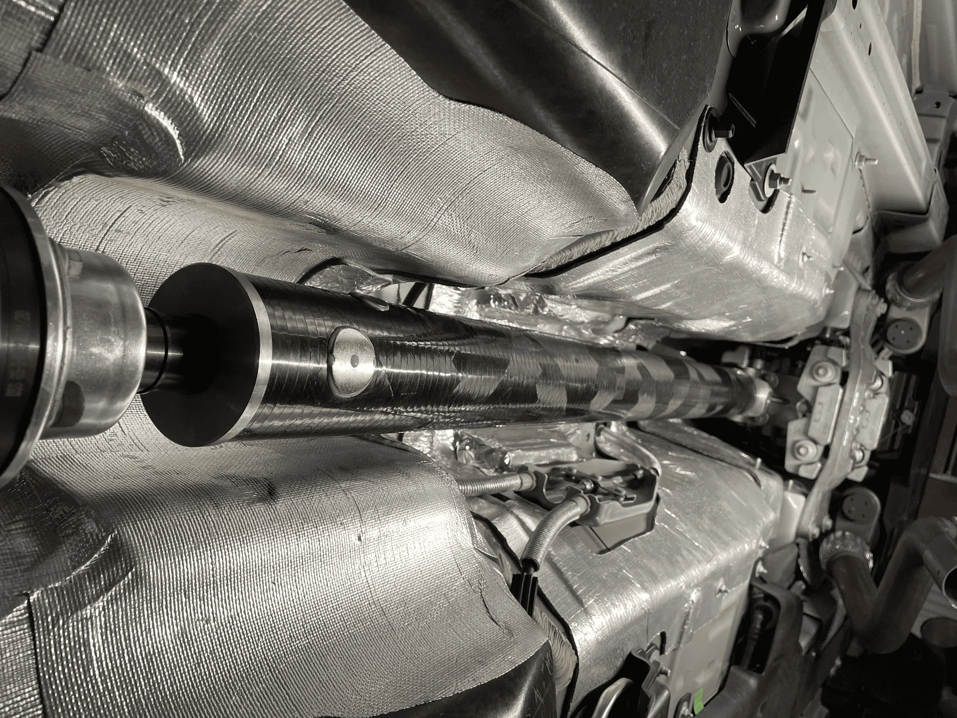

Here are some pics of mine

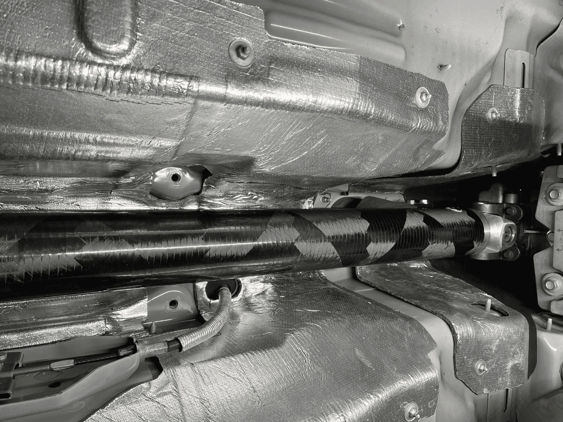

It’s in. Pretty darn straight forward job. There's no index marks or anything like that, nor for the life of me can I think of a reason there should be on a round, balanced shaft. I did make an attempt to keep the tranny tail shaft and the axle yoke oriented to the factory position, but the way the bolt holes were configured on the driveshaft, it would not allow for this. It ended up about 20* off from matching, but I honestly don't see what it would matter.
Both ends fit and bolted up just like stock; don't know what else can really be said.
A couple of things to clarify that I had randomly run across on my homework about the DSS...
- Parking brake cable; didn't need to touch it. Not even close to being in the way or needing any attention.
- MGW shifter. Not even close. Even with the MGW heat padding wrapped around the shifter, I could still touch my fingers together reaching around each side of the driveshaft at the tightest point. I think at some point in time, the diameter of the DSS was bigger than it is now.
Yes, there is a slight change in NVH. But slight. I honestly don't think it's a change in vibration as much as I think it's just the feeling that comes with having such a direct connection between the driveline. It is most certainly nothing I am going to try and chase by rotating the attachment or anything like that. And certainly not worth dropping the exhaust again to rotate it.
In exchange for the increased "feel" (I'll use that word instead of vibration), comes that instantaneous throttle response folks mention. It's an immediate connection.
An improvement? Yes. Worth the cost? I think so. Especially for the Black Friday price I paid for this thing. And it just looks damn cool...when you're under the car, LOL.

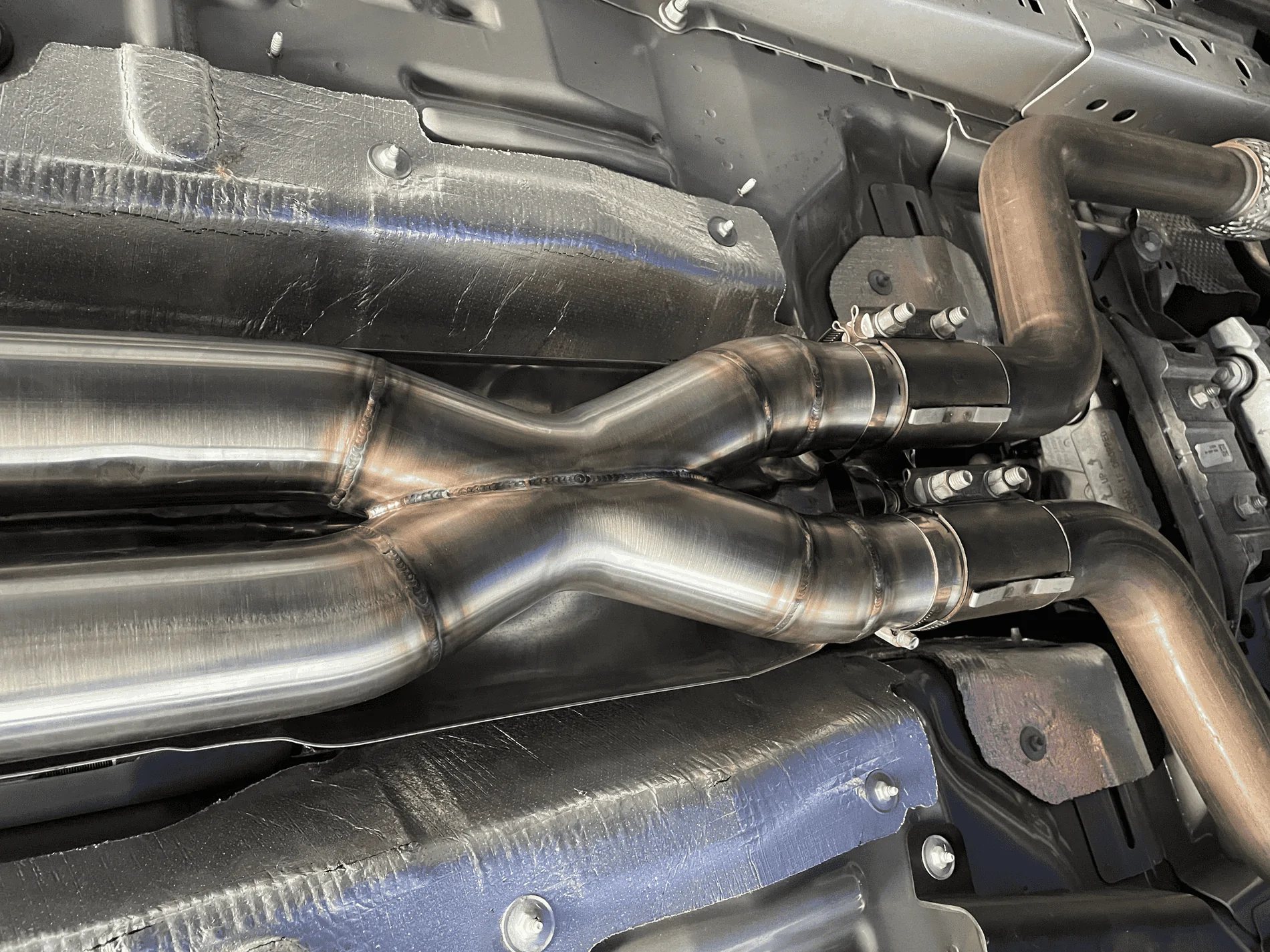

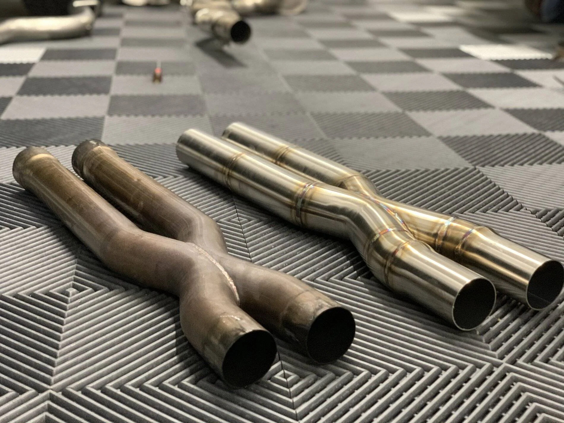

(Yes, I swapped out my ShifTeck x-pipe for a BLine x-pipe at the same time).
