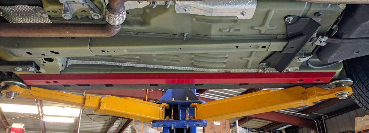

Ours are also below the pinch welds and are the only true full length with welded sealed end caps and machined and tig welded inserts to completely seal the inside. The photo attached shows how long they are going from wheel well to wheel well. We have the car lifted at the very ends of the pinch welds as this photo was taken when we installed them on this car. Once installed you can use the jacking rails to lift the car with any 2 post lift. If you have the Steeda IRS brace we also have a set for those.
