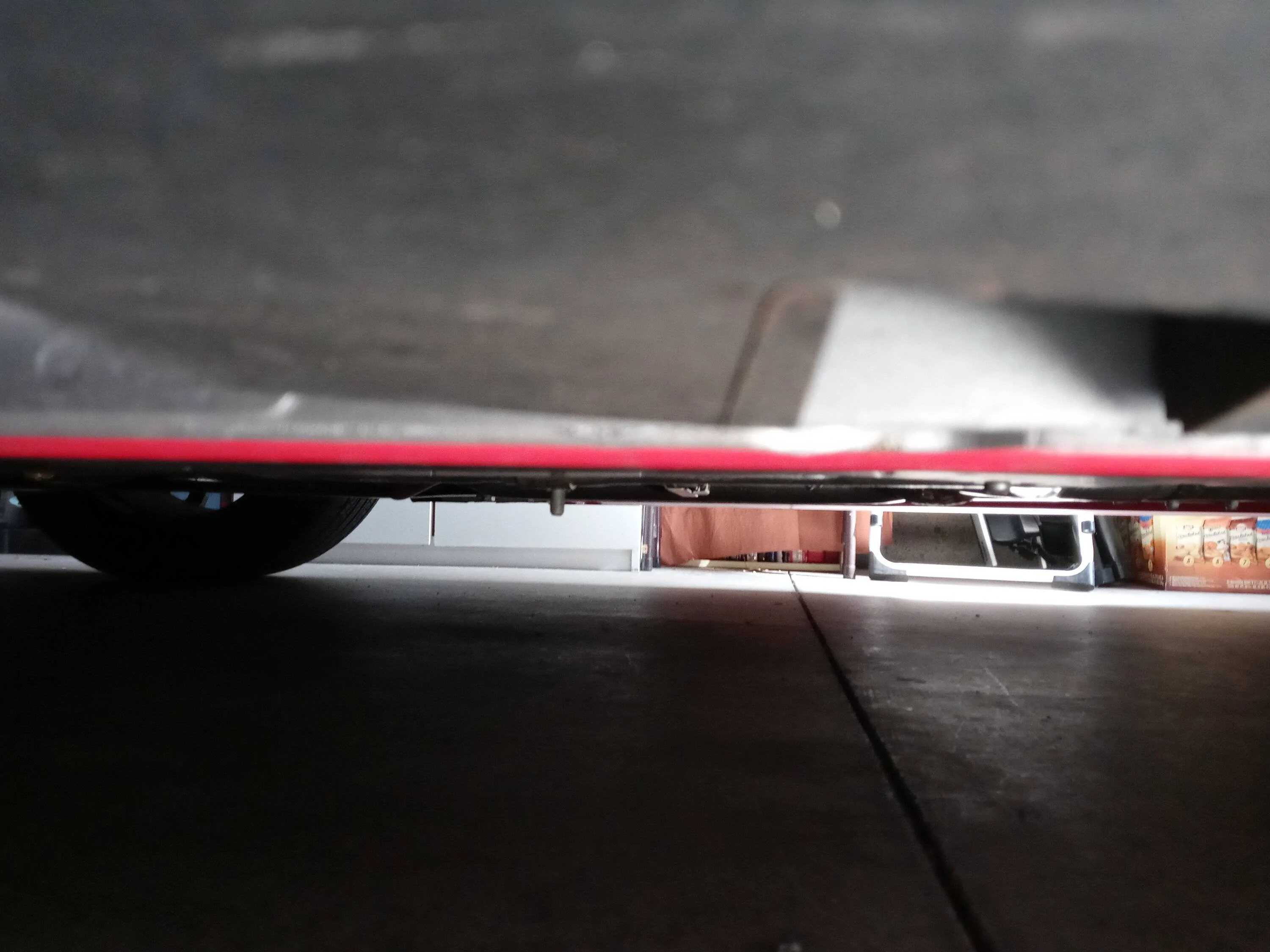

I bought the BMR jacking rail and you can see it protrudes maybe 1/16" to 1/8" below the pinch weld (rails are red in color). The only thing you have to do is cut the sealant between the body seams where the rails bolt up to otherwise it won't be flat against the underbody. A simple razor scraper does a fine job of making the sealant flush with the rest of the underbody.

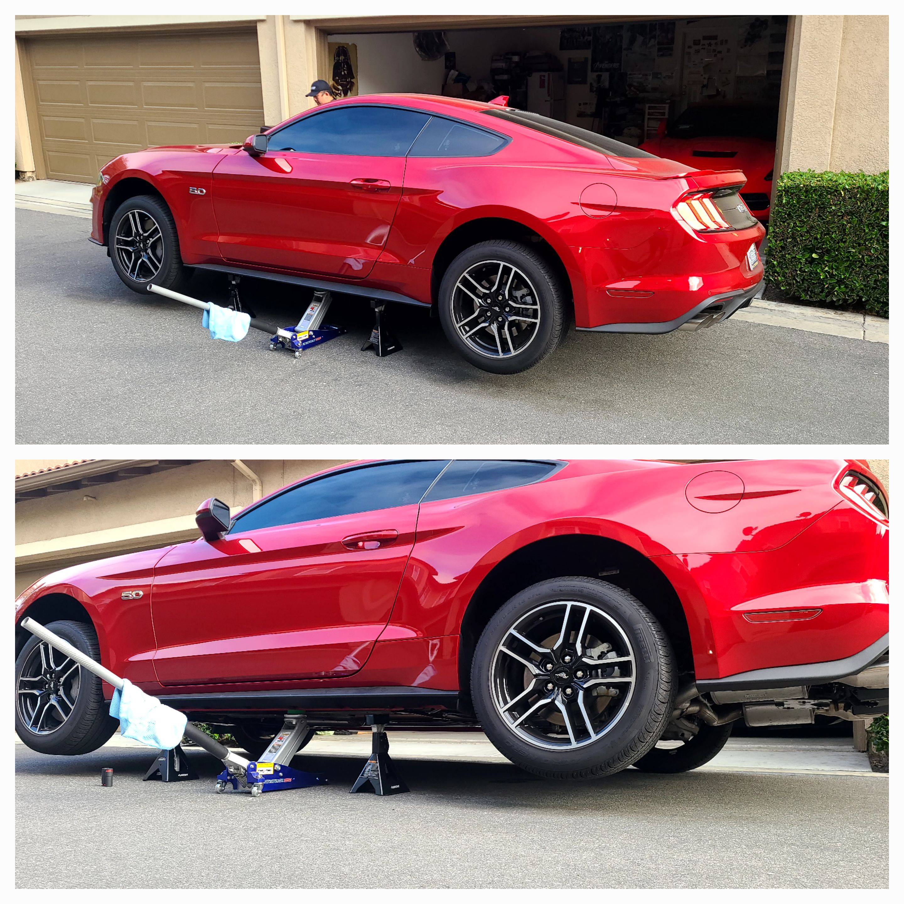

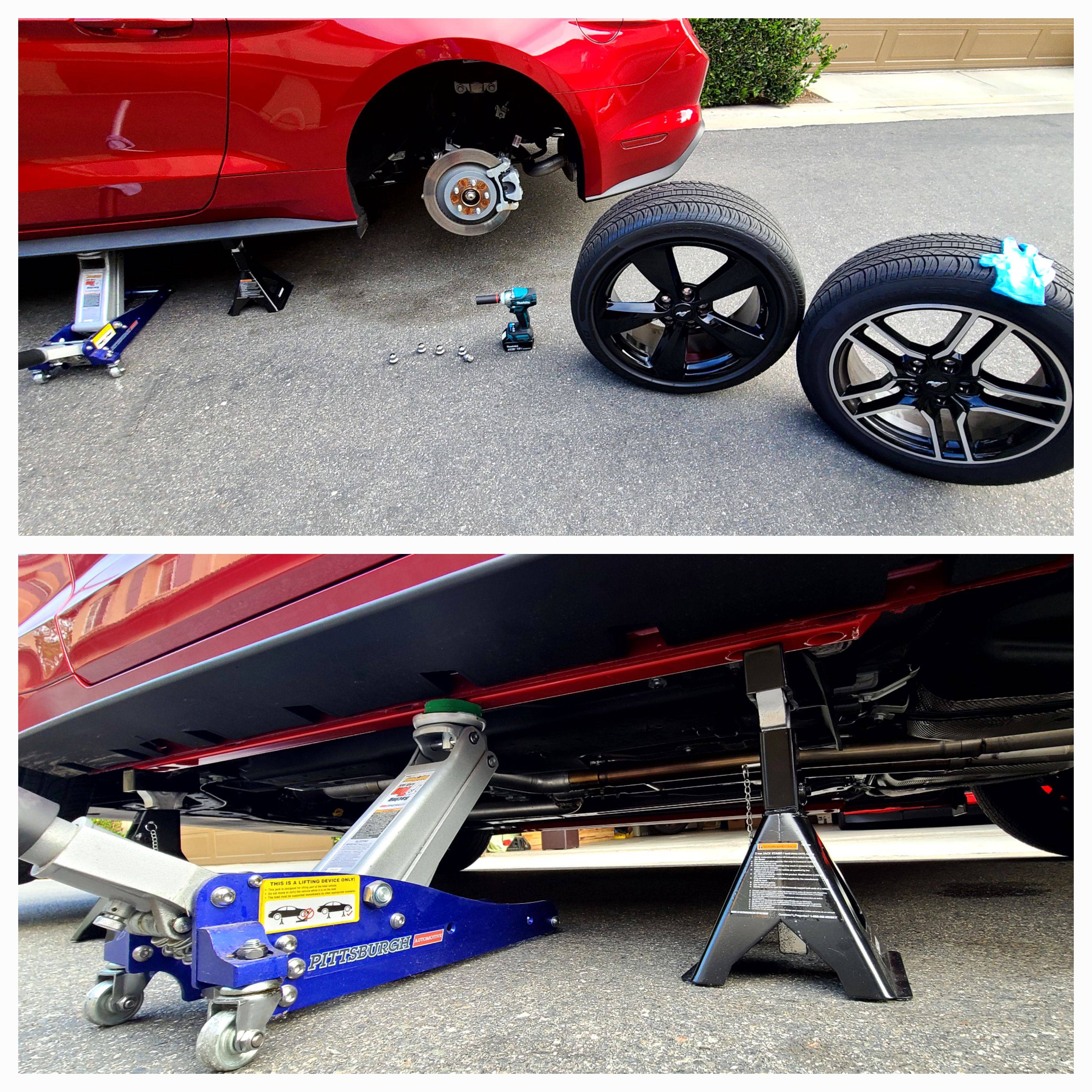

I have the BMR's in red. Nicely made and quite beefy and sturdy. I almost got the Steeda ones but I got lucky and the wife surprised me with the BMR's.
SoulMan80
Mar 14, 2022
31
27
Orange County, CA
James
2021 Mustang GT
Whichever one you choose, I believe you'll be happy with it. It sure makes life a lot easier with these on our cars. 🍻
