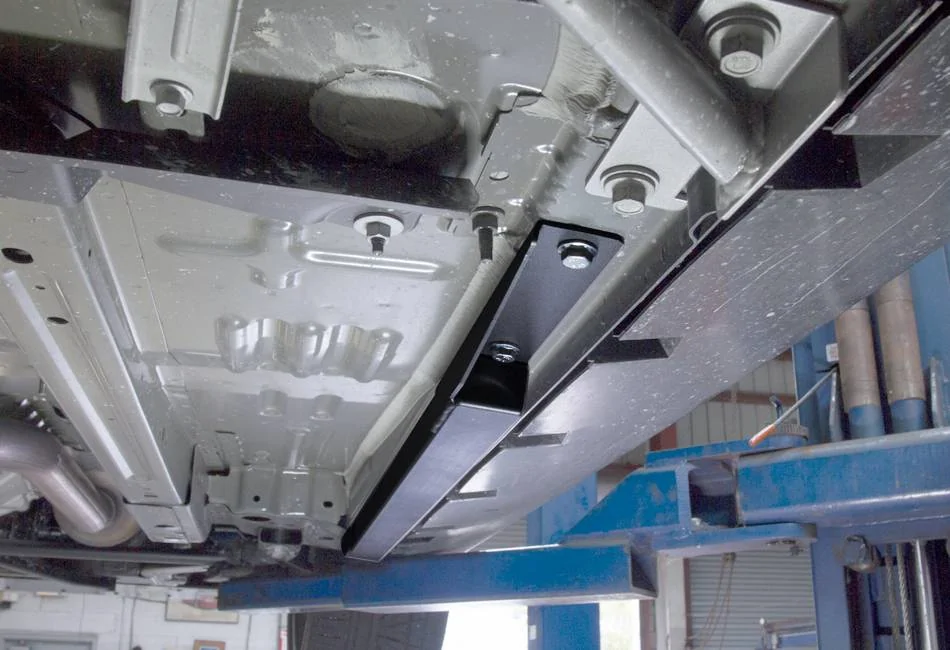

I just baught a set of the steeda low profile rails. Do I need to apply thread locker to the bolts or just torque them down? Thanks

The S550 has 4 specific Jack points, each point only lifts one corner of the car so you need to Jack up all 4 to lift the whole thing. Jacking rails allow you to do it with only 2 points.
Plus every time you use them, you fell like you are bending them up. Especially if the position is not perfect. For a track car or an autocross car that sees a lot of quicky wheel and tire changes they are a great investment. Even with a pure street car that only sees the home jack once a year. I would still recommend one of the pinch weld protectors/jack aids, which can be as simple as a slotted hockey puck.
Torque spec = tight ... we don't have specific torque specs for the jacking rails.
TJ
You dont rekon the bolts will vibrate loose?
The instructions for my Steeda Ultralight rails specified 45 ft lbs. Also, on the passenger side, there were 5 small screws holding up a cover/deflector of some kind. I removed the screws and the jacking rail itself is holding the cover tight.
Also, there was no noticeable change in the feel of the ride (not expected), but it gives me peace of mind.

Okay, I stand corrected - early on, we didn't supply a torque setting in the instructions, I haven't looked at them in a while & yes, they are there ...
"Use the supplied hardware to bolt the rails in place, torque to 45ftlbs. Use the provided caps to cover the holes."
