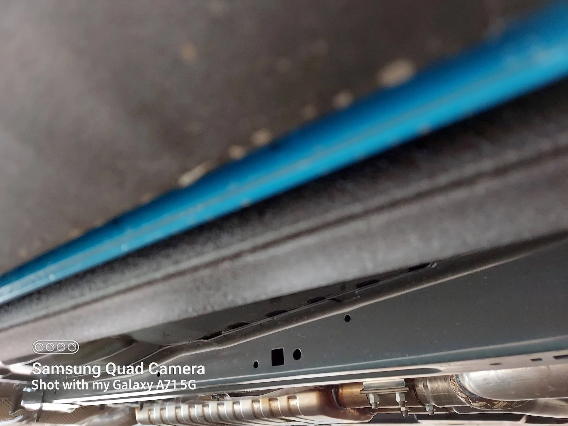

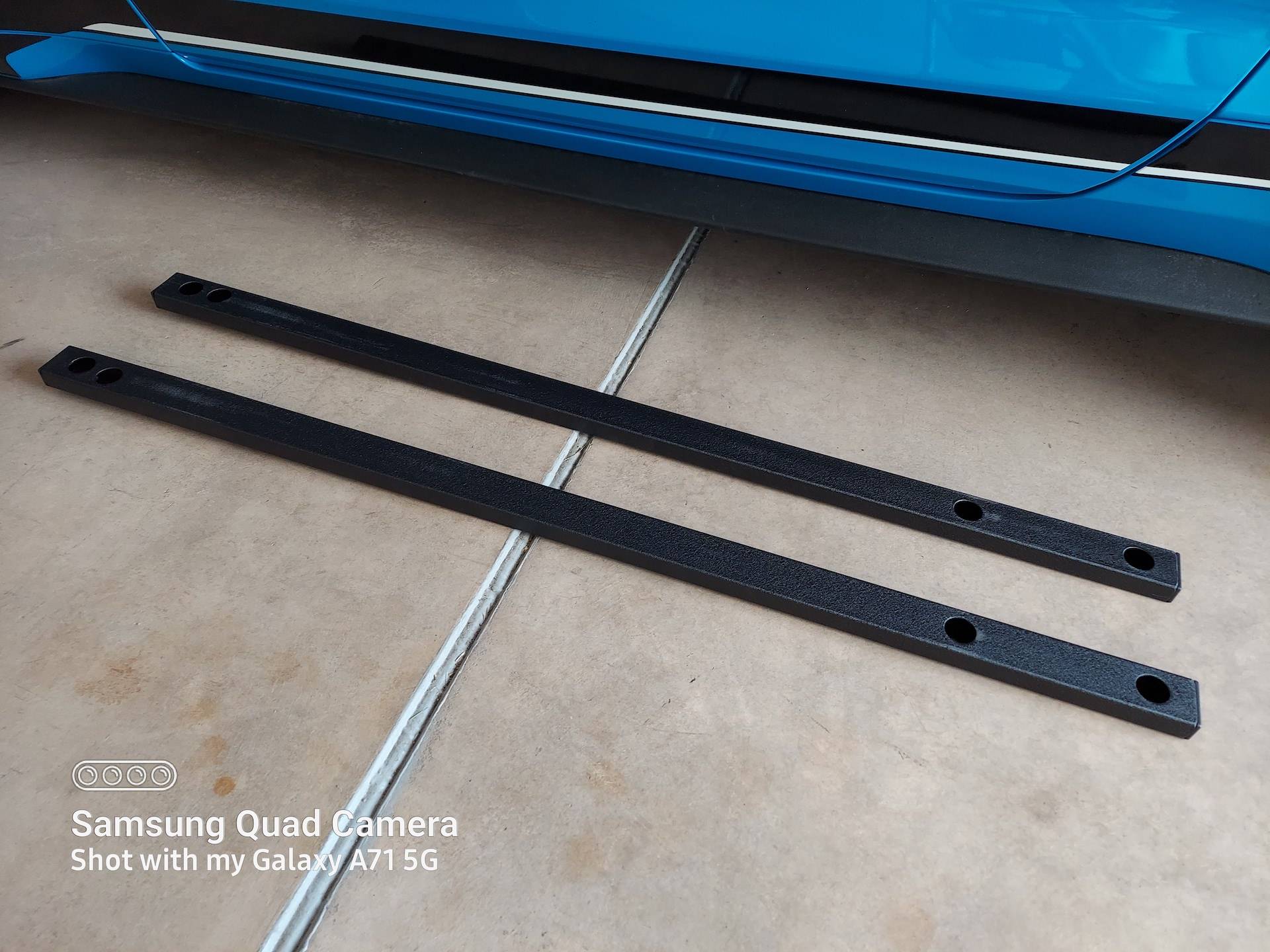

I bought a set from Steeda and they went in without issue. They should be different lengths. The bolt holes are different on each end as well.
Here's a pic...
Don't know what to tell you. Twice from different vendors with a like problem. Maybe they don't understand or realize the difference.
I'd return and try Steeda.
BTW, if you go the Steeda route and get a set, they come with bot hole covers. I didn't think they'd work; they kept falling out. Then I pressed in like Tupperware and they sucked themselves right in.
Total job time to remove the bolts and put the rails in is about 30 mins. From left to right, you'll notice the rocker aero molding, then the body seam, then the Steeda rail.

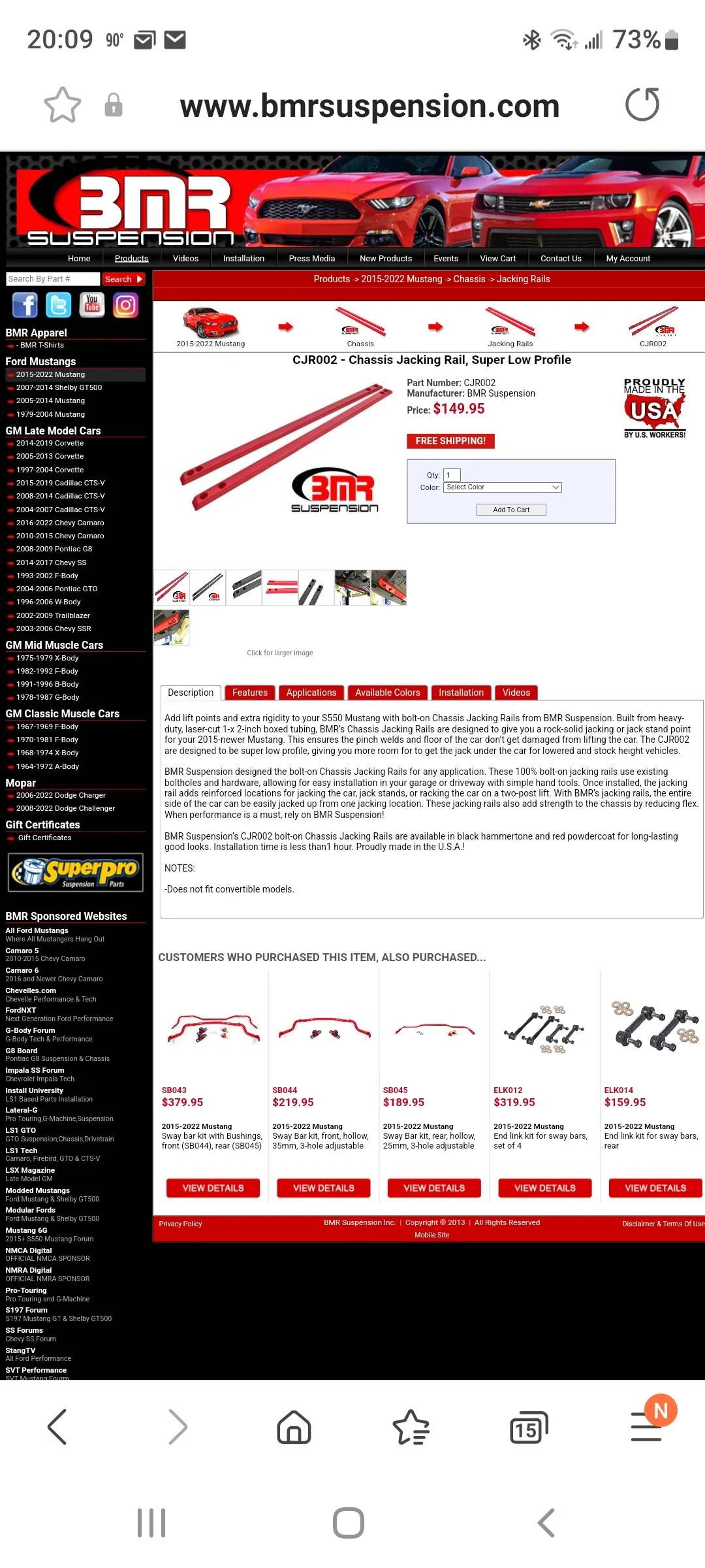

You could always return the ones you have and then buy them directly from BMR.
