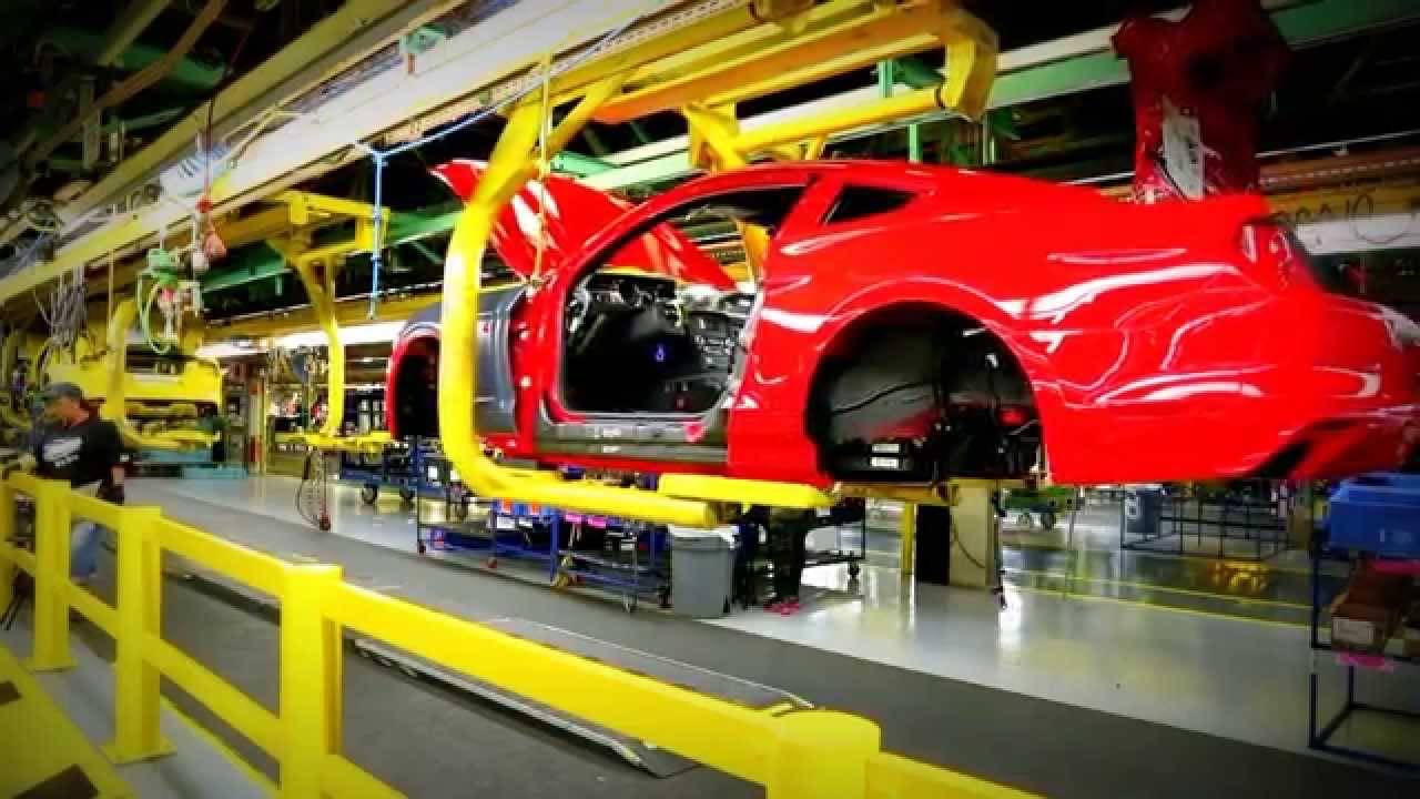

Thread resurrection! I bought some Steeda jacking rails and I have a question that seems unanswered by any videos or instructions I've found: What exactly are those bolts we're loosening to install the rails? In the videos and such, they don't look like they go to *anything*...
Why would Ford build a threaded hole with a big bolt that does nothing?
