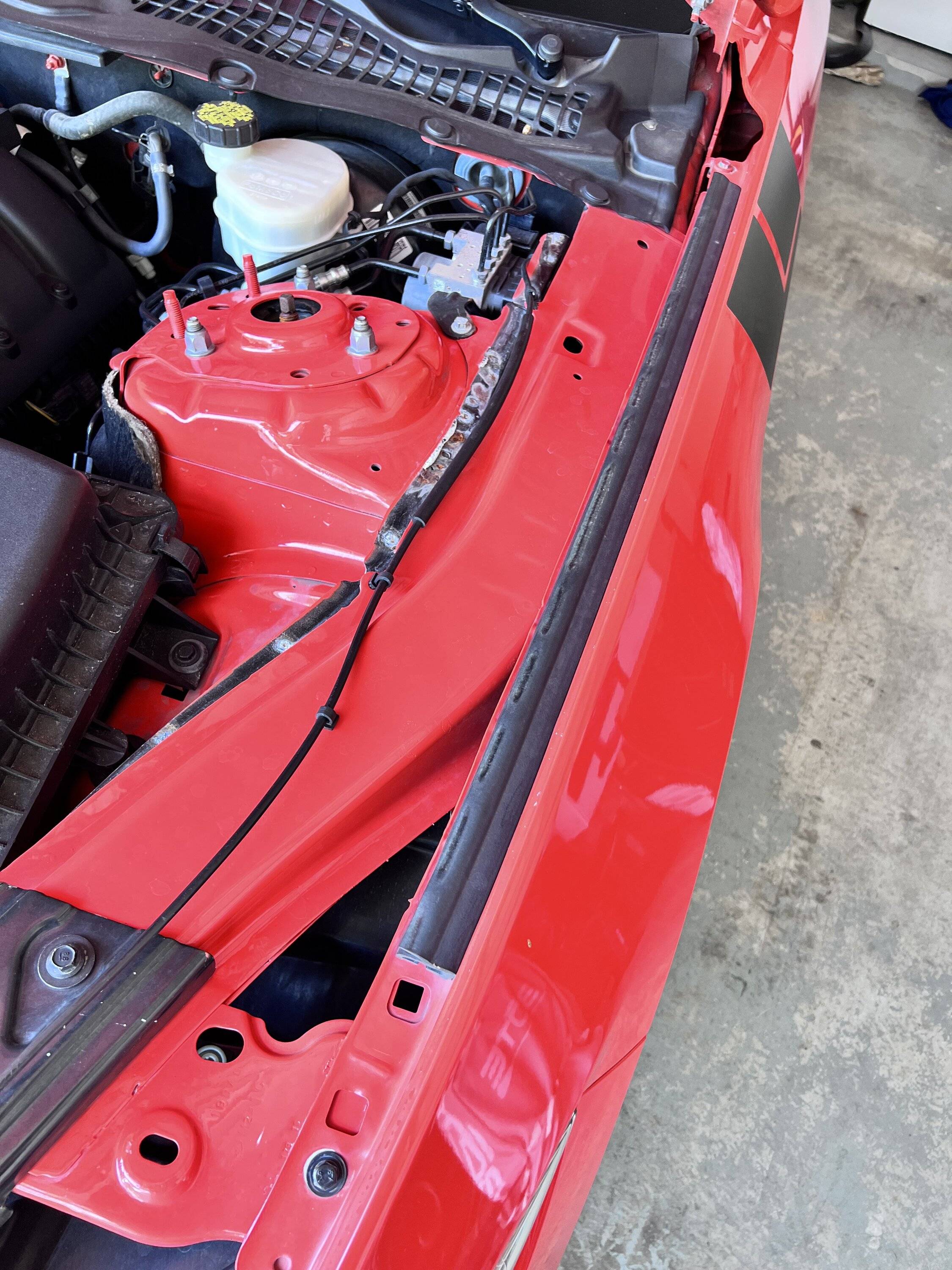

Recently I swerved and hit a curb going about 50mph to avoid being hit by what seemed to be a drunk driver. I thought the alignment was off so I took it into a shop.

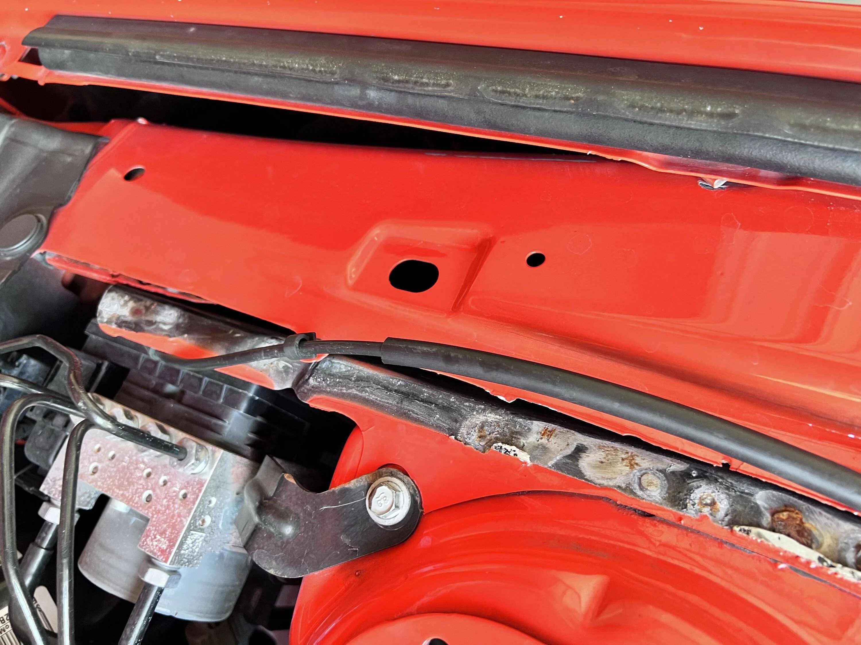

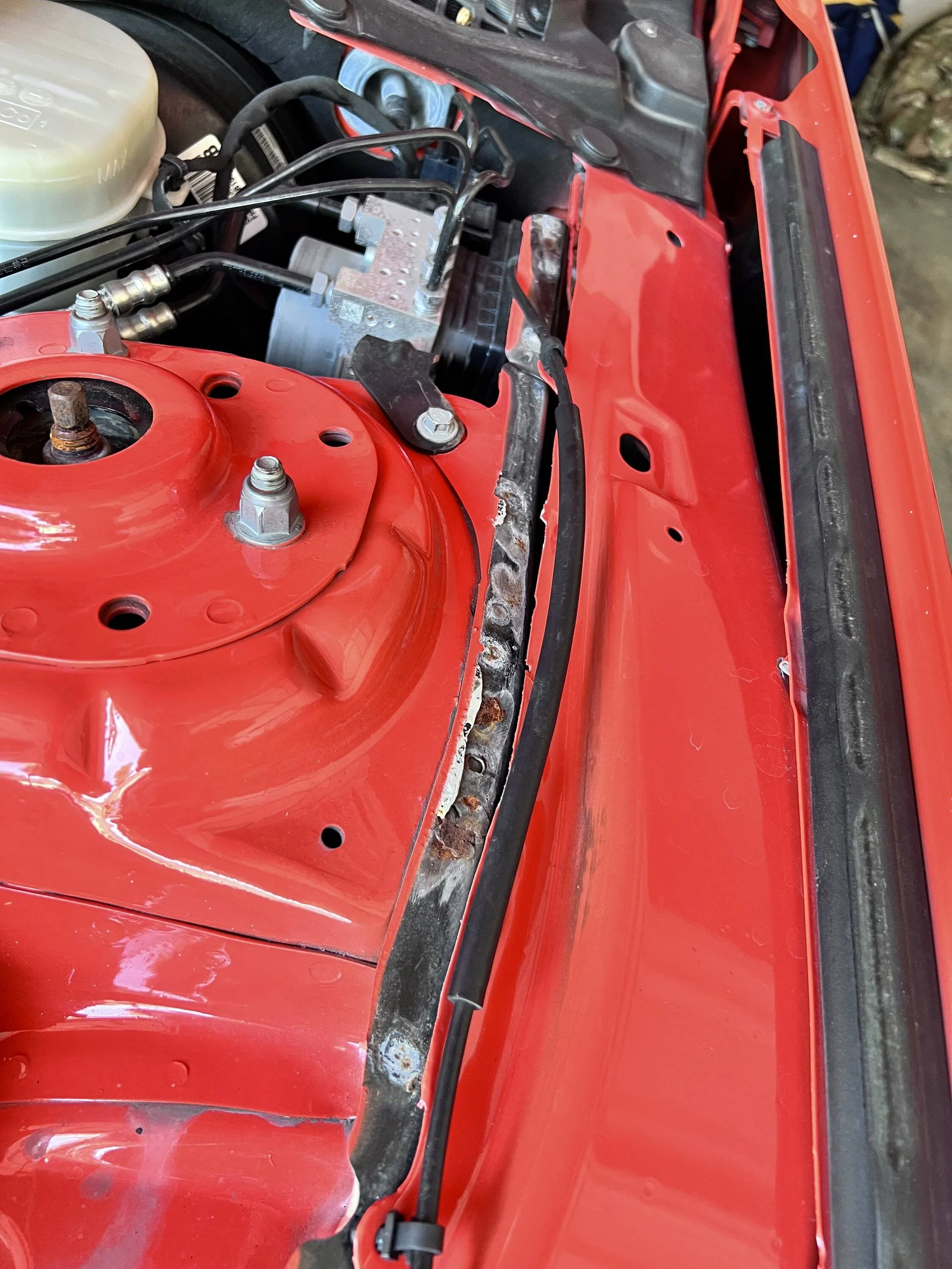

they said they couldn’t do it because the wheel was bent inward, the upper rail was split and there was extensive damage to the suspension.
-radial control arm and bushing is broken, needs a new strut, knuckle, and bearing. Not to mention what else they find.
car is a 2016 ecoboost with over 100,000 miles.
will it be totaled out? Insurance is coming to tow it on Monday.

I see some marks around one of the strut tower nuts on the driver side that looks like it rubbed the paint off. If that moved that much due to impact, that likely means other things moved and it could well be totaled.

The first picture shows the red threaded studs appear to be leaning in toward the engine and the upper rail seems to be bent down toward the tire. if this is the case you have more damage than you know. You really need a good frame shop to tell you the full story.

Thanks for the observation. I tend to agree with you. Car will be towed on Tuesday to a shop to see what they say.
Does anyone happen to know of the upper horn frame rail is one part with the main unibody or is it a total separate part with its own fomoco part number?

Actually the upper rail and box assembly can be purchased separately as repair sections and are welded together to make the complete rail. I would not go looking for fixes until you have a full and complete evaluation. Then you will know what direction to go or what decision to make. It doesn't take much to destroy a car after hitting a curb. Ask me how I know? Best of luck I hope it works out for you.

There are multiple pieces that make up the upper rail as well as the lower frame rail and inner sheet metal. I am currently making repairs to the driver side front frame rail on a 2021 Mustang GT that I bought salvage. The top rail in your pictures is a stand alone piece that can be purchased from Ford, I bought one for the passenger side for less than $200 on Ebay. I purchased a complete driver side front frame rail/strut tower that runs from the firewall all the way to the front bumper crash bar. I did that since it was less expensive and allows me to install the entire structure as a unit that will help to make sure that everything is aligned and as close to factory specs as I can get.
Just as an FYI my 2021 was a total loss by insurance. It's a Premium GT with 26K miles with no engine damage. Destroyed the front bumper cover, hood, both fenders, driver side frame rail, and front frame horn on passenger side. Obviously the radiator, condenser, and subframe etc. were destroyed. No windshield, roof, or suspension damage. So odds are they will total yours out.

If the wheel is bent in I'd think it means lower control arm damage. If that's the case then I'd expect to have sub frame damage. That may, or may not, be visible but will probably show up when replacing parts.
For the body/frame look up a YouTube channel called "23 garage". They are a group of guys in Chattanooga with a body shop. They have done a couple of Mustangs, one with pretty significant front end damage. They do a pretty good job of showing what's involved and how to properly make the repairs.

It took a tremendous amount of force to shear all those spot welds. I’m sure there is a lot of sheet metal deformation. If it’s totaled will depend on if components/body panels can be realigned.
