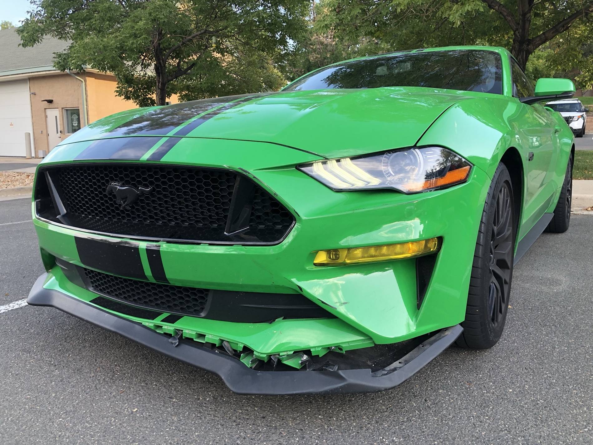

The damage is probably between $7-$10k may be higher or lower depending on if they have their own repair facility.
That's WAY WAY WAY more than 7k worth of damage.
THIS is 7600 worth:
THIS is 7600 worth:
Wow! My wife’s new Camry was hit on the passenger side, bumper cover, hood, fender, door, wheel and tire.....that only came to $5400 and had the car back in 4 days.
Happened on Sept. 26th (I think) - Still don't have my car back.
Talked to the shop today and they said tomorrow is the day.
I've got a thread detailing the damage and included copies of the final adjustment: https://www.mustang6g.com/forums/posts/2724689/

How the heck is that 7600 in damage? I can buy and have painted gt350 front end for under 1000 and I doubt a hood repaint is 6600 dollars. Or is there something IM missing here?
One headlight is $1300! The stripes was 700 lol that’s 2k!:crazy:

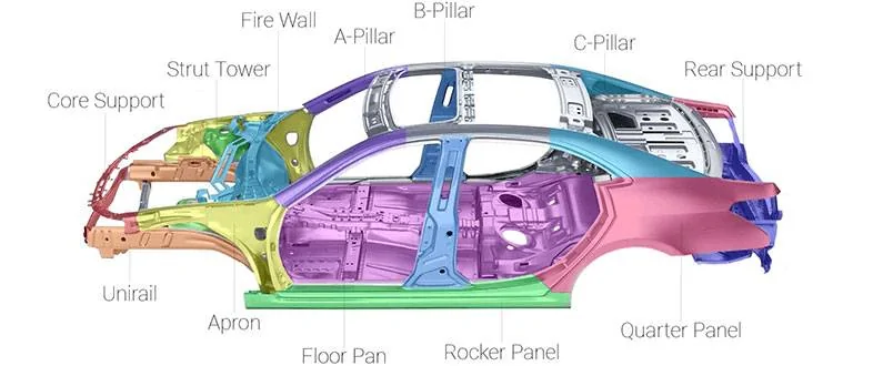

Does insurance take the dangers of handling the vehicle into account though? That’s my biggest concern... and is there firewall damage that you can see in the picture? People have mentioned that as an additional concern...I don’t know what a firewall is but from what I googled it’s hard for me to say there is any firewall damage...
The firewall is the metal that separates the engine from the interior of the car.
It's called a firewall, because it's literally there to, protect you in the event of a fire or engine explosion.
Pretty much everything on the mustang chassis is replaceable. The body is just a bunch of panels bonded together.
You can purchase a new firewall from ford and a bodyshop simply drills out the old seam welds then spotwelds the car back together...
Its just alot of work, and you need to have the car supported on some sort of jig so the body doesnt deform during the welding and cooling process.
But yeah anything can be fixed. The only question is how much.
Insurance companies dont care about safety, they just get a estimate from the body shop which they will low ball to pay out as little as they can, if the damage is more than the value if the car they total it.
The good news with that is insurance pays off ford. Then you can buy the crashed car off them for very little money. Then you can part it out, or rebuild it and get a salvaged title for it or make it a race car.
